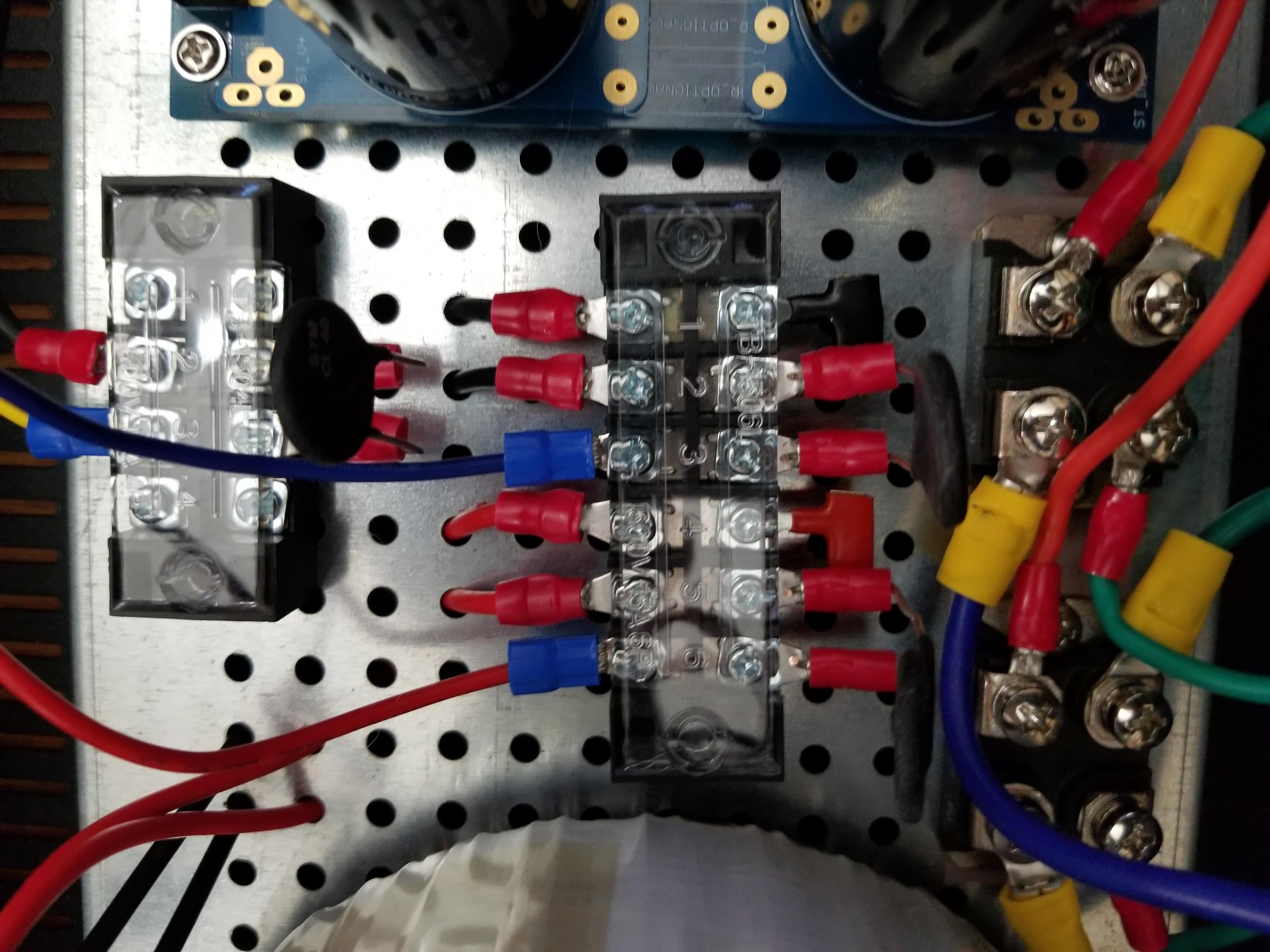

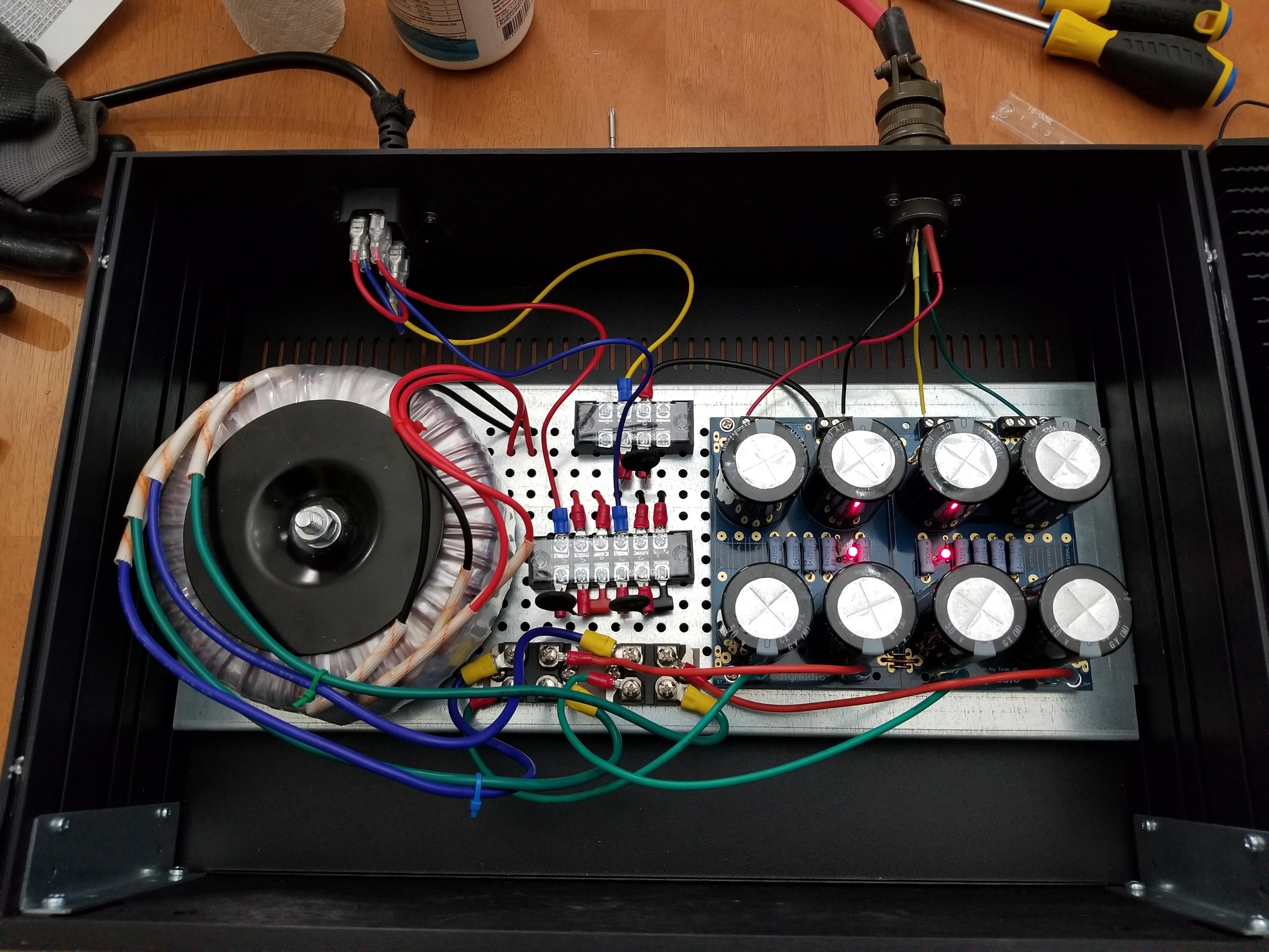

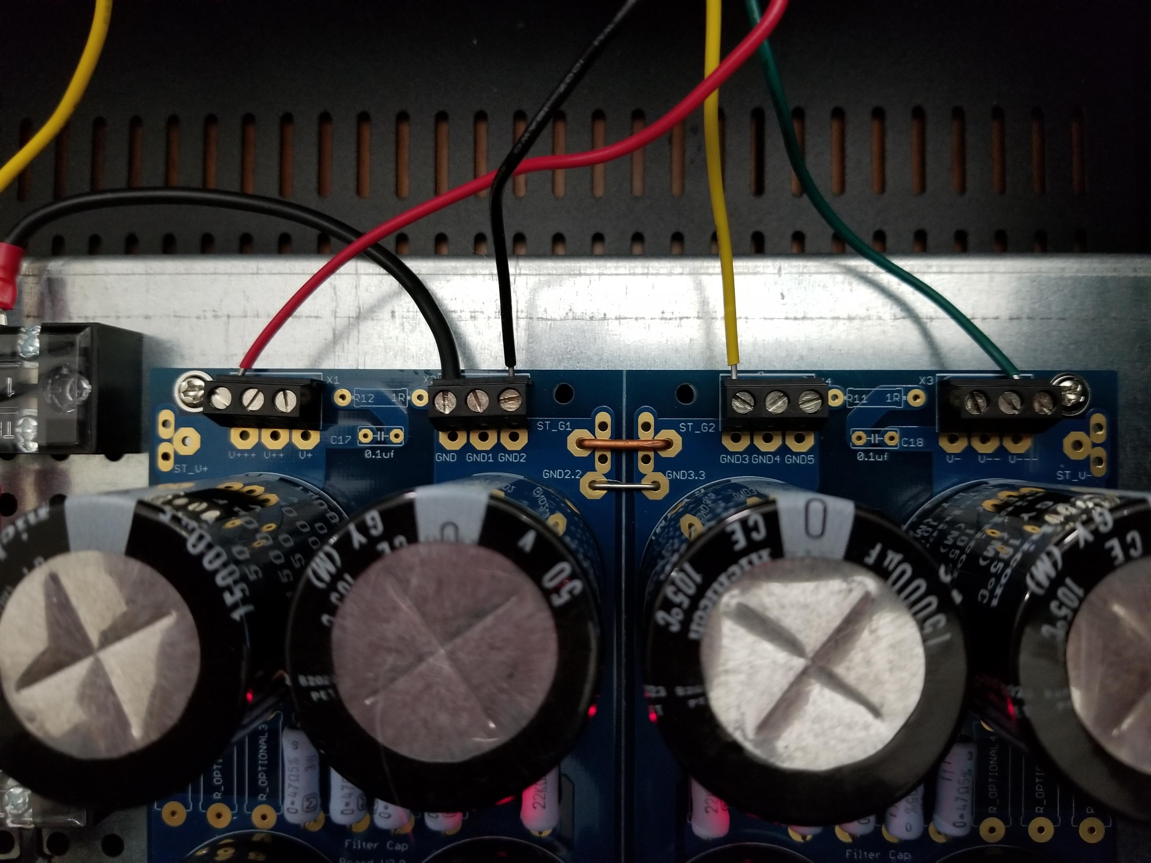

And here are photos of the PSU unit that has never been a problem (so far, at least).
Here's what I have fathomed about the grounds so far. The PSU PCB shares the ground from the power in to the board – that ties both the Vpos and Vneg grounds together (as recommended). The ground is then transferred to the amp chassis and fed to the Gnd.P on each board. This creates a common ground throughout the entire amp chassis and the checks done so far show a common ground between the mosfet screws to the heatsink, to the back panel ground speaker and RCA connectors, and to a few other checkpoints. Don't know what to check, specifically, and am trying the obvious.
The PSU chassis is not grounded – the active ground is from the PCB to the Power Switch Gnd and the Transformer and Rectifiers are isolated from the metal frame (carefully so). So the chassis of the PSU does not share any Gnd with the Amp chassis. The Amp chassis has an active Gnd created, somehow, by the Boards and, I presume, by their connection to the heatsink.
The voltage is dropping when (and only when) the boards are connected with no load. If this is a problem, then let me know, otherwise, I assume that it is normal.
Thanks, all. This has been a long process and is taxing my abilities. Your help is, therefore, very much appreciated.
