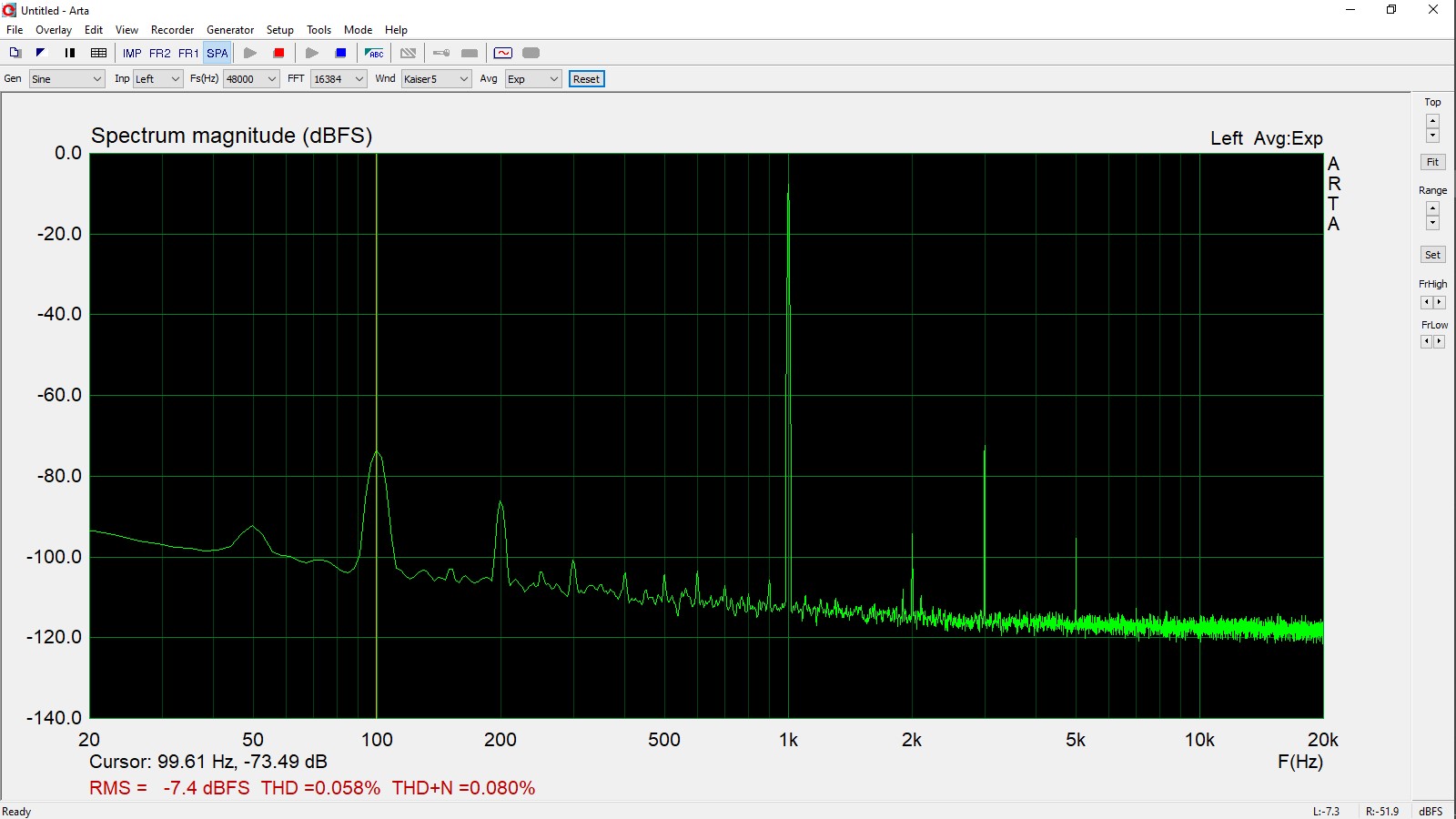

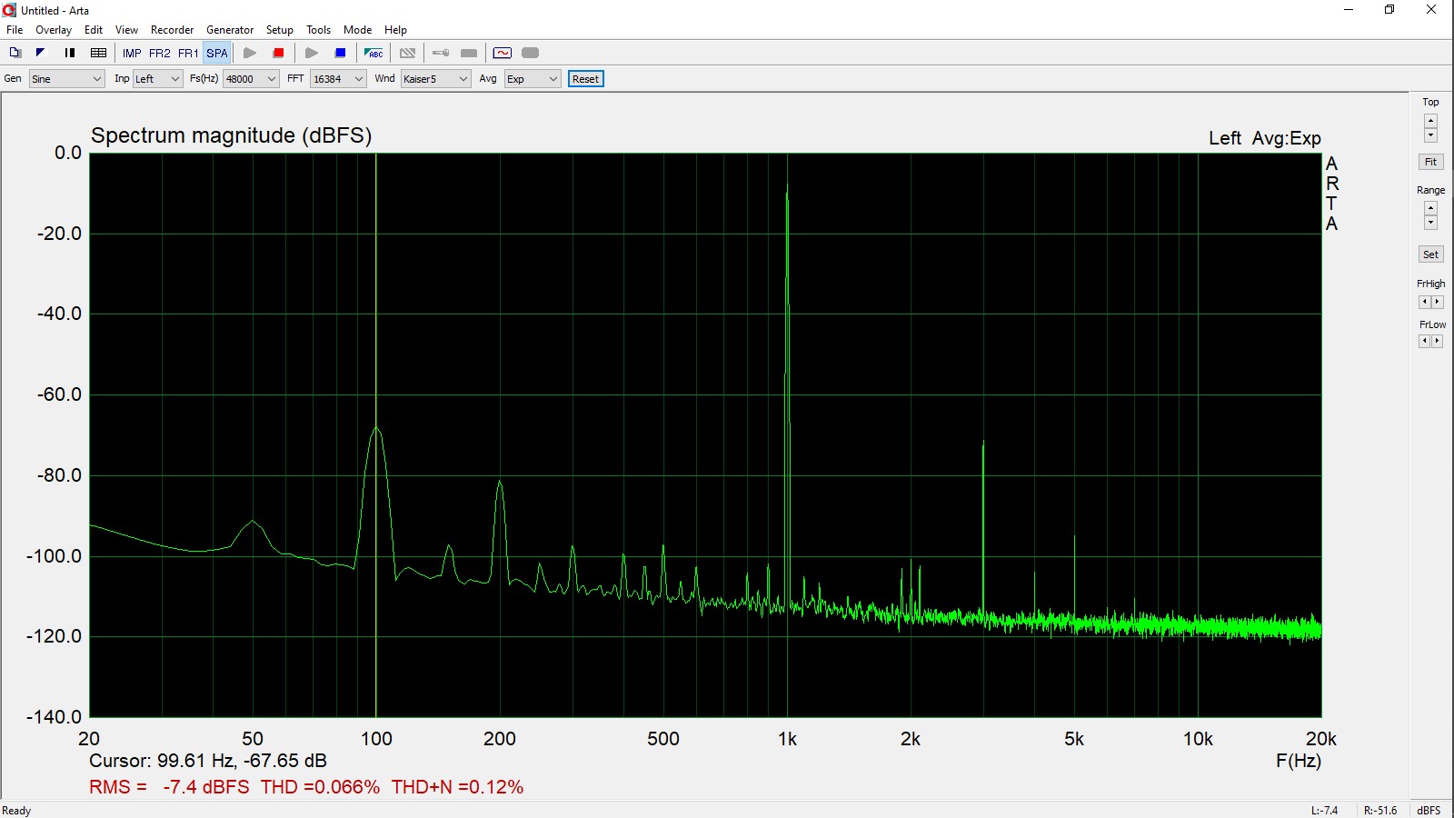

Thanks grataku🙂Are you measurements done with only one channel powered or with both?
I am not sure if I like shorting edcor transformer output and what that tells if anything.
What noise do you pickup with only one channel powered and its input shortened?

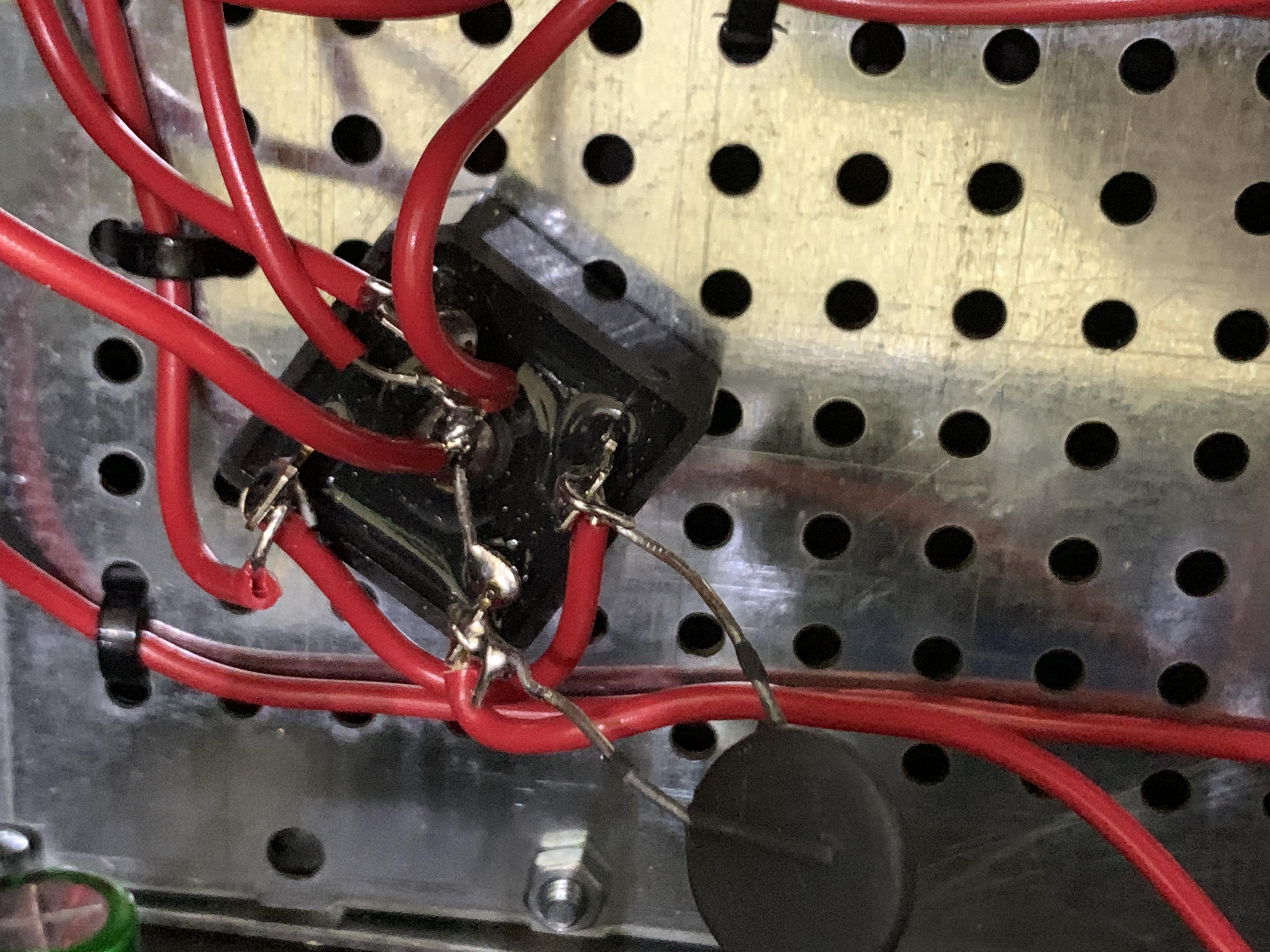

I am not familiar with your ps board...is it a dual mono setup PS board? I see you are coming out from two separate opposite points to go to each channel.
Yes, it's a CRC by Jeff Young (decoupled stereo) and yes, the measurement is when both channels are powered but the other channel has a short input. All in all, I haven't researched powering only one channel yet so it's already on my "to do" list
Yeah, it may not be as decoupled as you think. You may learn something when you fully isolate each channel.

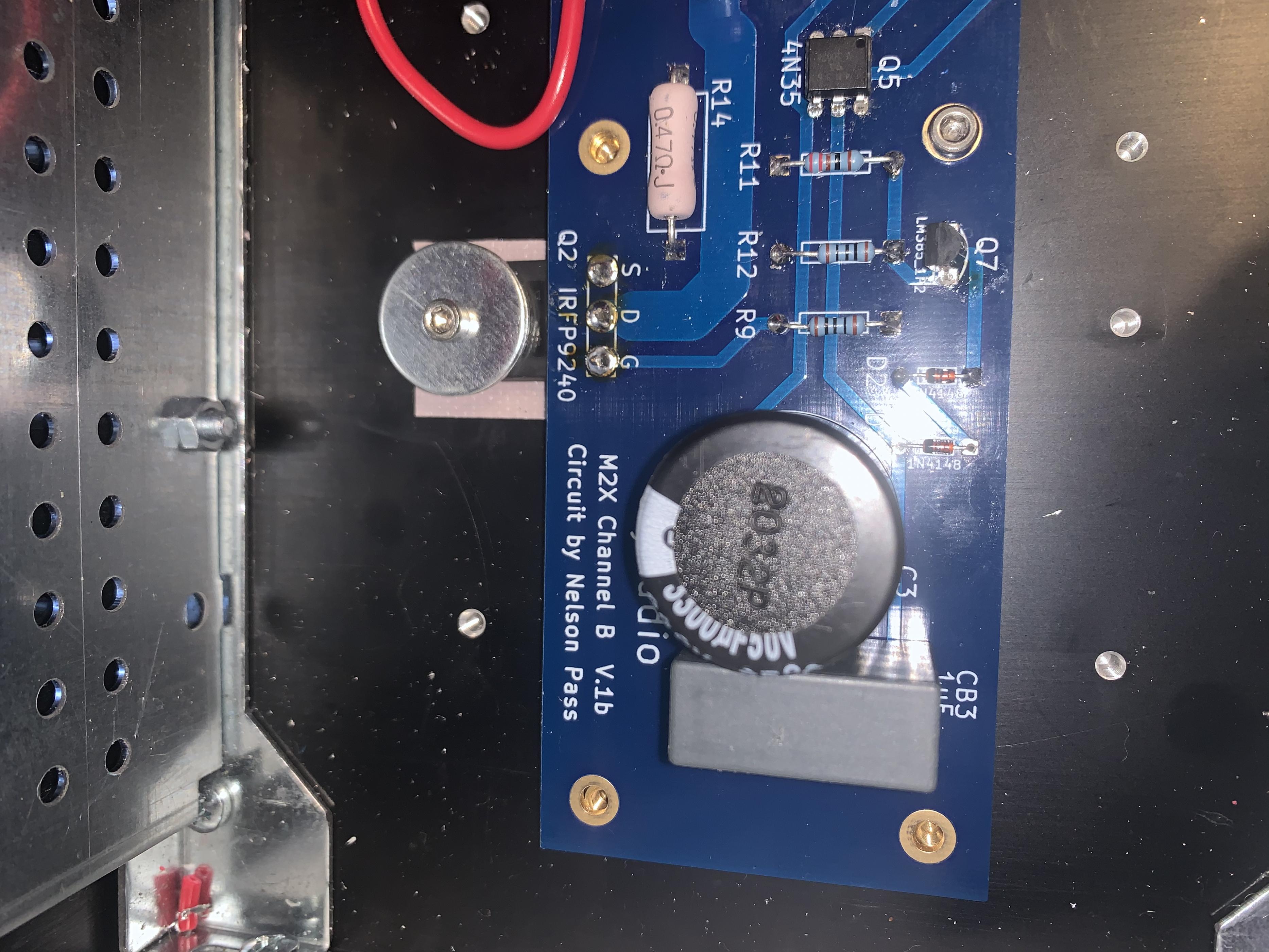

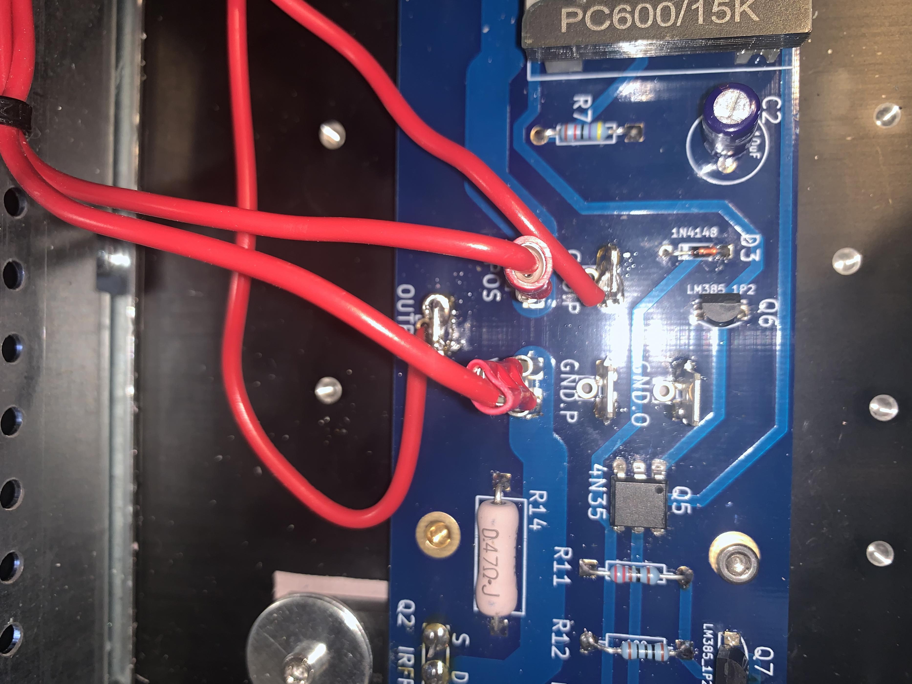

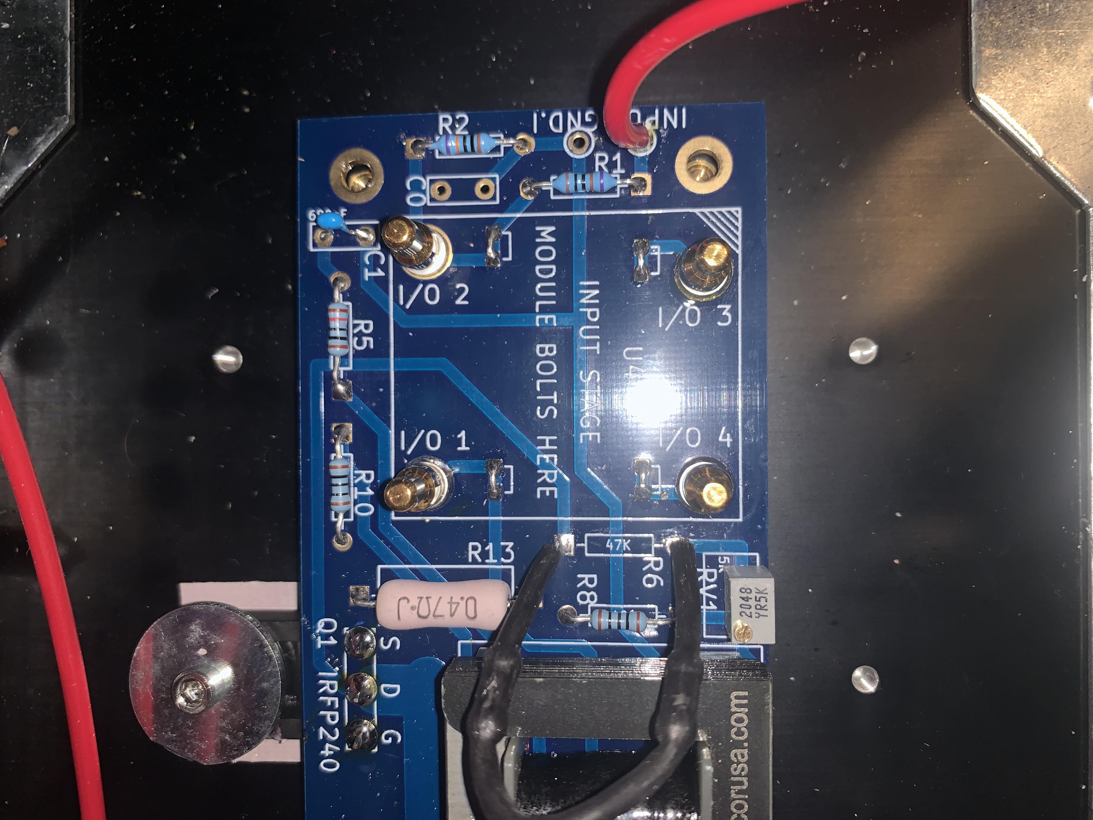

Ive got a head scratcher folks. I just finished an M2X build last weekend. PS checked out, connected the boards, and biased everything just fine. Went to connect to music. One channel sang beautifully with zero noise. The other channel hums (Sounds like 60hz) quite loud with no music at low attenuator setting. Only when attenuator is maxed do you get some light music. hum does not change with volume. Nothing changes when you short the input. I have swapped input boards with no change. I have checked input, pos and neg power connections, ground connections, everything is good. I have even retouched the iron to each board connection. i have changed out all the silicone components and C2. I did this one component at a time and checked for improvement, same result each time. The only thing that is left is the edcor transformer and the board itself unless anyone else has ideas.
Where's your input GND?
Input is connected directly to main circuit ground (bridge rectifier setup).
There is a small 100hz differential when I disconnect one channel completely

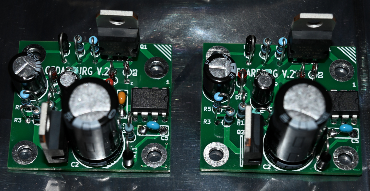

I can say that I am very pleased with Cedarburg (AD797).
It has less "white noise" than IPS6.
Room definition is very good and "silky" treble.
Good isolation of instruments.
I have now tried Tucson with OPA604, Norwood, IPS6 and now Cedarburg.
Which I prefer is difficult. Probably Norwood or Cedarburg.
If IPS6 was as silent as the other three boards.....IPS6 could be the winner.
Cedarburg is my first input board without an output cap!
I dared to put it in action!

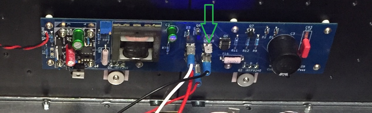

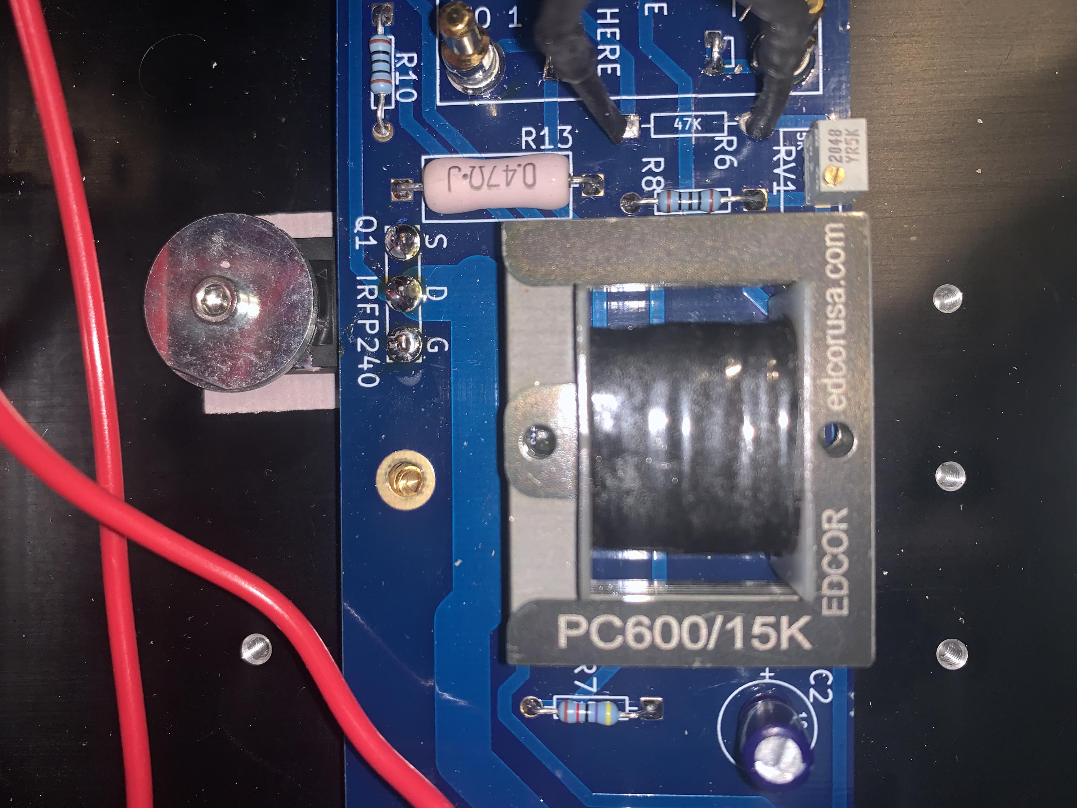

One of the many features in this design that I'm grateful for is the inclusion of the spade connectors on the PCB. I had to change RV1 and R6 and these connectors made that task so much more pleasant. Many thanks again to whomever came up with that idea.
Dan 🙂
Dan 🙂
6L6 and I jointly came up with that. He dreamed up the three-hole footprint idea, to support builders who despise all possible connectors and only trust soldered wire connections. I came up with the brilliant observation "fingers are fat so we had better leave at least 1 cm of empty space around each male blade." Fortunately Nelson's M2 is a minimalist design, and its small number of components on the board can be spread apart generously.
If you look at my builds you’ll see frequent use of terminal blocks, terminal strips, and crimp on connectors. It adds to the cost but makes removing parts for troubleshooting or repairs so much easier. That’s why your spade connectors made me smile. 😀
Dan
Dan
Are you shorting the input(s)? I don't know what would cause the imbalance...are the two channel drawing the same current? Can you repeat the experiment by powering each channel using the same side of the PS to see if the 100Hz comes from the PS or if it is intrinsic to the amp board?
Except for the trimmer that needed to be placed as close as possible to the edcor. 😉
