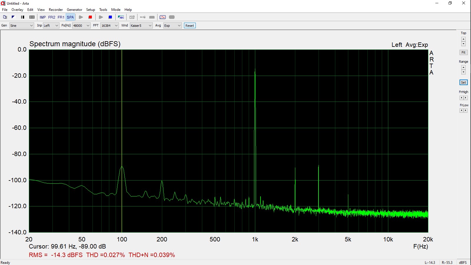

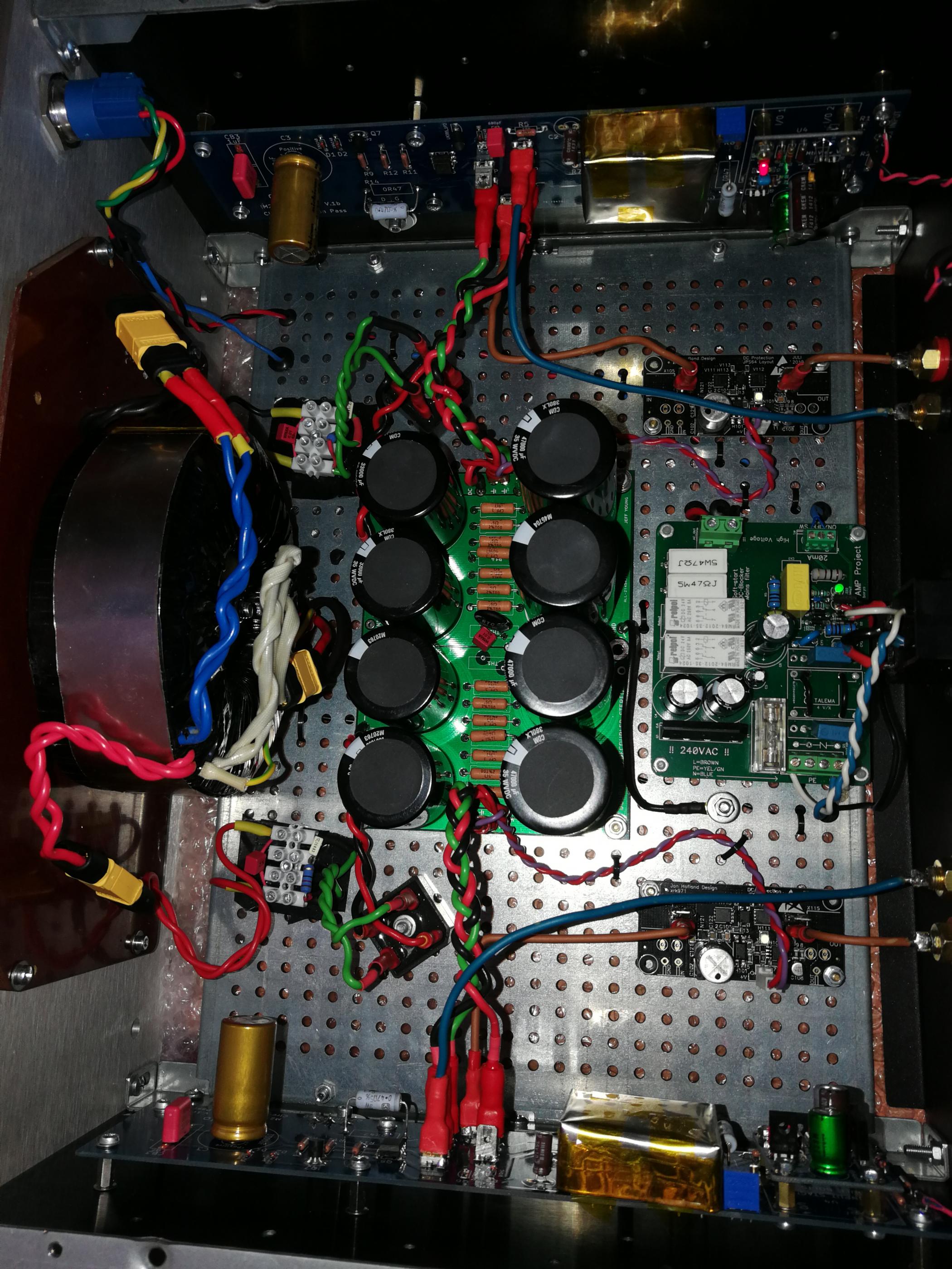

I did the power side swap a long time ago and it didn't matter to the ripple noise .paralleling 0.5x3 you get 0.17 ohms
I=V/R =0.225/0.17=1.32A which is what it should be the right current for each channel.
So powering one channel at a time and using the same PS side has no effect on the noise?

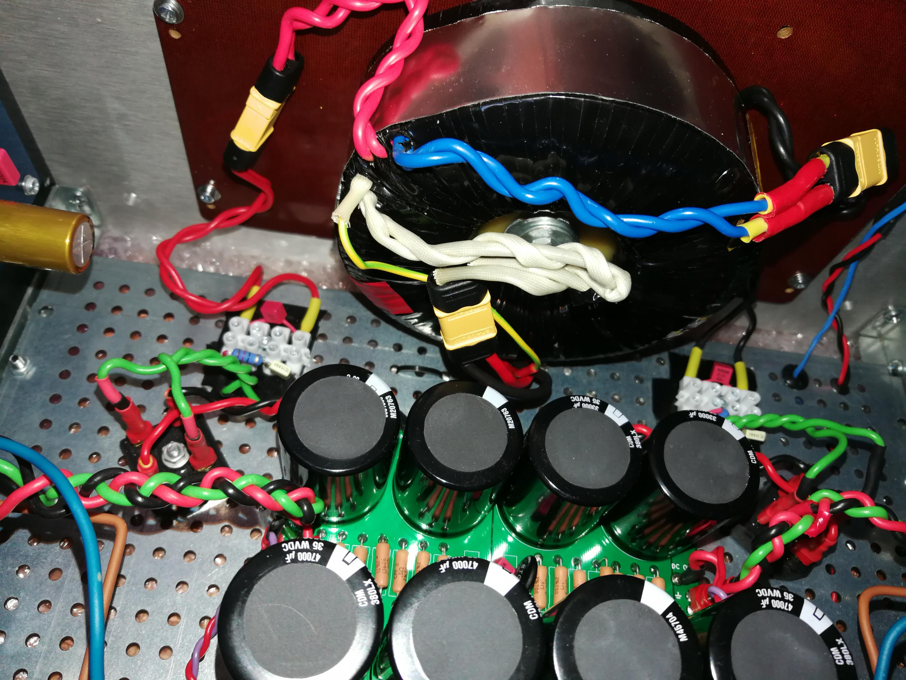

I rearranged all AC and transformer connections. I got rid of the cover on the power transformer (it did not work for me). I made a band on the toroid from the mumetel sheet that was left to me. Ripples of 100hz can be heard on the headphones and speakers .On the left channel it is quieter. The ARTA measurement and the smartphone application confirm this: the difference is about 3dB. I have no idea what to do with it so I have to ignore it.
Photos are ARTA for 1W / 8R dummy load.
Regards
Darek

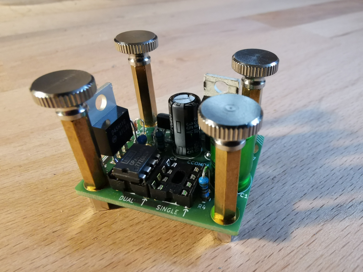

Did my first M2x swap today. I went from the OPA134 on the IPS7 board to the Cedarburg. It took about ten minutes. Nice work on both boards there Mark. I believe I like the Cedarburg more right now but I'm still in the honeymoon stage till I listen to more tracks.
Maybe a 1612A test soon.
Dan
