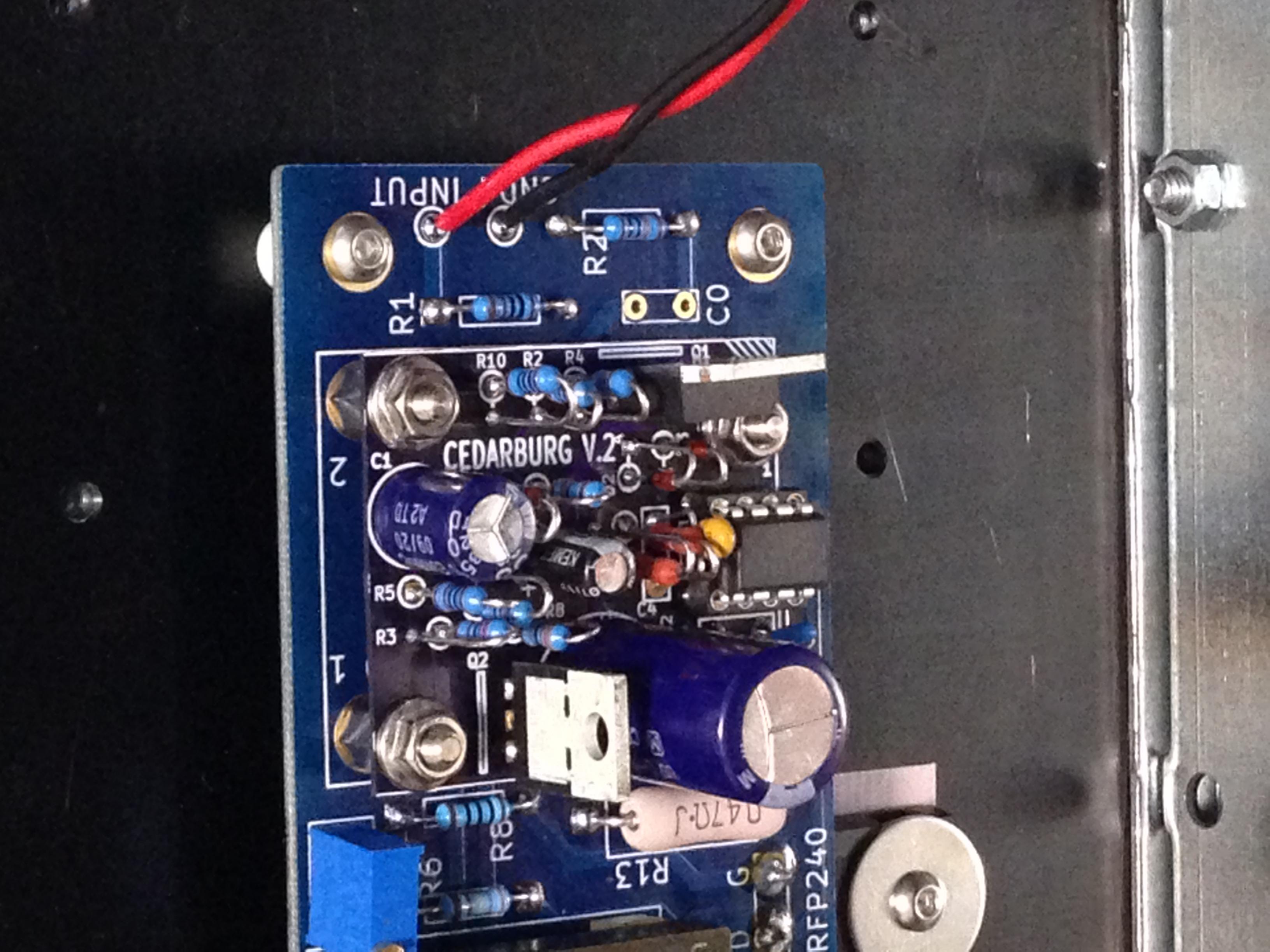

Cedarburg:
I am one 6.8k resistor away from completing it! Unfortunately, that got dropped from the BOM during the order process with Mouser. Now that the Vfet can be in service I can tend to my beloved M2x and make a few needed mods. The M2xx with the XRK971 Buttah' board is as quiet in my system as the VFET. I can't tell the difference, in quietness that is.

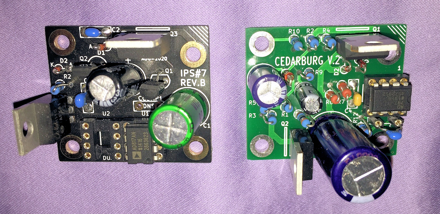

A suggestion for a new, community-designed, M2x Input Stage
I've noticed that two of the IPS cards seem to elicit much fiercer loyalty and more passionate devotion, than all the others: IPS7 and Cedarburg.
If this is generally true, why not consider cross-breeding them? Take the most dominant thoroughbred filly of all time (Zenyatta) and mate her with the most dominant stallion of all time (Secretariat). The offspring might be unbeatable.

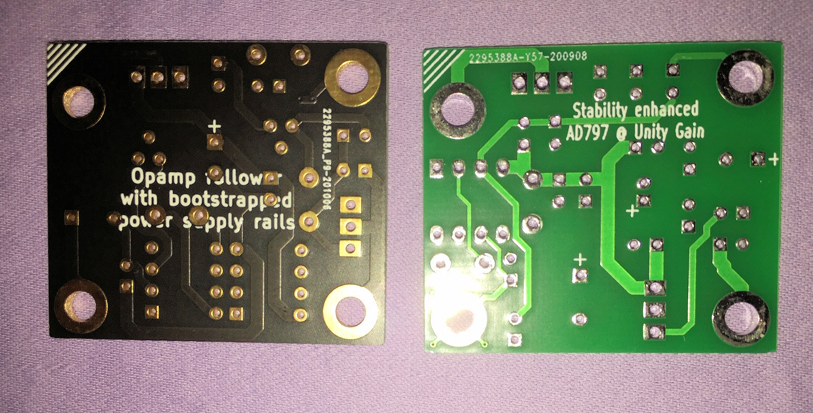

A look at the boards themselves suggests an idea.
  • Opamp follower (unity gain stage) with bootstrapped power supply rails
  • Stability enhanced AD797 @ Unity Gain
>> Why not try a [stability enhanced AD797] follower, with bootstrapped power supply rails? <<
Viktor Fronkinschteen reacts to this idea: Youtube clip 17 seconds long
Perhaps M2x builders would enjoy developing an IPS card along these lines, and then subjecting it to critical listening evaluation. It definitely would be a lot of fun, and the result might, just might, be an unstoppable colossus.
You might be wondering, why didn't I include this among my portfolio of free IPS designs, given away in this thread? I left that one out so that you gentlemen and ladies would have something to put in.
And of course, the designer(s) get to name the new IPS board. Montevideo? Riga? Vilnius? Zagreb? Anything you want.
Please enjoy!
(click on the images to see them full size and undistorted)

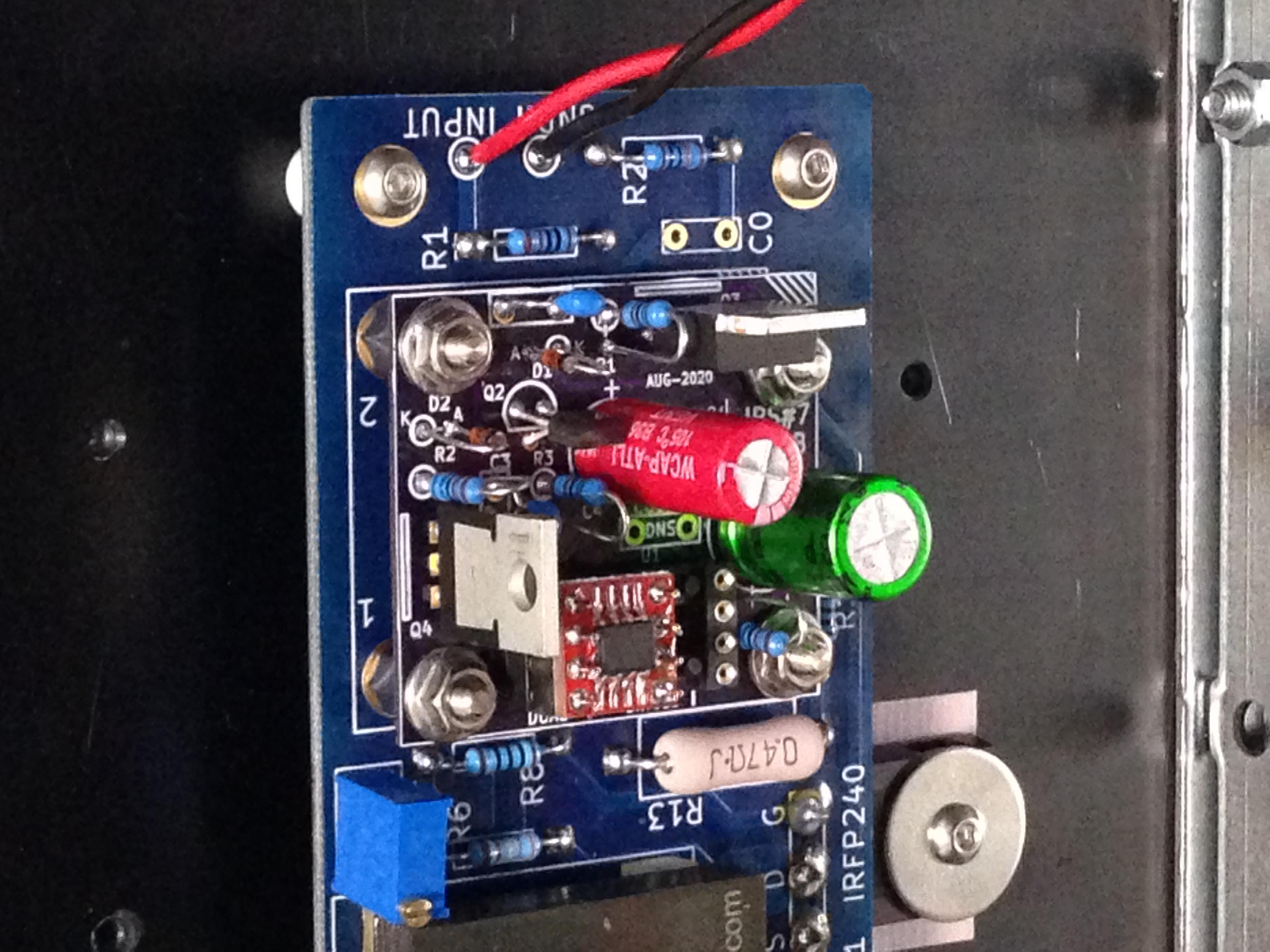

Brief first impressions. The 1612A has a little more midrange depth and treble is a little clearer. The AD797 excels with better bass.
This test was done with my Martin Logans. In the next few days I'm going to hook up my line arrays with their ribbon tweeters and offer another review.
Dan :)
Another "major" difference is that Cedarburg has DC-coupled opamp and IPS7 has the usual 220uF green cap to block DC to Edcor.
Right!
-What makes the cedar able to go dc coupled? Is it the 797 itself?
-how the rail modulated by the input signal affect the complex AD797 PS tuning? I would assume the whole RC network would be needed on the franken ips7-ad797 but what if alterations may be necessary?
The other way around seems more straight forward. Most opamps would do fine in the cedarburg, maybe. Would the output cap become necessary?
