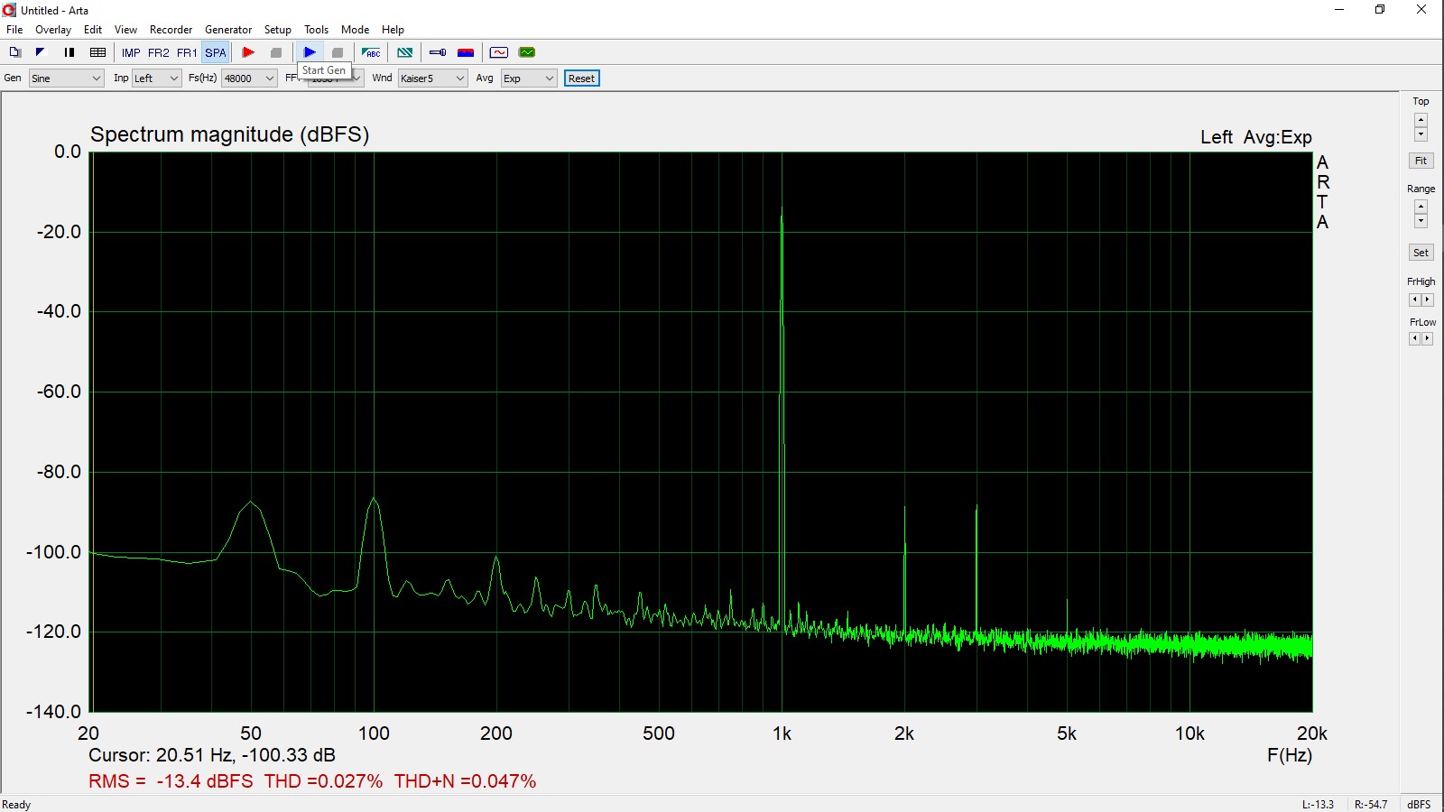

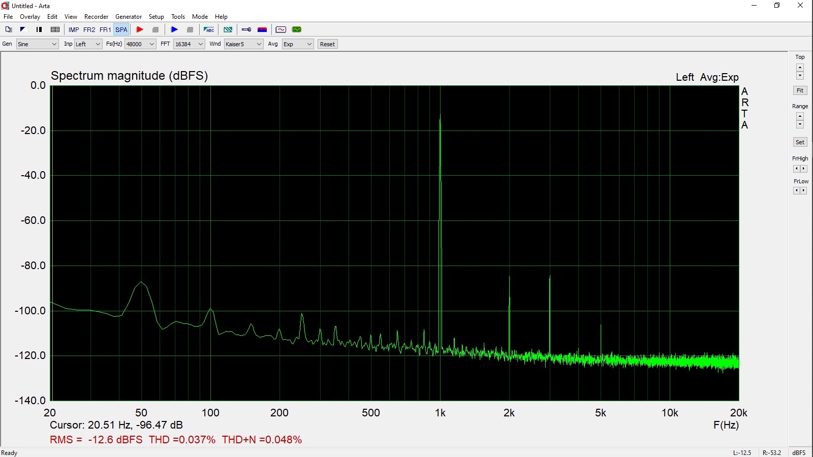

I checked the amplifier using the spectrum analyzer of the ARTA program.
This is the ripple for Ishikawa and Mountain View 1W for the 8R load.
I measured it with my notebook's sound card.
As I wrote earlier, the MV noise is audible in the loudspeaker only close up.

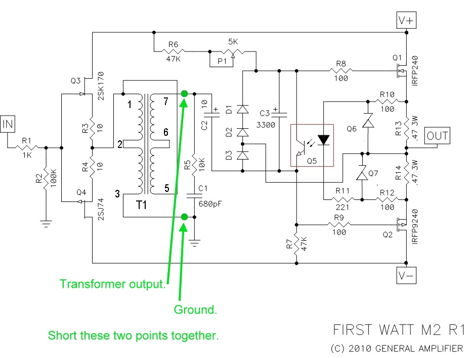

In the M2 thread I found advice to connect Edcor's output to ground. If the noise subsides, it is a sign that the noise is generated there.It worked for me. It's quiet when I connect the output to ground
This is to prove there is a problem with magnetic radiation of the power transformer?
Please confirm that the next step is to disassemble the toroid and check the noise?
Anyway, what else can I check?
regards Darek

The diagram in post #5023.....if those wires are connected together the amp is probably very silent but then it will not play any music? .....you shorted the output signal of Edcor.
The noise you hear is "humming" (it is the only significant noise on Arta measurements)?

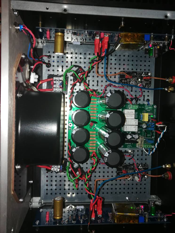

I have an edcore with mumetal box and a transformer with a metal cover. I increased the capacitors in the PSU. I have a soft start with a DC blocker
I didn't use ferrites or move the toroid. (It's gonna be a big rebuild and I'm only now ready for it). IMG_20210325_203758.jpg
Ok.....I assume it was by purpose to short output of Edcor to check if noise was generated in output stage or before output stage.
As you have some 50 Hz noise on Arta measurement it is very possible that it is pickup byt Edcor from mains transformer as the "magnetic noise" will be 50 Hz.
Yes. I shorted edcors output to ground. Then the noise disappears. If I understand correctly, this means that this is a problem with toroid noise. I read about it in thread M2 and there was this diagram.

To check if the 50 Hz is from toroid transformer a good test could be to move it out of the chassis.

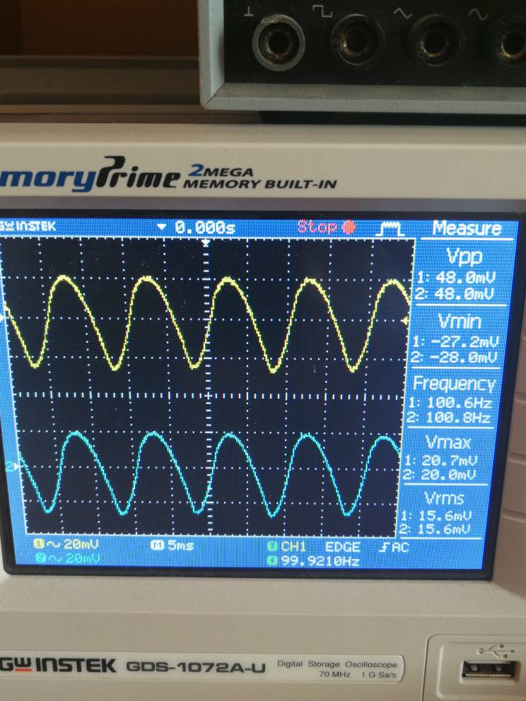

To get less 100 Hz noise with Mountain view you probably need a better filtering. To increase the caps may not be the solution. A better solution may be to increase the R in the CRC filter. Is your R about 0.1 ohm?
A good audio SMPS could maybe also be a solution.
The 2nd Arta graph is probably Mountain view as you have more 100 Hz noise. Mountain view is single ended as far as I remember and is probably not as good to supres ripple as Ishikawa.
Ok. I know this is the case with MV, but no one has reported such problems here. My power supply now gives 50mVpp of ripple noise(with load).I have 0, 17 R (3x0,5R paralel) This is definitely less than a universal power supply from diyaudiostore New%20PS%20pos.jpg
