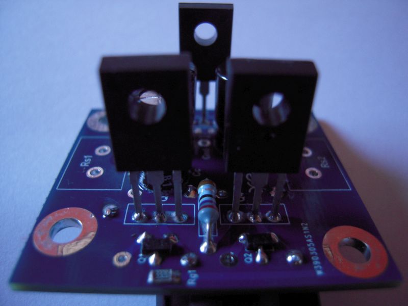

Hello M2X-builders,
this is my selfbuilt testrig for the M2X-bufferboards. Built on protoboard.
Together with a symmetrical regulated PSU (adjustable voltage).
Greets
Dirk

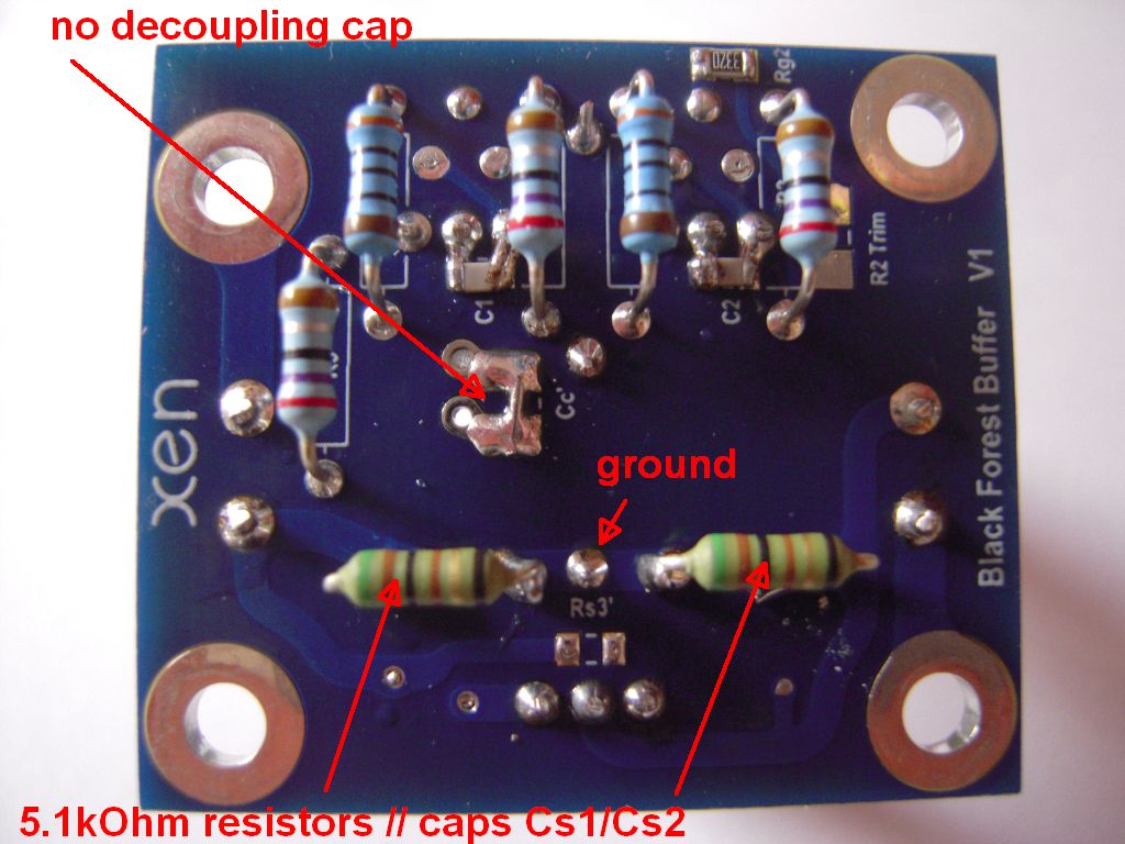

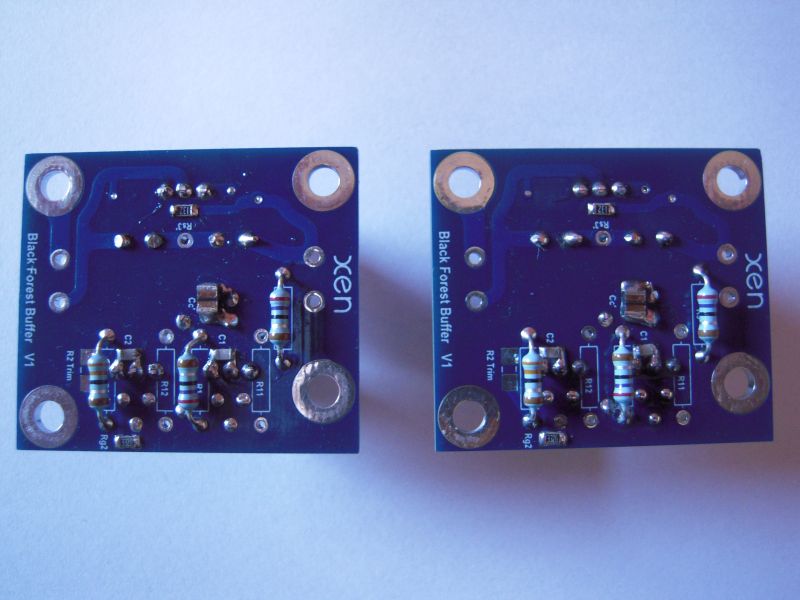

Seems my two Cedarburg boards are up and running and next step is to put them into the amp. My first input board without the 220uF coupling/DC-blocker cap.....

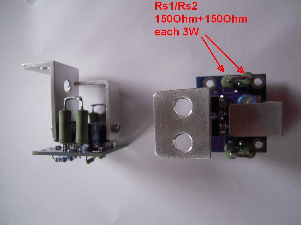

Hello Ake,
I didn't try without heatsinks.
The two TOSHIBA TTA004B run at ca. 35° - 40° C.
The regulator TTA004B (Qs1) is running at around 25°-32° C. Not strictly necessary to use a heatsink there. But try.
You don't need that big heatsinks as I did. And I have higher railvoltages in my M2X (+-25.5 V)
Cheers
Dirk
