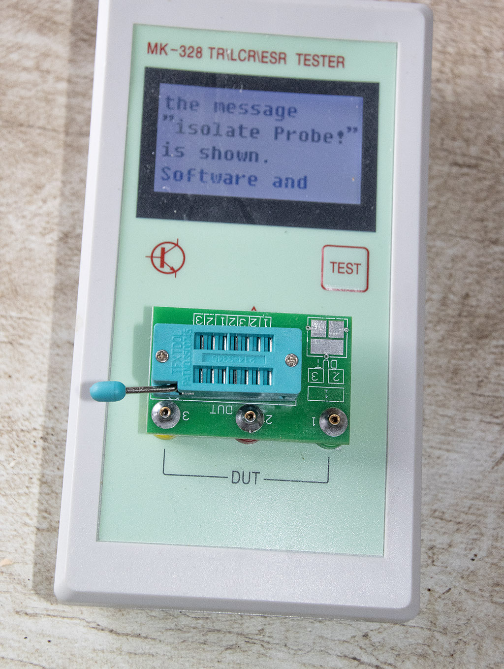

I got this tester:Since this is now all working, here are the Gerber files as promised.
This version is slightly revised to give more space between components for soldering.
Circuit remains unchanged.
Happy soldering,
Patrick
Can it be used to match the 2SK209GR?

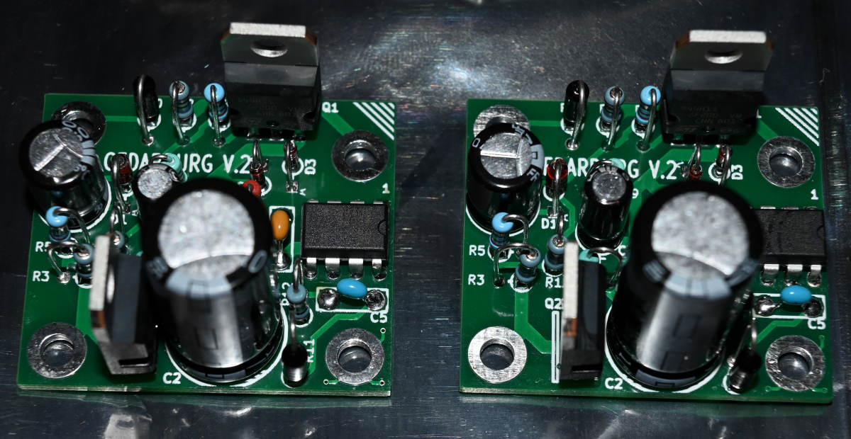

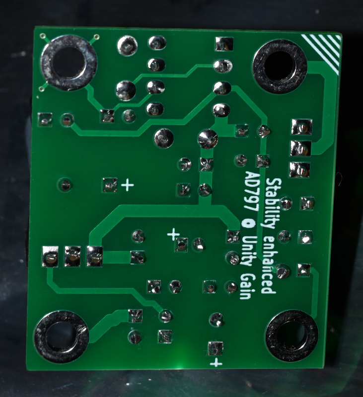

I now have a set of Cedarburg AD797 boards ready for testing. Boards are also cleaned for flux 🙂
What I wondered after the build is that this input board has no coupling cap at the output like Norwood, Tucson, IPS7 and other boards has.
Is the simple reason for this that there was no space on the board for the non-polar 220uF cap? ......so we need to be "fearless" and just hope Edcor survives? 🙂

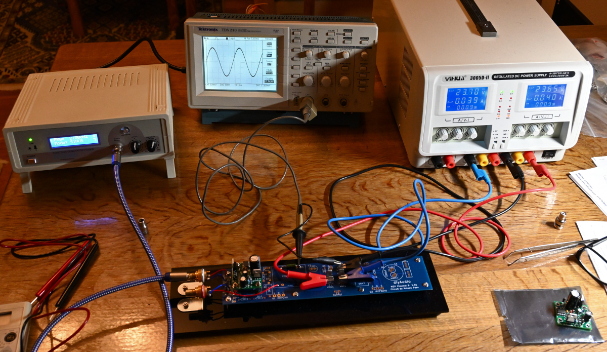

That looks like a sweet testing setup! Don’t know how it works exactly, but certainly looks really pro! 🙂
Dirk,
Thank you!
