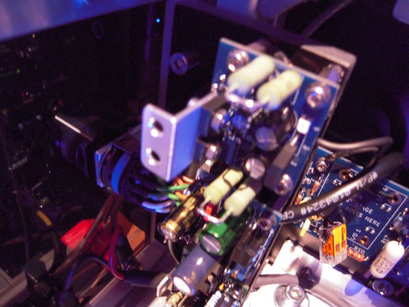

Finally made this upgrade...systemic issues with loosening bolts over time...I do tend to board swap however. Also possible I didn't follow 6L6 washer formula to the letter 😀😀😀.
Worthwhile upgrade—I sleep better at night now.... in spite of the fact that I could make Cedarburg permanent and be totally happy.

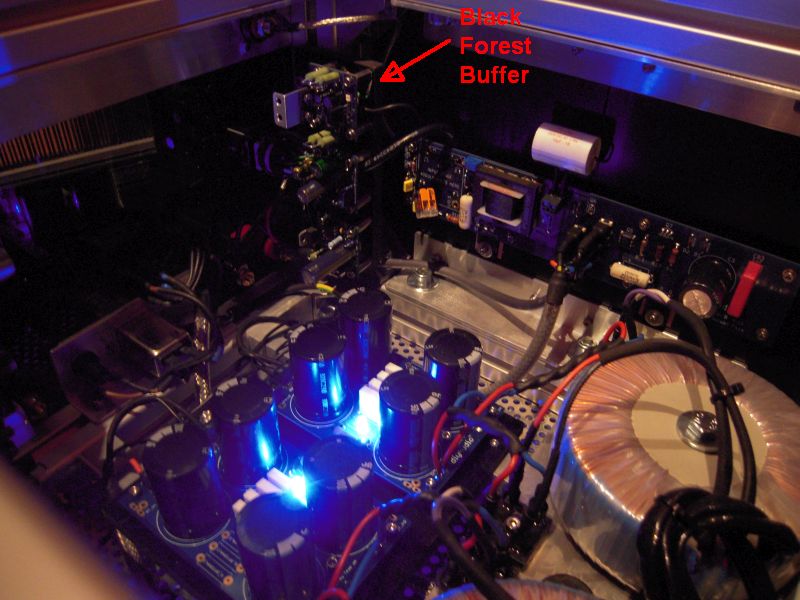

I have no problem with input boards that loosen over time. I use a "split washer" ......think the name is.....to apply pressure on a shim.
The "standoffs" I use to mount the input boards are female-female so I just use normal 3mm screws (no nuts 🙂 ) .....it also looks nicer 🙂
I had one complete M3 bolt, split washer under head, up from bottom of main board, +toothed lock washer, +fully threaded aluminum standoff, +another toothed washer, +daughter board, +toothed washer, +nut. For anyone interested... loosened over time at the connection to the main board—so, between standoff threads and toothed washer and main board and split washer, not the daughter boards, they stayed tight...Quite impossible to get a tool in between main board and heatsink... Dunno.... YMMV. Meper's solution sounds like it decouples the main board attachment arrangement from the daughter boards—I like this move. It's possible swapping boards plus heat cycles and a single threaded bolt for everything made the main board connection funky over time...

I use only flat washers and split washers to make the contact pressure.
Maybe if the star washer over time dive into the aluminium?
I did not want to make marks in my PCB's. That is my reason for not using star-washers 🙂 ....it seems the contact pressure applied by only split-washers on flat washers are ok. Sound is fantastic.....

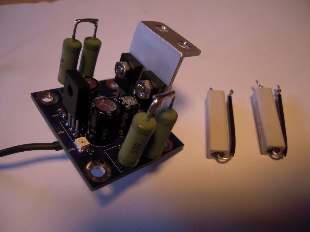

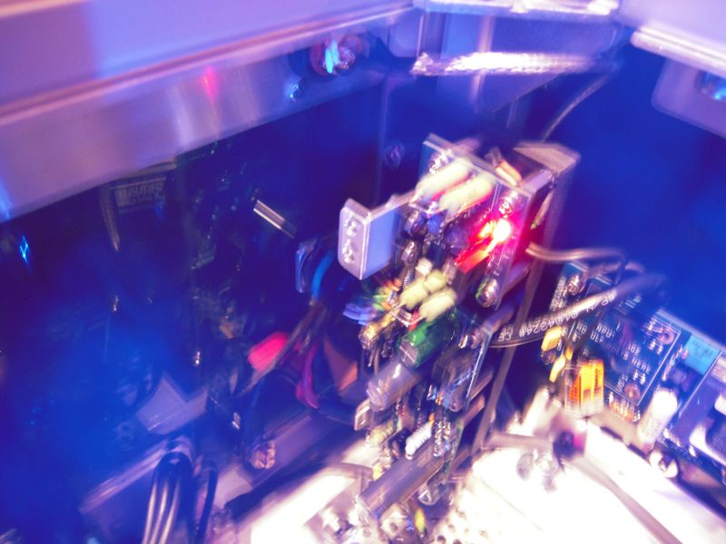

I have exchanged the 330Ohm/5W resistors on the rails to 270 Ohm+33 Ohm (in series = 303 Ohm). Both boards are running. Was this the issue? 😕
The BFB-boards are playing music. 😀

So how do you like the results ?

It sounds very detailed and 'fresh'. I have to add, that my M2X is running in my active system and it is 'only' driving the Mid/Tweeters.
Very promising...
