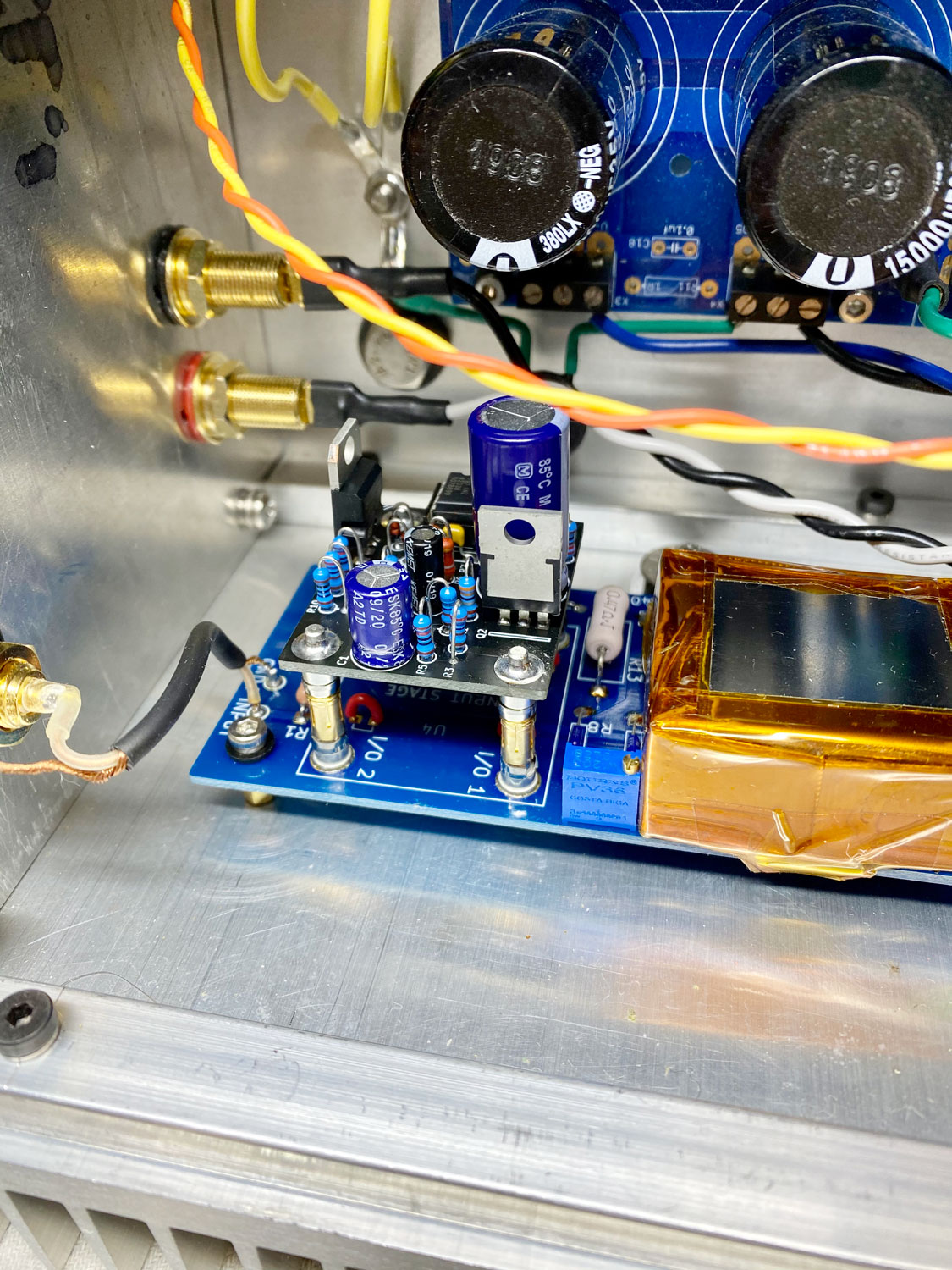

Thanks for the replies. There is a ground terminal, which I previously considered only on the “input”. I was struggling with a different concept though, that the daughter board does not have a ground. It struck me today that the “out” connection would work as a ground. Is that correct?
This SMPS has both + and - , but I’m guessing that just like my cheap bench supply, it will only supply either +24 or -24. I might could use both the meanwell, and bench supply I suppose.

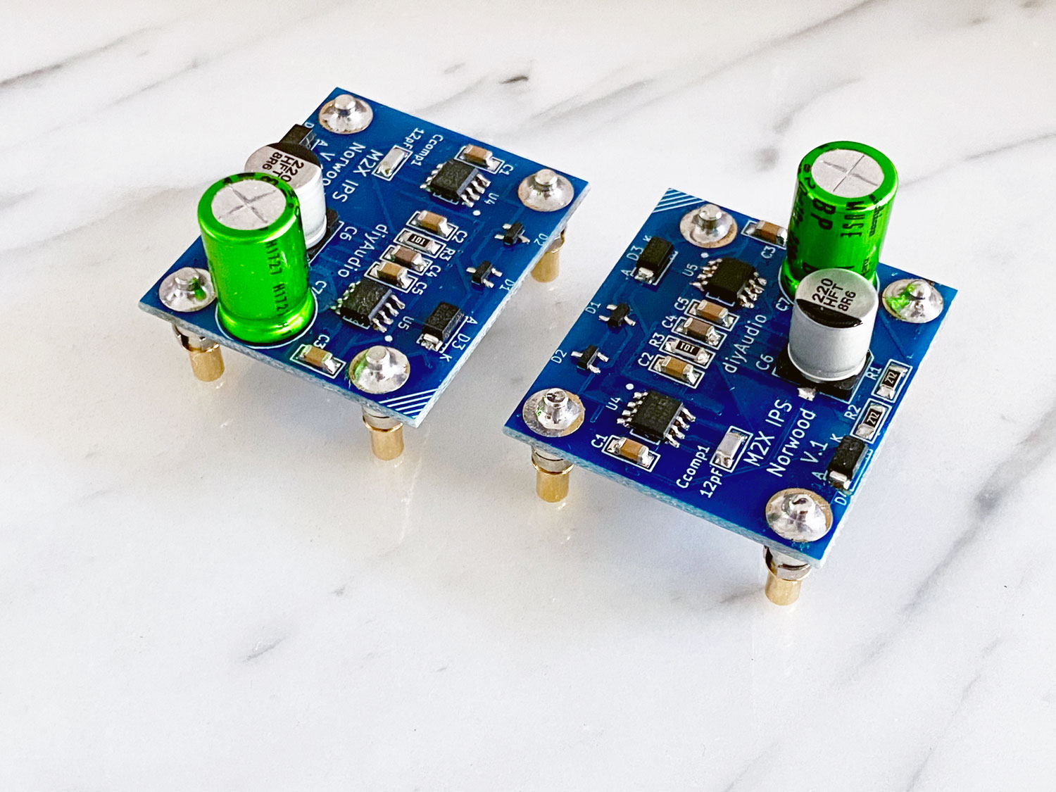

Being that the daughter board mounting hardware is part of the signal path, has anyone found any fancy hardware like copper standoffs? Or are we all just using aluminum and steel?

It is a "single output" supply. You need two of them or a different supply. Sorry I didn't look at which model you had on the Amazon link. Two of these would work or find a dual out supply.
So yes, you are correct, it's one of those either or supplies.

I use M3 brass standoffs, available in various lengths and styles, typically from Amazon:
https://amazon.com/gp/product/B00NQ87PVK
if you are concerned about oxidization, this is the best I have found to add betweer the board and the standoff:
https://amazon.com/CAIG-LABORATORIES-D100L-25C-Contact-Cleaner/dp/B0000YH6F8
I tried to find a jeweler or a jewelry repair station that would plate the daughter card mounting hardware with some kind of precious metal. I asked about gold, platinum, silver, or rhodium. The answer was, helll no, not anywhere in California, the required electrochemical steps are incompatible with hazmat laws.
Maybe some other jurisdiction might be more accommodating. You could ask around.
Of course you could always solder insulated stranded wires into the motherboard, connected to lugs which fit between the daughter board and the mounting washers & nuts. Use a total of eight wires and eight lugs, two per bolt, to increase the probability of an excellent contact. One lug on the bottom side of the PCB then another lug on the top side of the PCB. And search eBay for gold plated lugs.

These are all great ideas. I live in Oklahoma, the environmental related regulations here are not nearly as stringent. The jumper idea sounds like a pretty good idea as well. For now i will just worry about getting it built and populating as many different daughter boards as possible. I think Mouser will do PCBs now. I would like to use your gerber files and get those new ones made as well. Thanks for your continued effort on this and other projects on here.

Im not worried so much about oxidation as i am maybe optimizing the signal path. I have heard nothing but strong praise with the M2X so i am very confident it will sound amazing with standard aluminum hardware.

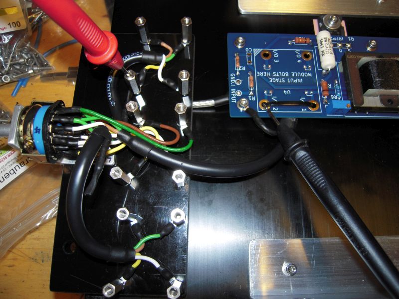

M2X- switchable inputboards
Hello M2X-builders,
I have used solderlugs to make the contact to the standoffs (for mounting
the bufferboards) in my inputboard-switcher. Works like a charm.
I never had problems with contact.
