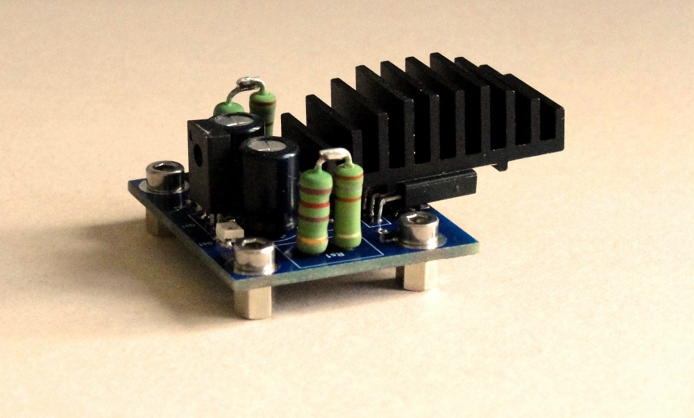

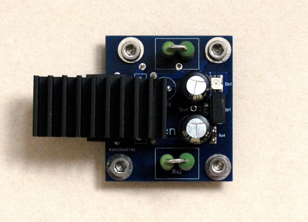

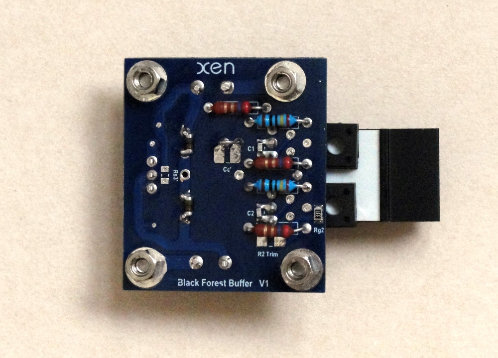

Black Forest Buffer Proto
I am more focused on the BlackForestBuffer of EUVL at the moment. Still some tweaks to do. But it plays music...
Dirk 😀
Dirk told me he had issue with one channel that I do not understand.
So I asked him to send me a PCB so that I could build and check.
That was done this afternoon.
Only using nominal values with no trimming, DC offset was stable over 30 minutes at -6mV.
Bias went from 33mA to 35mA, hardly anything.
I ran it with a 10kHz sine wave for half and hour.
So no issue whatsoever.
The PNPs for the buffer did need some heat sinking.
I just grabbed one from my drawer, for convenience.
So the bug is not in the circuit or the PCB. 😉
Patrick
