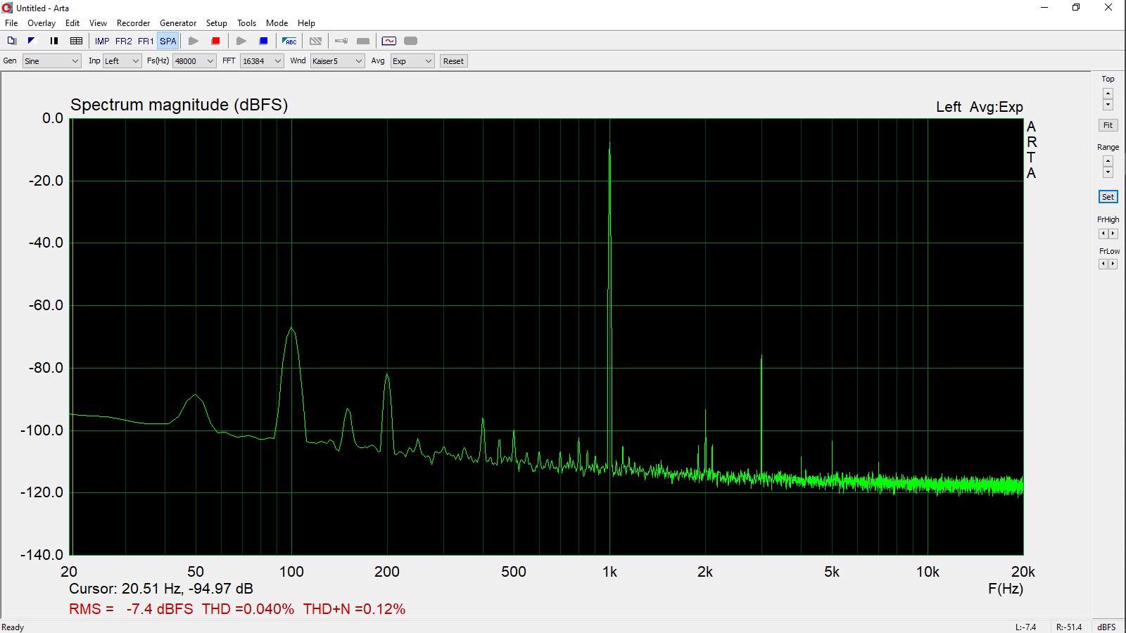

If you have a sheet of mu-metal you can try to put it in front of toroid so you screen it. Steel may also work. Also the orientation of the toroid can make a difference. But the 50 Hz noise looks low now with transformer away from Edcor.
But looking at your Arta measurement you have a generel raise of noise towards the low frequencies. I did not see that on my measurements. It would look nicer if the noise floor was equal all the way from 20 to 20 kHz.....at about -130 dB or so....but it will depend of power level.

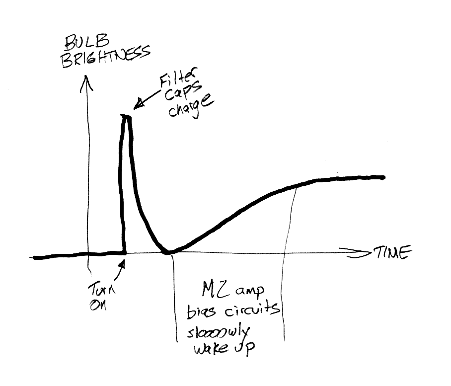

In the process of integrating the parts of the M2x. Power supply has checked out fine on its own. I have connected one channel and turned on with the light bulb in the power line. Bulb turns on briefly, then turns off. Output offset reads very low. After about 10 seconds of being low, it starts to increase slowly. After about 25 seconds the light bulb begins to glow and then when the offset is near a half volt, the light bulb is on. No smoke, nothing getting hot.
I want to get some input before proceeding further. Is still having the light bulb tester in the circuit affecting what it going on, or is there an indication of a problem. I don't want to take the light bulb tester out of the AC line without getting some input on what may be going on. Any suggestions?

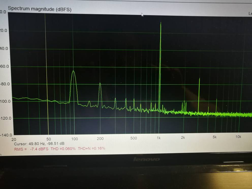

My measuring interface is a notebook soundcard, so not the best. The maximum I can give to input is 0.5Vrms. I didn't even connect the dummy load here. I just wanted to observe the noise.
Input board is still Mountain View.

the dimbulbtester - phenomena is well known with the M2X:
If you switch the M2X on the dimbulbtester dims down/ or goes off (then everything is o.k. with your M2X) and after a few seconds the bulb comes back shining. It is the same on my M2X. Also other members reported about this behaviour.

hayenc, that behavior you had was normal for the M2.
here's how it goes, light comes in bright as the large caps charge, they reach charge and then dim down, it takes a bit to bias up the circuit.... it comes in slowly and the light will again get brighter. It depends on the wattage of the bulb, just how bright it will get.

Thanks much. Did not make it through all of the M2 posts and had limited my search to the M2x thread. After making the blasphemous heresy mods, the amp is settling in with offset.

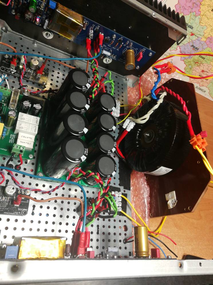

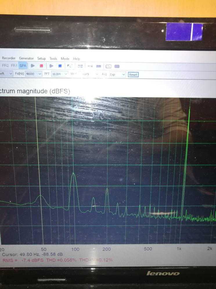

I pushed the transformer back really far. This is what the ARTA graphs look like. On the second, when the edcor output is shorted.
Are you measurements done with only one channel powered or with both?
I am not sure if I like shorting edcor transformer output and what that tells if anything.
What noise do you pickup with only one channel powered and its input shortened?
I am not familiar with your ps board...is it a dual mono setup PS board? I see you are coming out from two separate opposite points to go to each channel.
