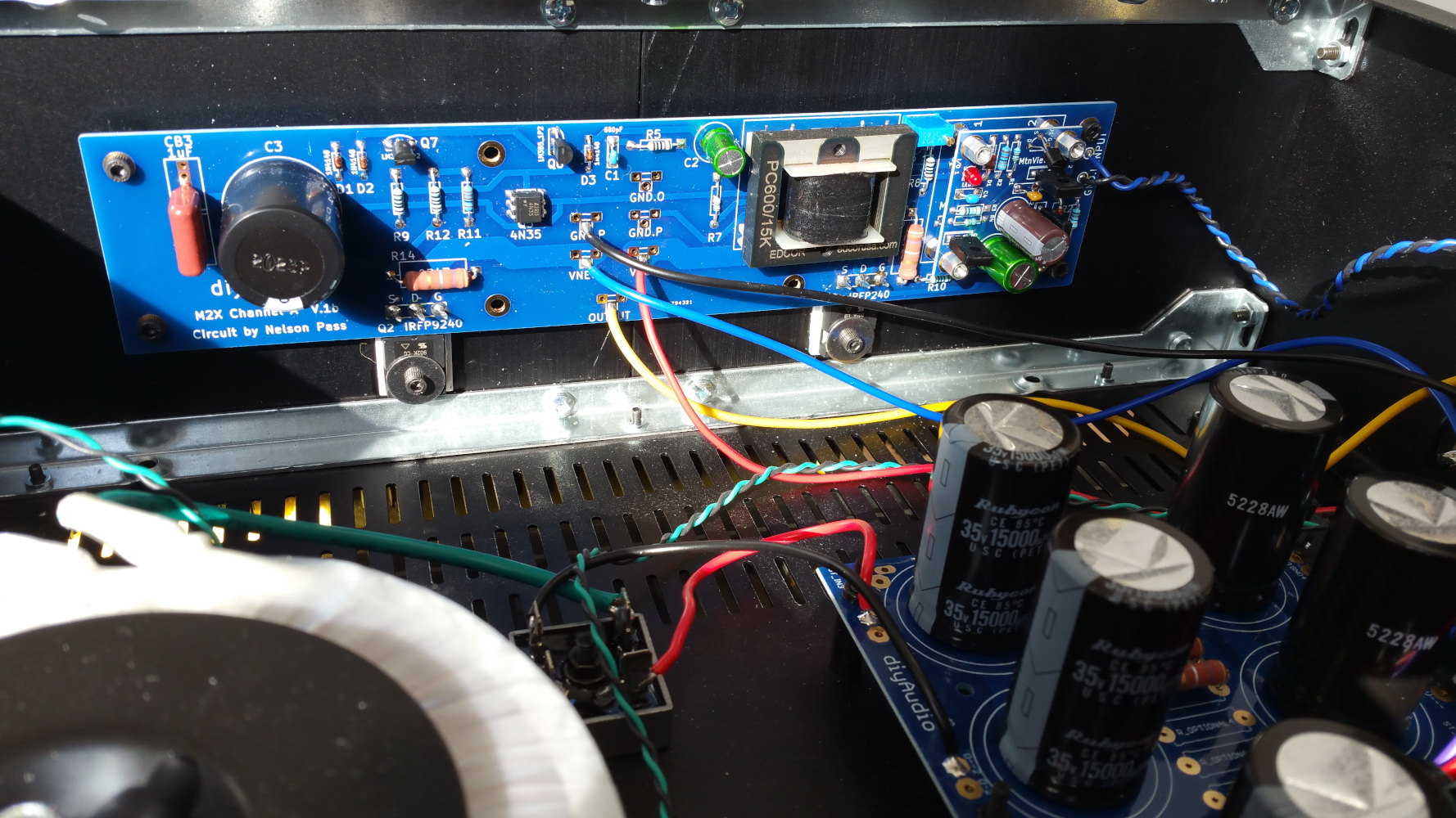

Thanks Mark for an awesome project!

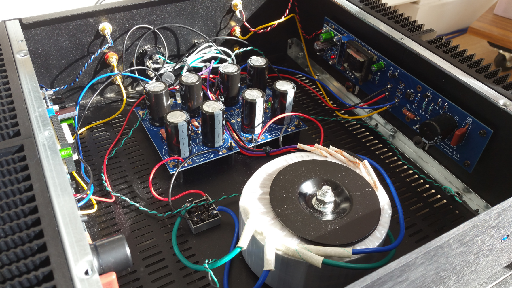

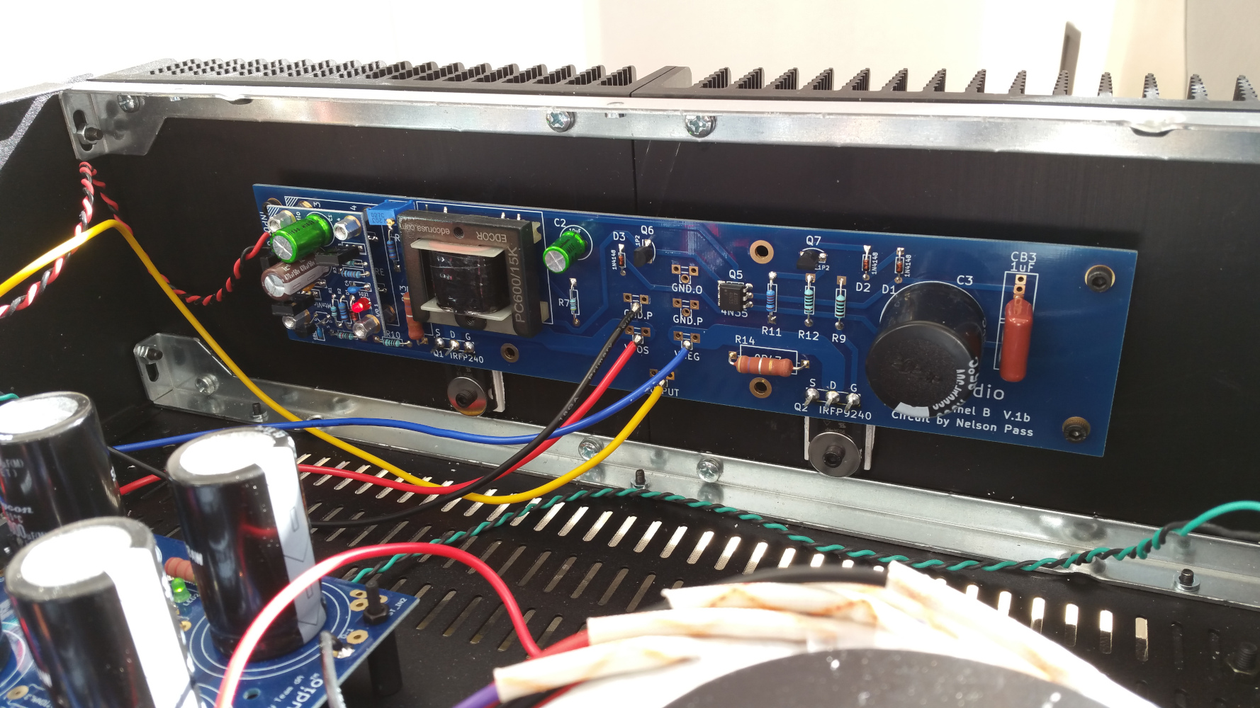

I've got all 5 input boards working and I'm
working on the other 2.
Lots of fun to be able to change inputs!
Bruce

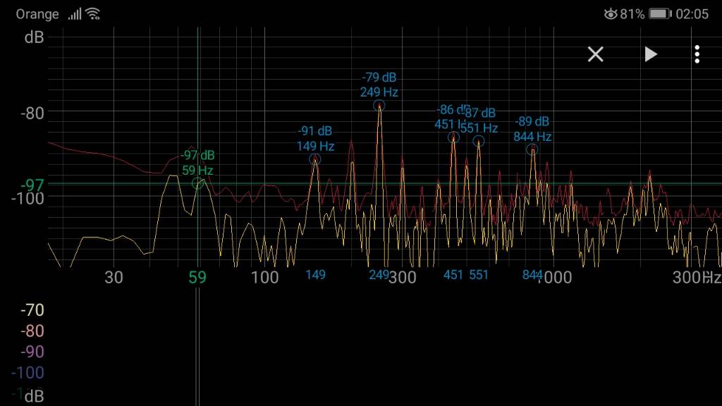

The amplifier worked well for several hours, with no DB but with a shorted input. Stabilized offset, bias and temperature. 100hz noise disappeared but other frequencies dominate. I'm not worried about that yet. I will connect Ischikawa tomorrow. Thanks for the hints.Screenshot_20201206_020523_org.intoorbit.spectrum.jpg
That noise is because the front end is floating... you have the input leads shorted, but there is no daughter, so the inputs shorted mean nothing with an open after it.... look at the schematic.
Don't get hung up on measurements right now, get it running check the offset and listen to some music. 🙂

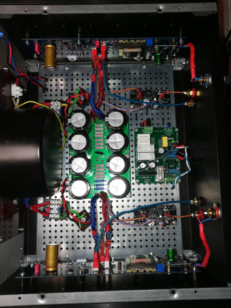

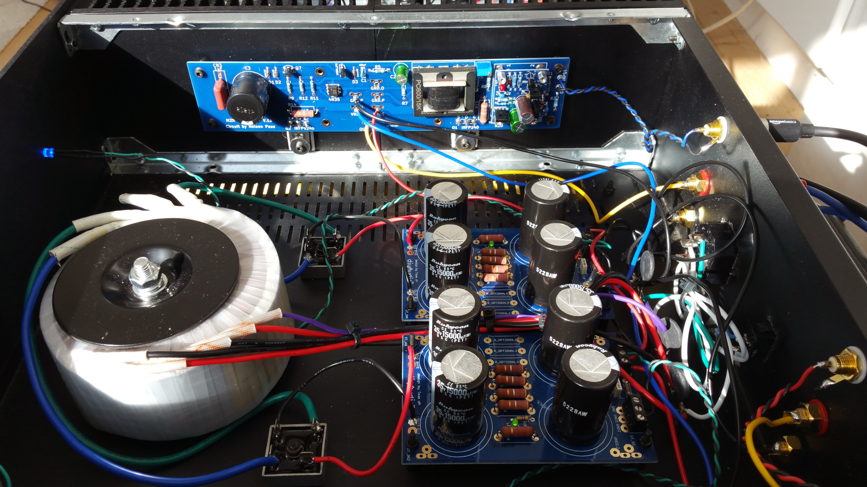

Ufff... Works fine. Connected Ishikawa cards. Voltage and bias correct. Temperature on mosfets 55 ° C. I have removed the connection between "gnd neg" and PS board. 100hz noise is not dominant. A bit quieter but I hear 250Hz and I don't know how to get rid of it.
Congratulations on the progress so far! 🙂

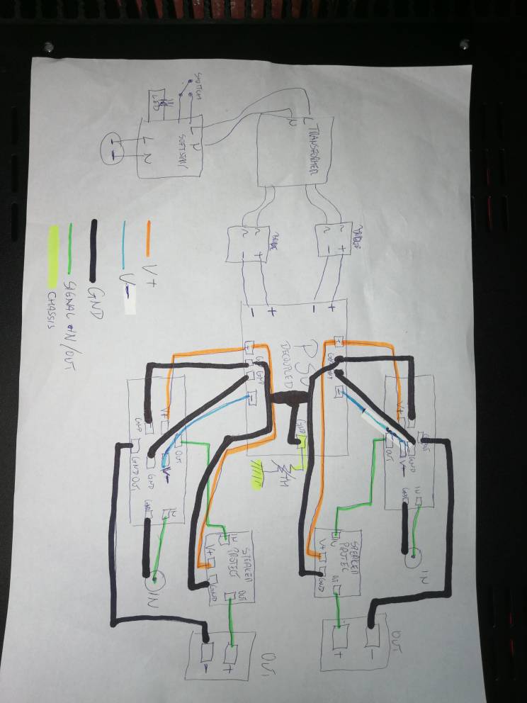

Do you have pics of the amp in its current state and a wiring diagram for how you've got it all connected? If so, please post. 55C on a standard biased M2x makes me think (relatively) smaller heatsinks=> maybe (relatively) smaller chassis=> maybe a bit cramped or wire routing is not optimal + maybe noise picked up at signal transformer.
Edited to add - You clearly said 55C on the MOSFETs, not on the heatsinks. DOH! Either way, pics / diagram may help.
Hi, Darrr. Everything seems to be fine from your description. Don't forget to set the output DC bias close to zero.
Concerning the hum, I could say this from my experience (I am a new guy also, so take it with what it is): I read somewhere that odd harmonics from power supply are mainly caused by the magnetic interference picked up by the circuit, mainly Edcors. I also had some hum in the beginning. Much less remained when I put a steel cover on the toroid power transformer and mu-metal shields on Edcors. I noticed that this helped mostly with the odd order harmonics (150, 250 Hz). I still have some 100 Hz hum remaining that I will try to work on some time, but it is hearable only with the ear next to the speaker, nothing at all at the normal listening position, so I am happy for now.
Lovely build and layout. I particularly like the rails coming from the sides of the CRC board.
I see a lot of things that look very well done, and I don't see anything that I can call out to try changing re: layout or wiring. Perhaps someone with eagle eyes may see something.
Alternatively, it's something in the circuit(s). Sadly, I am out of my depth there.
Good luck! 🙂
Here are the photos. The schematic shows a link that is no longer there: gnd.neg to PS.View attachment 899624View attachment 899625
Keep it simple and reduce the number of possibilities... First thing I would do is shut it down and pull the speaker input to the DC board and test from there and see if the 250Hz is still there and at the same level. If it's unchanged you have ruled out anything from the DC boards and can move on to the next thing.
Short the inputs and test, un-short and test changes?
