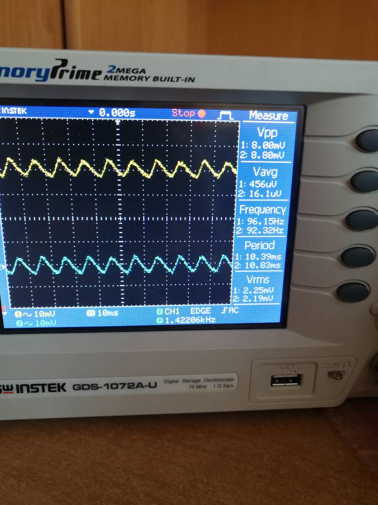

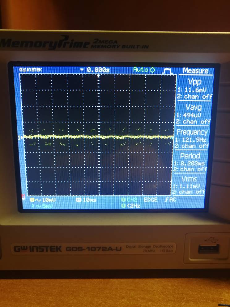

I am sorry if my posts sounded rude. My English is not good and I use the translator too. Obviously my mistake was that I didn't set the range well on the oscilloscope. I didn't understand exactly because this is my first big DIY project and also my first attempts with an oscilloscope (borrowed from a friend) I really appreciate any help and thank you for any help.

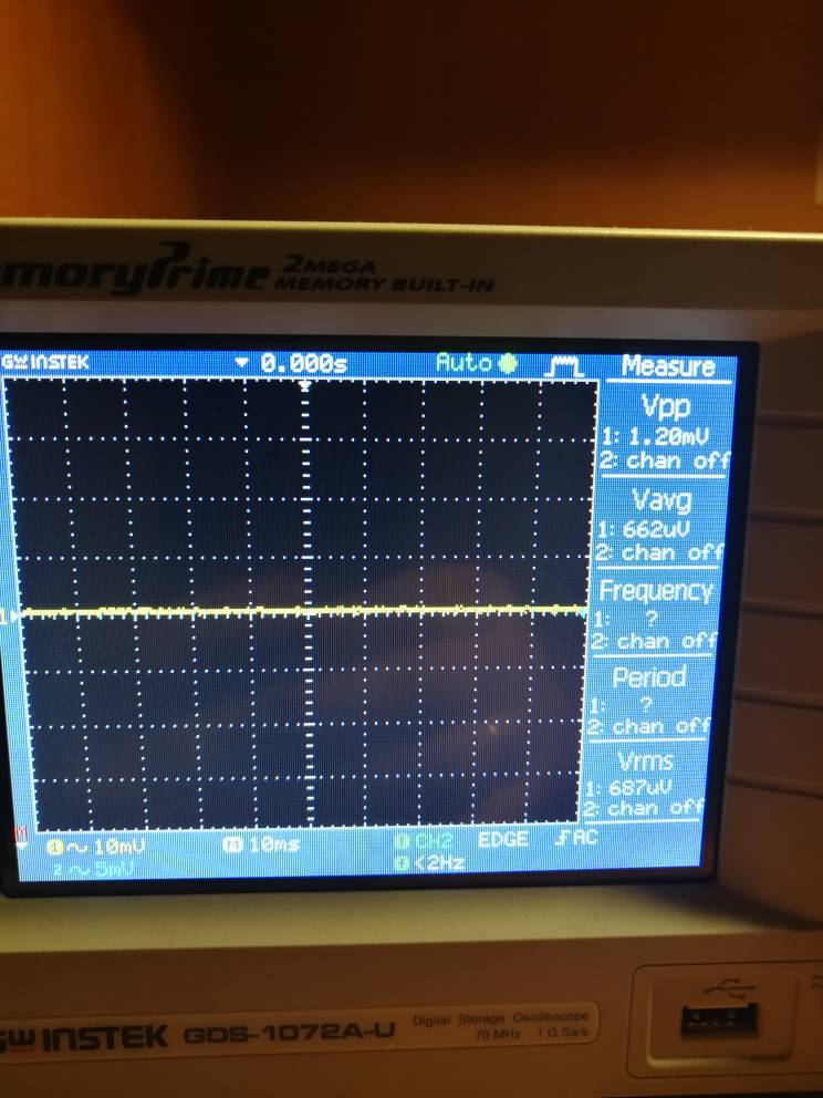

I already have this photo. The second pic is the measurement of the right channel connected to the loudspeaker and the input shortedIMG_20201202_015833.jpgIMG_20201202_015643.jpg
The measurement of the amplifier output under the same conditions with the second probe is different
Also maybe post an image here of M2X PCB with Edcor you showed at the other power supply thread. Then other people here can comment the copper tape you have around the core of the Edcor as I think it is not the best to do as it could cause core saturation in Edcor so signal will be attenuated when you connect amp to an AC signal source.
According to your advice, I removed some of the copper band from the edcor. I finished the wiring and tested with an oscilloscope. Now have about 9mVpp on the outputs. One loaded, the other opened. Both inputs are shorteed. Directly from the speaker the noise looks like in the second photo.
Will the edcor cover by mumetal reduce amp noise or the problem is different?L%20chn1%20%20speaker%20R%20chn%202%20open.jpgtannoy%20zwarte%20wej%C5%9Bcia.jpg
Normally when you wrap copper around an EI transformer it is done at the outside of the "frame" and not around the center core like the primary and secondary windings are.
Mu-metal is good for screening magnetic induced noise which are normally 50/60 Hz from power transformer. You have 100 Hz noise and it must be from the rectifying (ripple noise) and I don't think mu-metal around Edcor will reduce this. But you could try it......and see what happens. 50 Hz noise will be reduced. But I can see that you have a screen around your toroid transformer. If it is steel it will reduce the 50 Hz magnetic field from transformer.
Maybe some experts can comment more about this 🙂

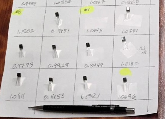

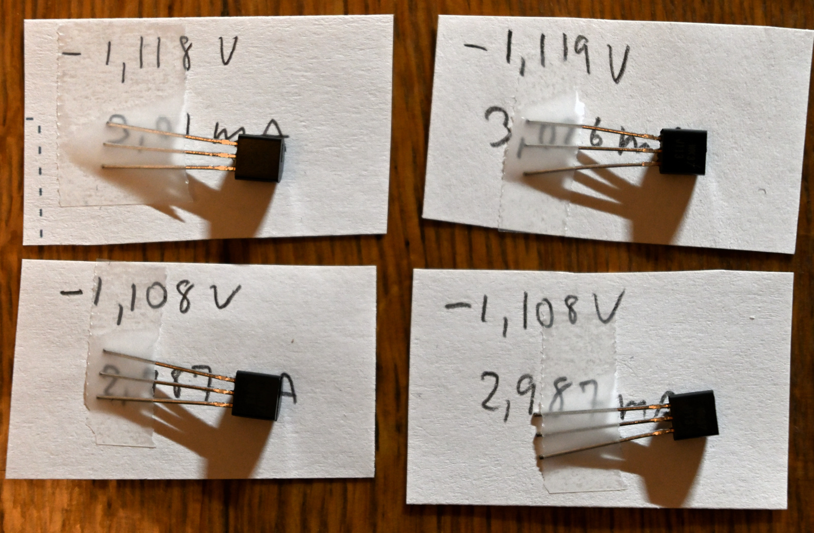

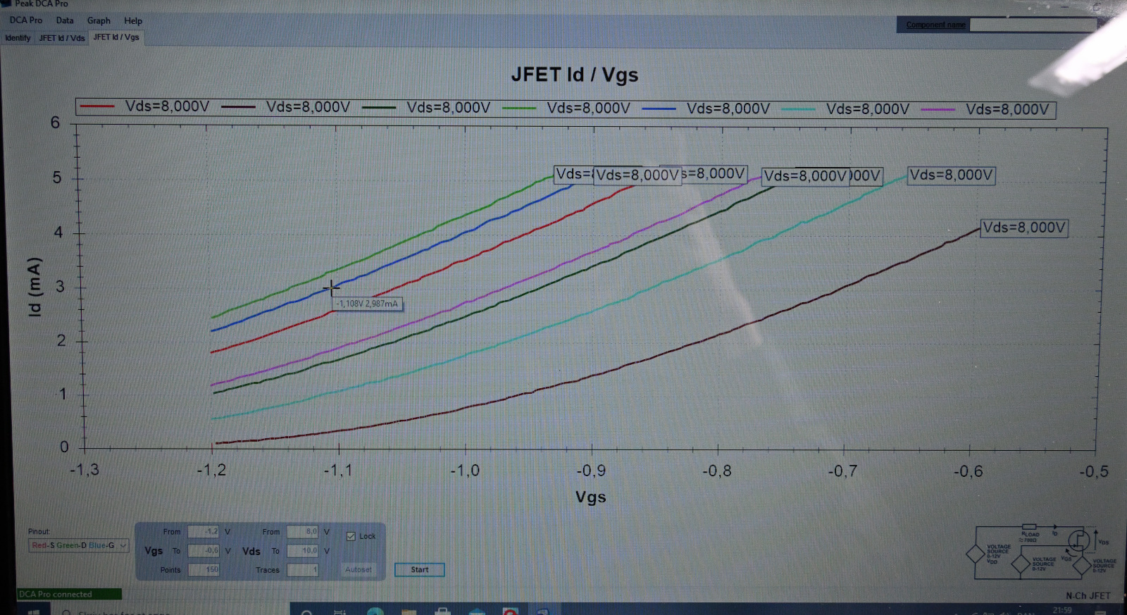

I started the J113 matching for IPS #6 input board. I decided to try out the PEAK DCR tool that has a small curve trace capability if connected to a PC with some dedicated software. I started with single curve traces for each J113 (Vgs on X-axis and Id on Y-axis) with a fixed Vds. The tool only allowed max. 8 VDC for these single traces. On paper it can go to 12 VDC.....but it set the voltage back to 8 VDC for the single trace I defined. But as least all JFETs are measured in same conditions. The first selection was made based on Vgs at the 3mA point (or as close as possible).
I got some candidates for pairs that can be further investigated (maybe 10 candidates for pairs out of 50 J113).
Two candidates for pairs are shown which I will measure further. I will test with curve tracer how close the pair "tracks" same curve for each pair.
I wonder if there is a preferred 3mA Vgs that does is easier to calibrate the IPS #6 boards. Also that I like symmetry my mind says that I should try to get as close to a quad as possible. I also have pair candidates with Vgs at about -0.7 to -0.9 VDC.
The curves at image shows curves for random selected J113 so they differs a lot if just random selected.

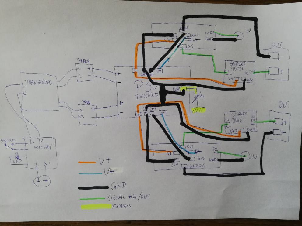

I read it, but I certainly did not understand everything exactly. I made a wiring diagram and looking at it I noticed that there could be a problem in one place. From the PS on the positive rail, I have a gnd connected to the amplifier pos.gnd and to the speaker protection power supply.
I include this diagram and please comment. Is there anything else that could be causing the problem?IMG_20201203_130934.jpg
Eh ..... I tried to work carefully and patiently. Unfortunately, too much thought and tweaking connections made me careless. Now I have a bigger problem.
I wanted to test my idea. This time I didn't use the bulb tester and Murphy's law worked. I have connected V + to pos.gnd on one channel. I saw smoke. Before I turned off, the fuse in the socket (2A) was blown. I checked, looks like damaged Q1. Anything else could be broken? R13 measures the same as on the good channel.

Thank you for your enlighting answer. I soldered my jig on a small piece oft stripboard and had to correct some flaws that i made during the process. After all the tinkering i was not sure if everything was set up correct.
I sucessfully measured all oft my 100 J113 yesterday. I wrote values down by hand but i will enter everything into a spreadsheet, because i like spreadsheets.
