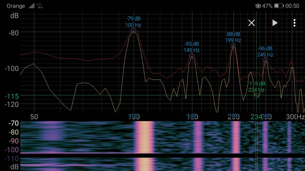

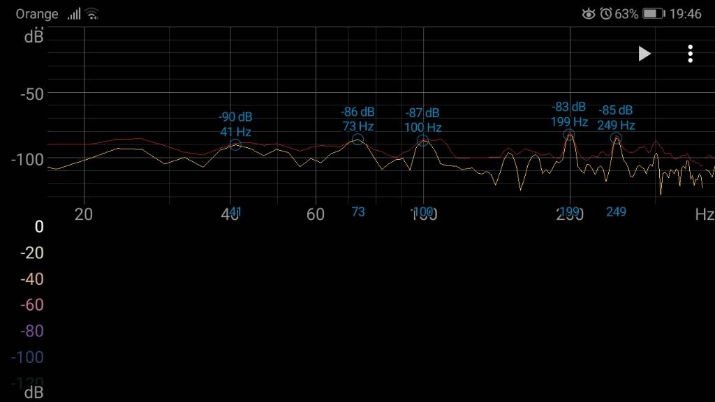

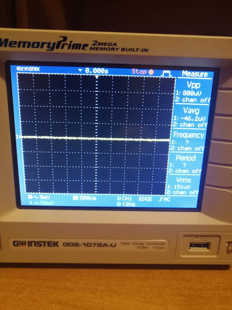

I didn't connect any speaker yet. I will try it todayWithi no load, this does not matter.
Can you hear any noise on your speakers?
Ok. Here is the pic you wanted to see.Darrr- can you please attach probe and ground clip across a 100ohm resistor and post a photo ? Would like to see your background.

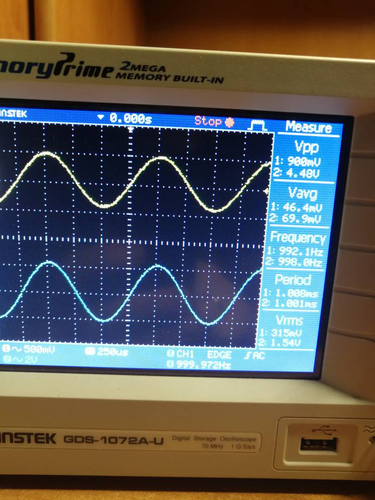

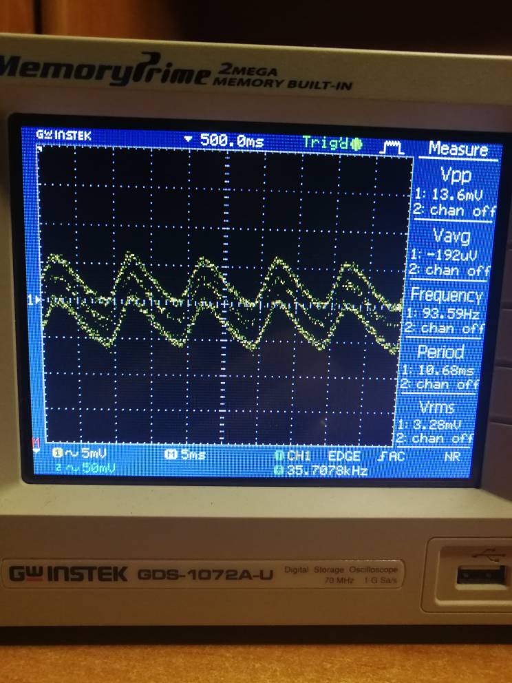

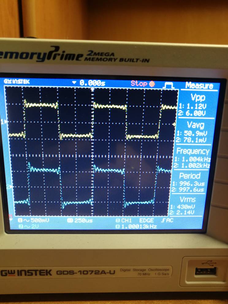

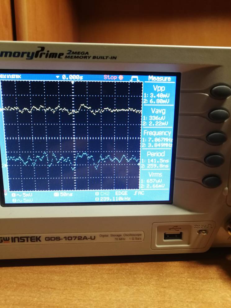

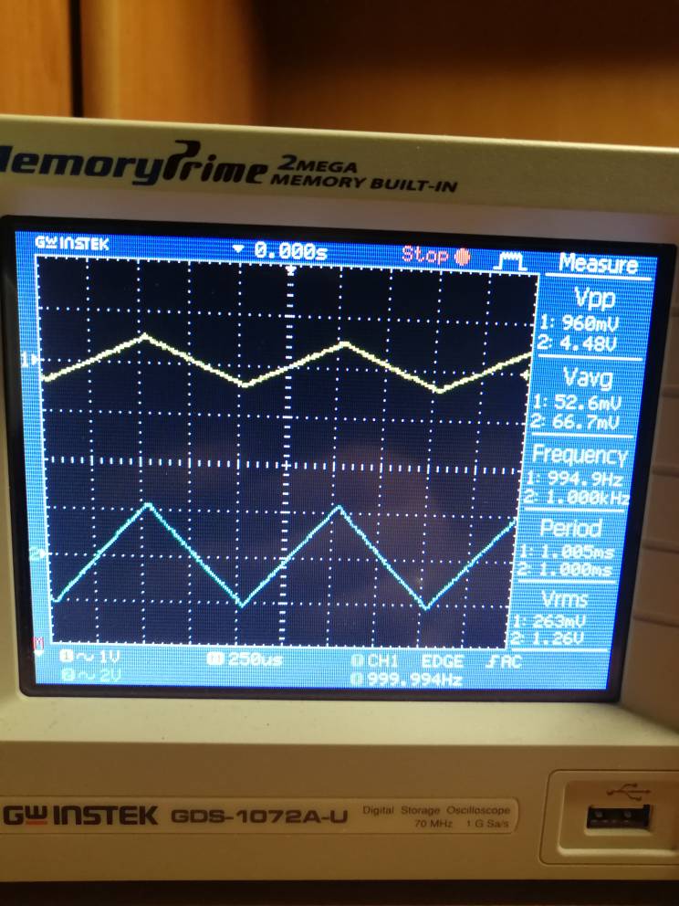

I decided to check the generated sine, triangle and square signals with an oscilloscope. Since I am a noob and I do not have many tools, my idea was to use a smartphone as the source of the generated signals. IMO sine and triangle look fine but the rectangle shows source oscillation. Can I read the last pic well - it's ~ 7MHz? This is without any signals on source

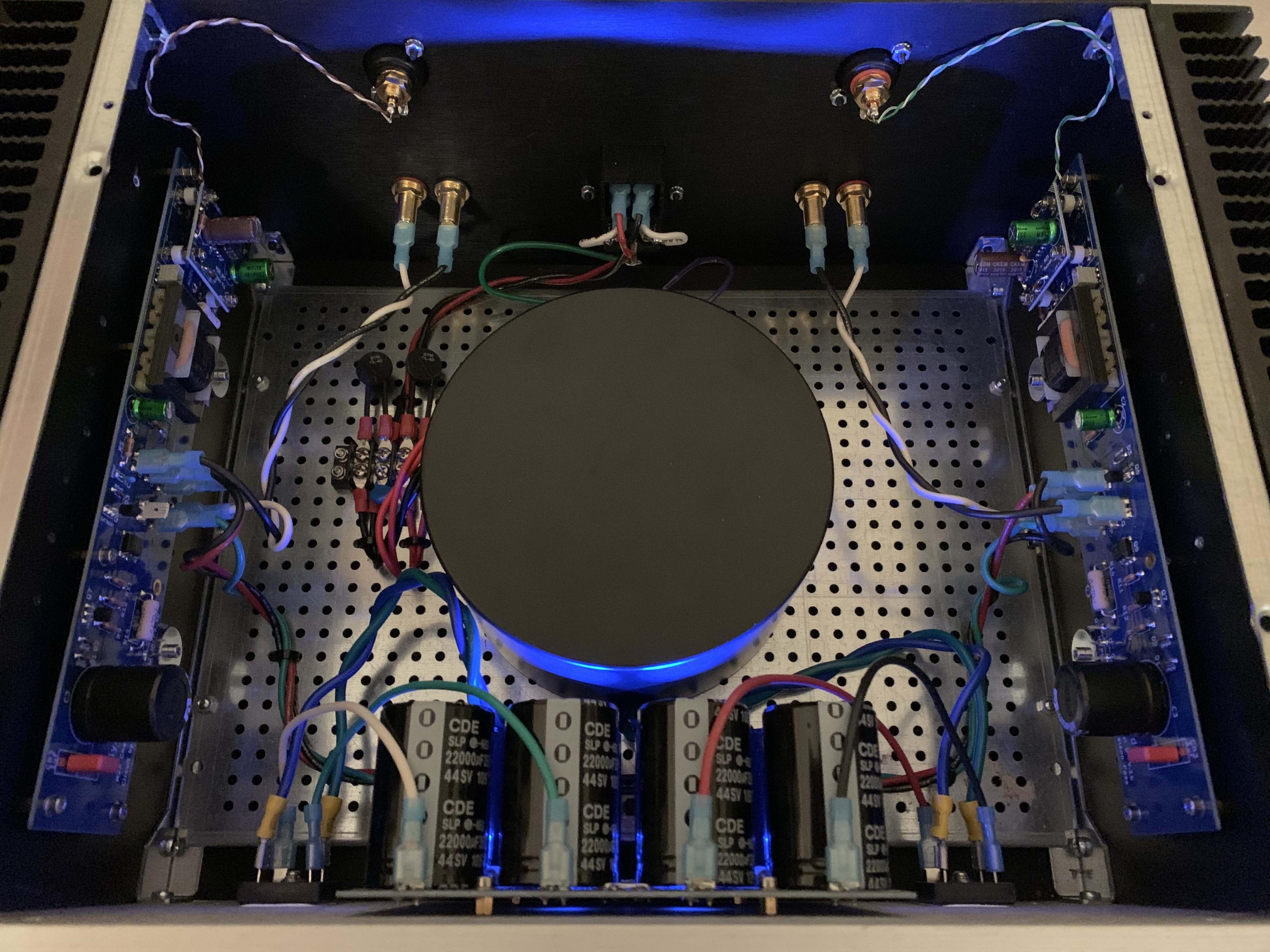

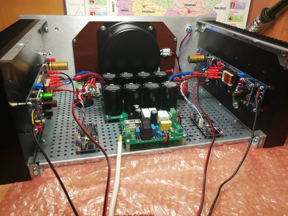

To use shielding, I chose to rearrange my F6 layout to accommodate the big steel shield over the transformer. Something needed to be vertical, so I moved the power supply and diode blocks (w/thermal paste) to the front panel. This did put the transformer in the center, closer to the Edcores but the shield seems to work. I'm hearing no noise or hum at all. Starting off with Tucson (604's, 1122's to sub in later) but I have parts for Ishikawa and Austin as well. I just wanted to share a photo and report that this configuration for me is very quiet.
