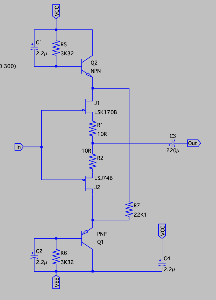

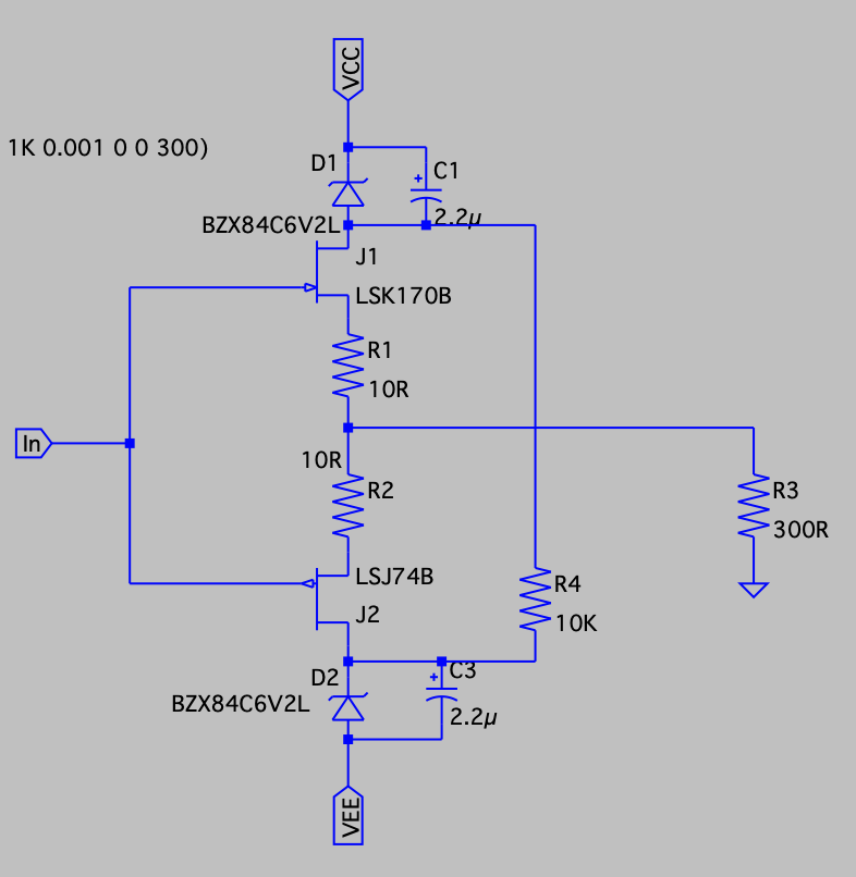

I was going to try the Ishikawa IPS next, but am wondering about my +/-26.5V rails. Even rails at 24V seem to stretch it assuming input voltages would go to 2 or 3 Volt, with the J74 having a V_GDS max of 25V. My rails are 10% higher, so I'm a bit worried.
@TungstenAudio, you mentioned a while back you modified your Ishikawa IPS to deal with higher rails? I was looking for the post but could not find it, so I was wondering if one can just use a couple of Zener to bring the voltage down? Like in the schematic here. Or are Zeners too noisy?
@Zen Mod was mentioning Cascoding, is there a schematic for that somewhere?
Thanks!

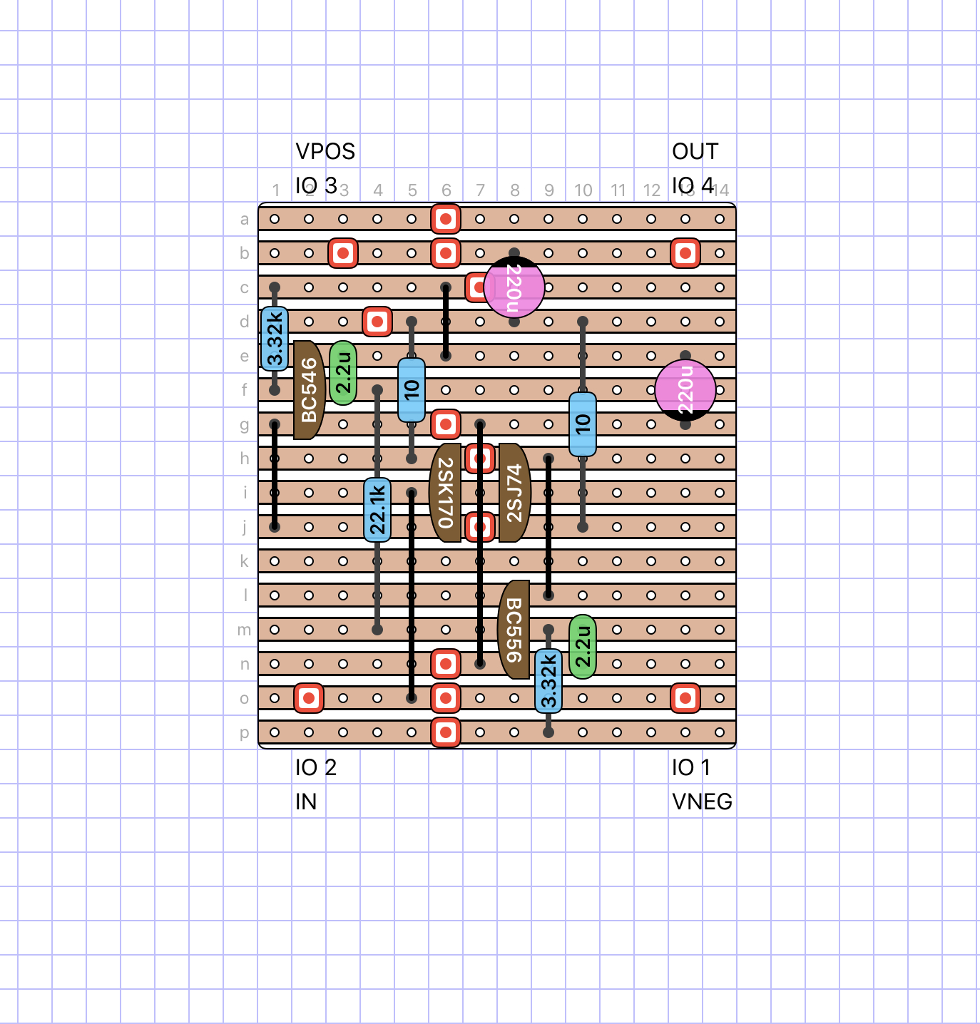

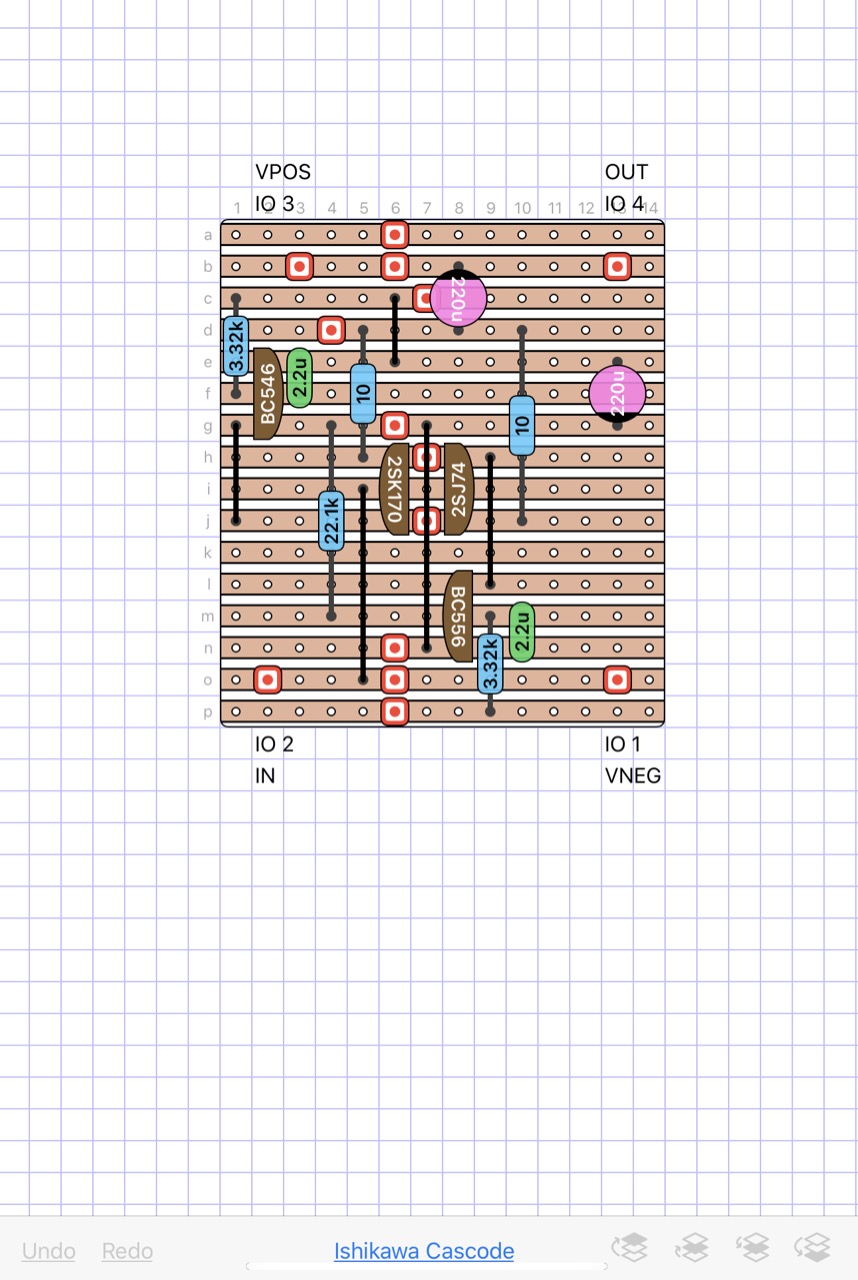

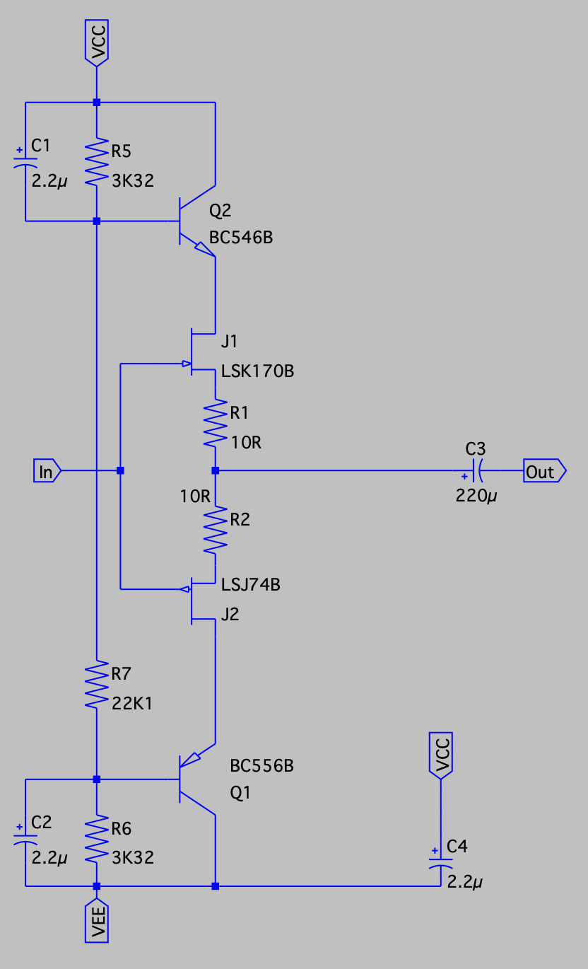

I tried a different way of "cascoding" the JFets in the Ishikawa IPS, which didn't work as well as I had hoped. In this instance, the simplest way is really the best. The circuit can have cascode devices added by inserting an NPN transistor above the Drain of the 2SK170, and a PNP device below the Drain of the 2SJ74. These devices operate in "common base" mode, as their Base terminals are held to a fixed voltage. The circuit may be implemented on a Vero board as shown below. I've used BC546 / BC556 transistors, but others will work as well, as long as the correct pinouts are observed.
The resistor values I've chosen will drop about 6.7 Volts from the VPOS and VNEG power supplies, and protect the P-channel JFet from excess voltage. (The N-channel is Ok for greater voltage.) I also added a 220uF, 63V capacitor between VPOS and VNEG to clean up the the supply in a manner similar to what has been done with the Mtn View IPS. I think this helps significantly, and may be responsible for some of the improved sonics that I hear with the other input stages.

Is there an "obvious" reason why the cascoding would be better than the Zeners?
I'm just learning (started getting into this only a few months ago), and maybe I should just try it -- but at $39 a pop for the LSK/J quad from the diyaudiostore, that's just a bit scary.
The thing that I tried earlier was similar to what you suggested. Instead I used voltage references instead of the zeners. It didn't work, as in muffled sound from the amp after a minute or so. I tried analyzing the failure, but eventually moved on to other ideas.
What we now have here is a simple cascode, where the bipolar transistors are operating in what is called "common base" mode. This keeps those devices at their most linear, and gives the cleanest way of lowering the supply voltage to the JFets while maintaining a low supply impedance. It also lets the JFets operate under constant Vds conditions, which improves their linearity.

If you could devise a way for the bases of Q1 and Q2 to follow the output, then the drains of J1 and J2 would also follow the output. The sources of J1 and J1 already do follow the output; they're "source followers" after all. So if the drains follow the output and the sources follow the output, then: Vds is constant! No Vds modulation of distortion! Constant Vds means constant power dissipation, thus constant junction temperature. Additionally, Vgd is constant and Vgs is constant. These are the voltages across the input capacitances Cgs and Cgd. You've bootstrapped the gate capacitances and now they have no effect.
Whether or not this would actually sound better remains to be seen. It's a well known idea, which means Nelson Pass knew about it when he was designing the M2. But he chose to leave it out. Hmmm . . . ??
