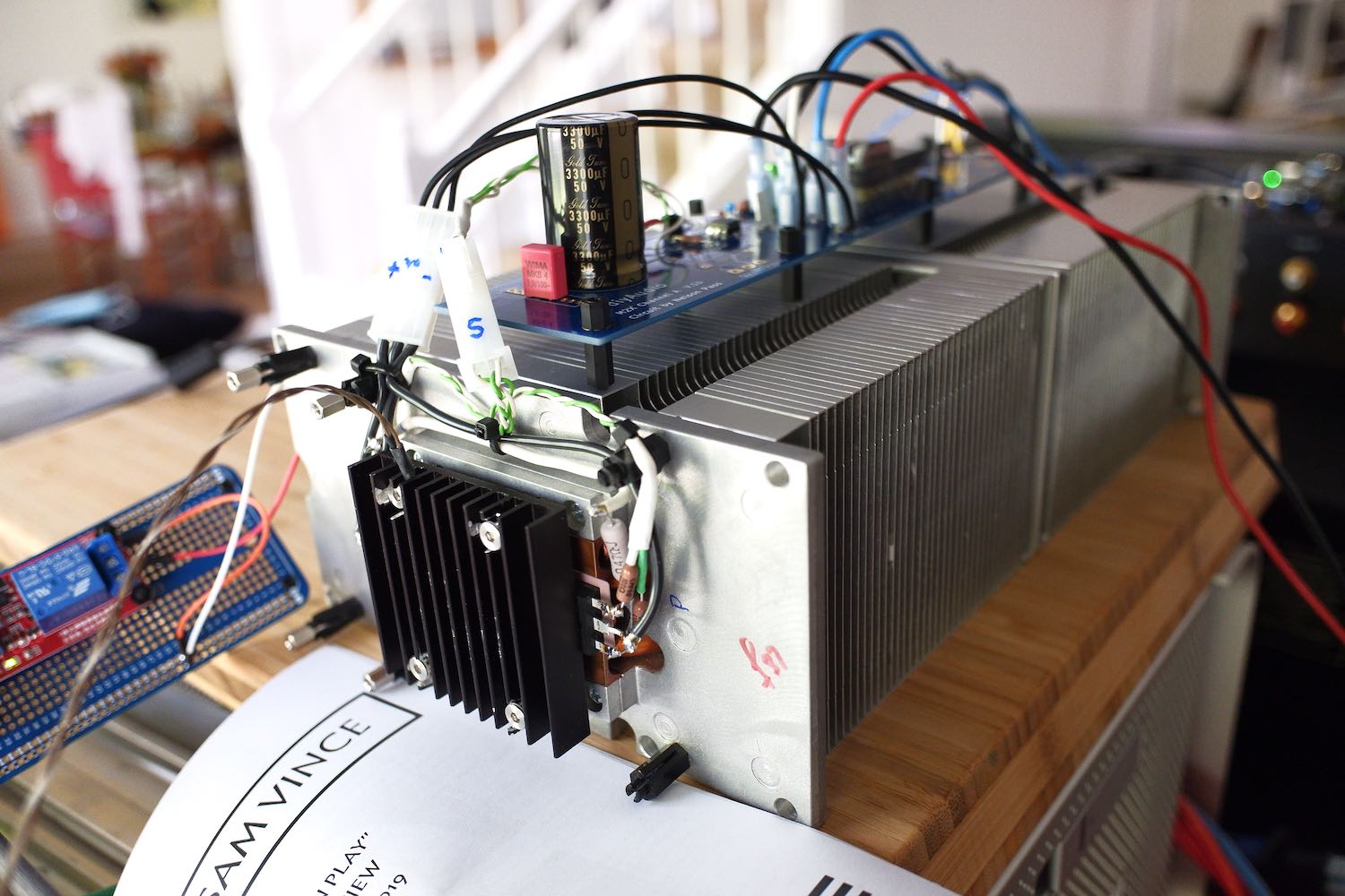

Follow-up on the CPU heatsink temperatures: emboldened by Mark pointing out that nothing terrible is going to happen, I tried running the CPU sinks without any fan.

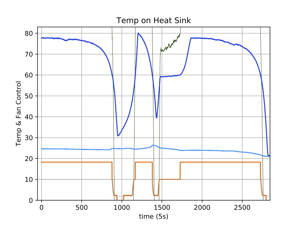

Temperature is measured on top of one of the two MOSFET (only one channel at this point). Turns out, if you're willing to run at ~80 degC (at a room temperature of 71F), this works fine. However, inside an enclosure your milage will vary...
The dark blue curve in the graph shows what happens (ignore the other curves):
The plot updates on the left, so time runs from right to left. I started the run with the sink lying on the side (picture), and the temperature stabilized around 78 degC.

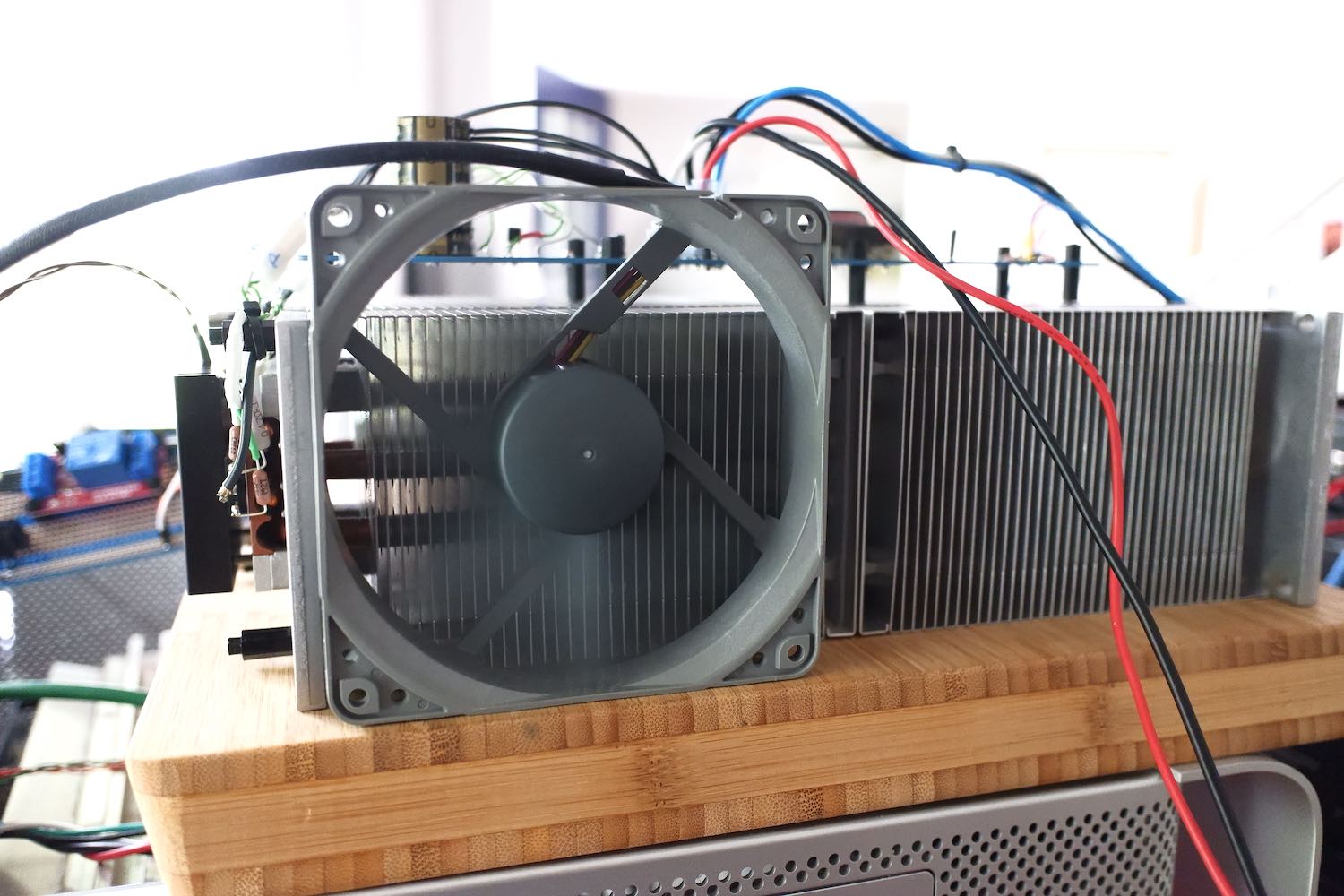

I then put a fan (picture) such that it just blew through the fins of the sink, not giving any air movements to the MOSFET assembly directly, and the temperature dropped to a bit below 60 degC (it would go much below that if I were to fan the top, too, even at very low RPM).

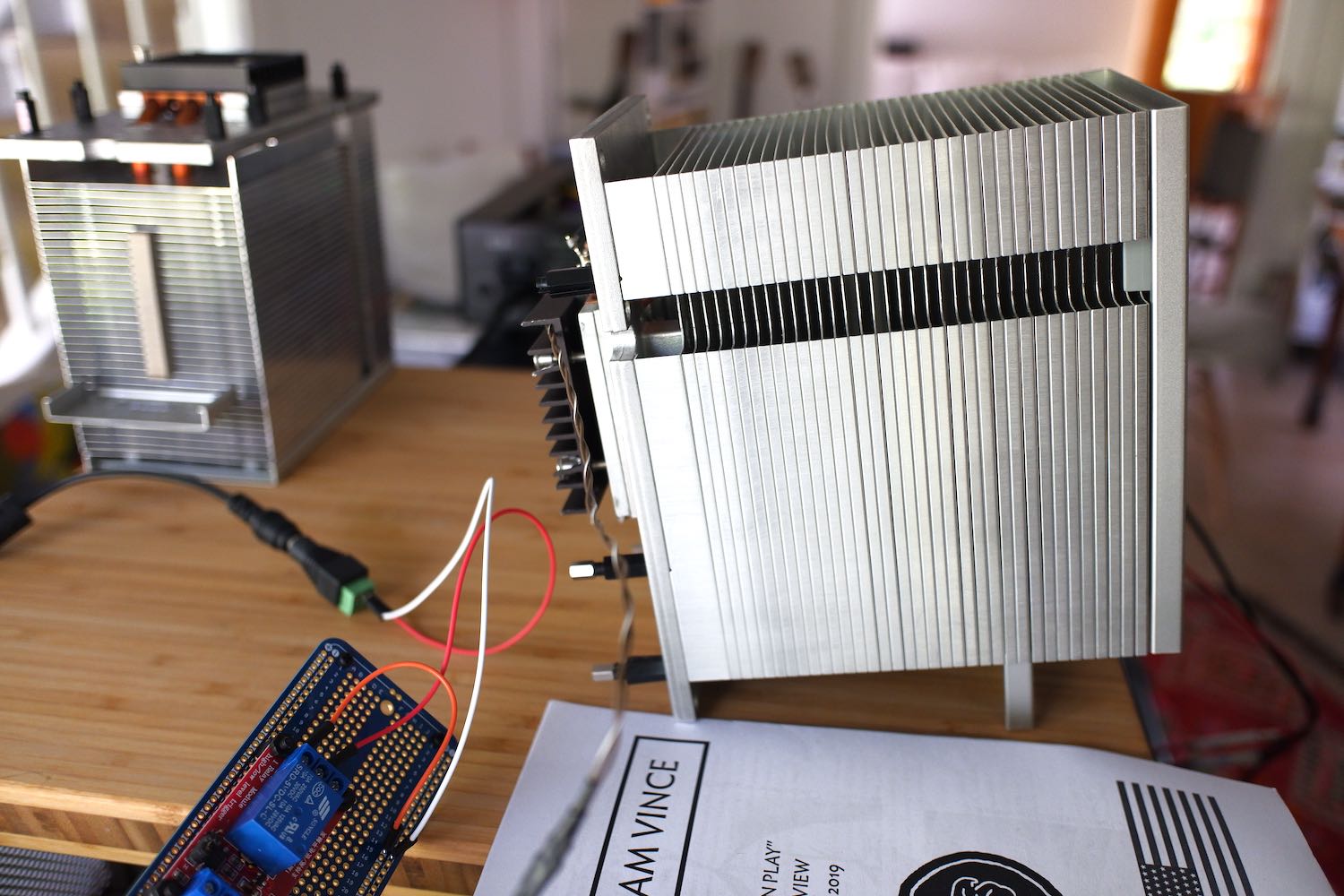

I thought by turning the cooler so that air could rise through the fins I would produce some chimney effect (picture) and the cooling would work better, but in this configuration the temperature went quickly above 80 degC, so I aborted.
The leftmost part of the curve is then going back to the first configuration on the side, no fan, and the temperature got stable again around 78 degC.

That's a very interesting set of results.
I don't know the intended orientation of these heatsinks in the G5. Were these oriented in the mac pro chassis like you show your first picture? For some reason, I thought these were mounted with the long dimension along the vertical. But I have no particular reason to say that, other than that is how these strike me.
I picked up a few of these on Ebay to mess around with. I may end up using a fan, but I'd rather not, so we will see.
see e.g. here.
The measurements were with both MOSFETs on one of the two sinks.

Hmmm.
I found a shot of the interior of a G5, and they do indeed have these sinks on their sides, like you show in your first photo.
After a quick thought, I can easily see why you saw a quick temperature rise when you tipped yours up a bit, trying to exploit the possibility of a 'chimney effect', but this slowed convection currents down, and also was moving warmer air further up the stack, instead of up and off the fins, as the first photo would suggest.
In any case, to a first approximation, if we put *one* MOSFET per sink, given your data, we can expect a delta T half that of what you measured, all other things begin equal. This suggests a steady state of approximately 51C, or around 124F in the vicinity of your measurement location. That seems quite tolerable. I would expect temperatures on the perimeter of the heatsink base, where fingers might touch, to be quite a bit less.
But in any case, these results show that these heatsinks can likely be used in a passive cooling manner, exposed externally to any case holding the boards themselves. As you say, if you put these in an enclosure, you must ventilate really well ('cheese grater' amp) and/or add fan(s). The use of fans clearly liberate you to mount these in just about any orientation you choose.
Nice work! Thanks for sharing about this project- This approach can radically reduce the cost of building these amps, now, because the heat sink cost has come substantially down, and it appears one is not necessarily forced into active cooling, but rather can do this by design choice.
I know what I am going to be doing when those G5 A1047 heatsinks arrive!
