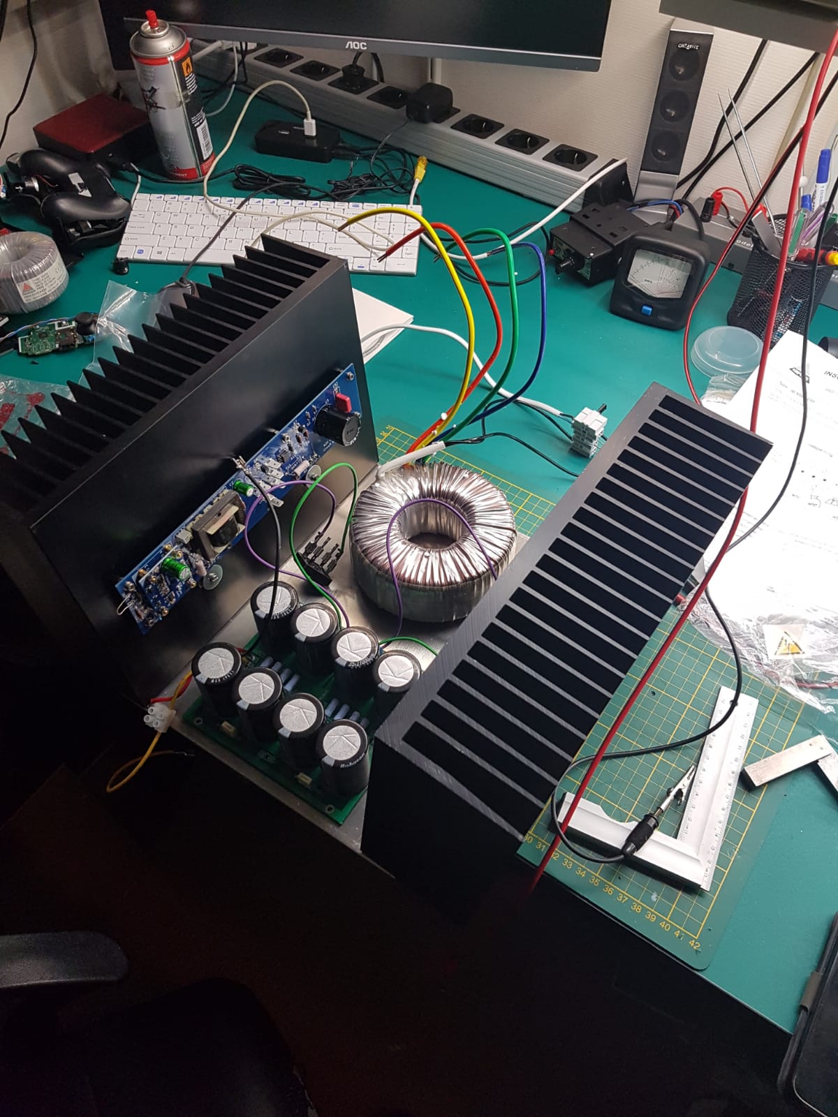

Did I miss it somewhere, or is there a PCB size spec for drilling and tapping to the heatsink? I'm sure I just missed it somewhere...
JT
JT
heatsink pattern
Go to the DIYaudiostore.com site and fish around for the UMS spec. they have it there. You will have to figure out where you want to place it on the sinks but that is easy. They are predominately on 40mm center They have the compete pattern. The drill is 2.5mm with a 3mm by 5 tap. Set it up so that you drill between the blades and you can drill through if you want to. Lot easier than blind hole. Be careful on the tapping. Don't break it off. There is a kind of tap you can get that looks like a drill which reduces risk of breaking. Don't know what they call it.
Warning. Precision is important. On some boards there is very little wiggle room.
Just did it. Good luck
Don
Don
If you screw up and have to drill & tap a second set of holes, that's not the end of the world. The amp will still work fine and play music. And, since the holes are inside the chassis, nobody will ever see them. Nobody will ever know you performed a do-over. So don't sweat it too much.

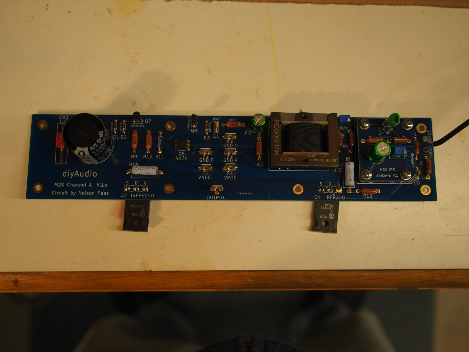

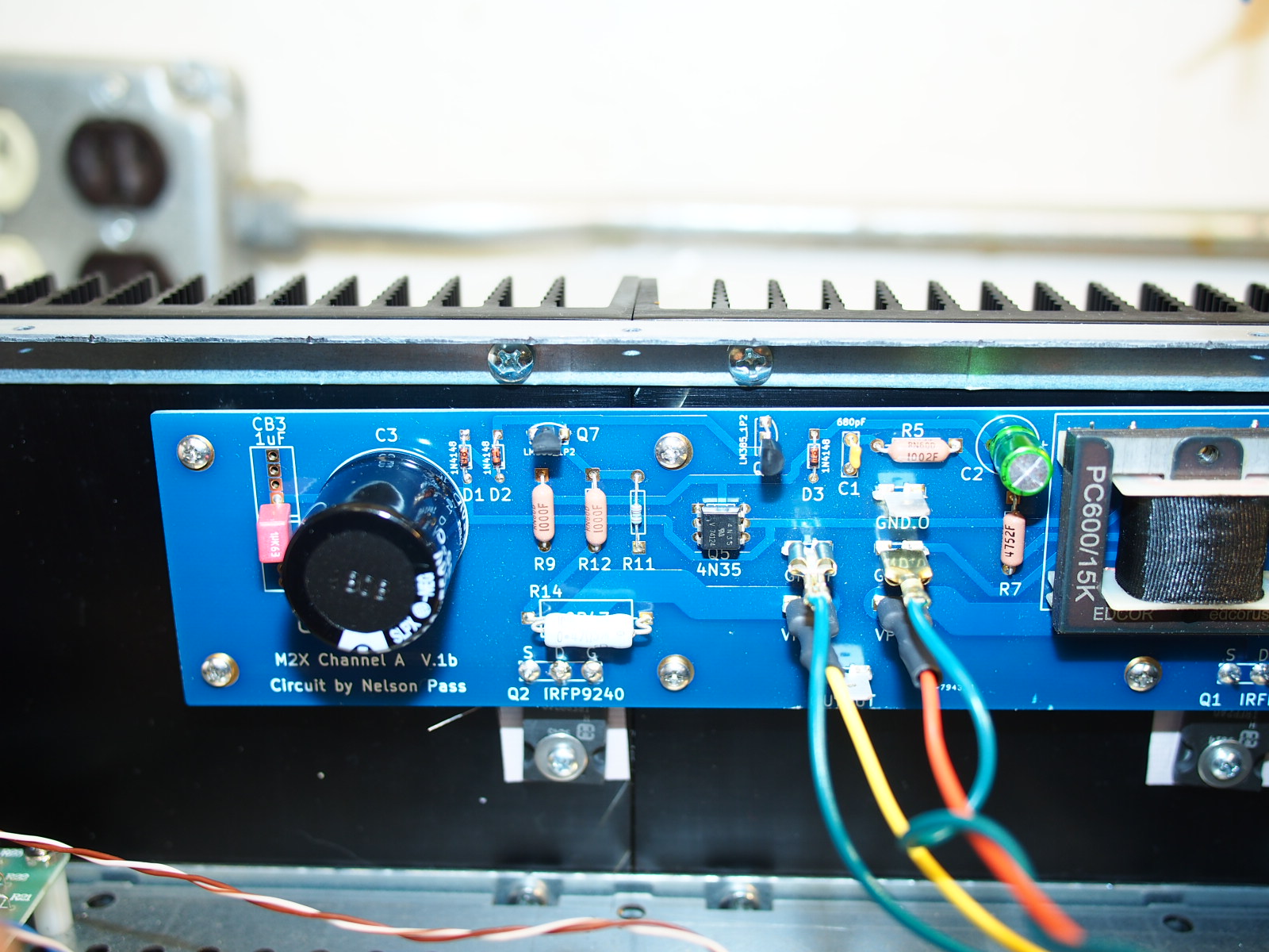

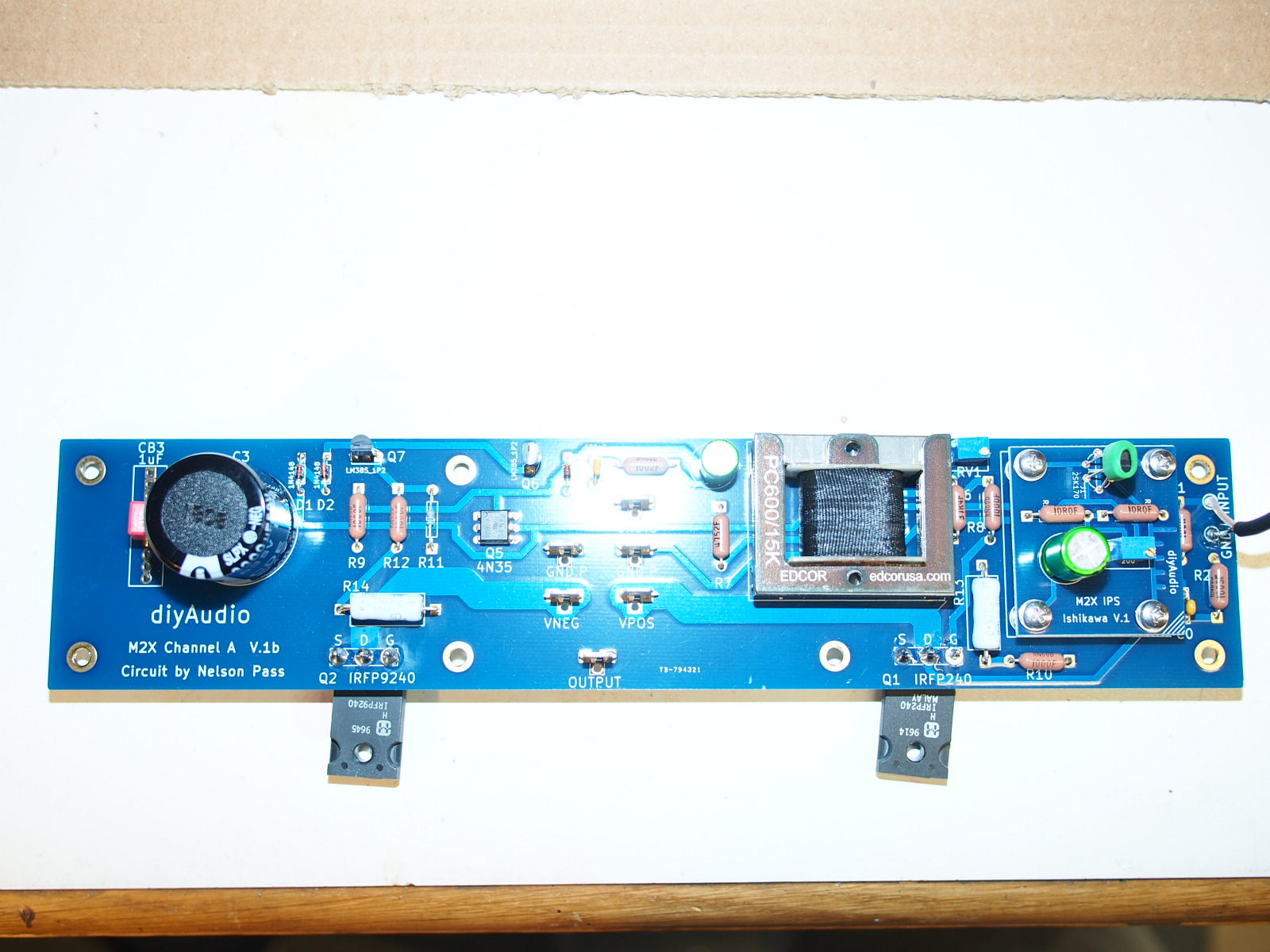

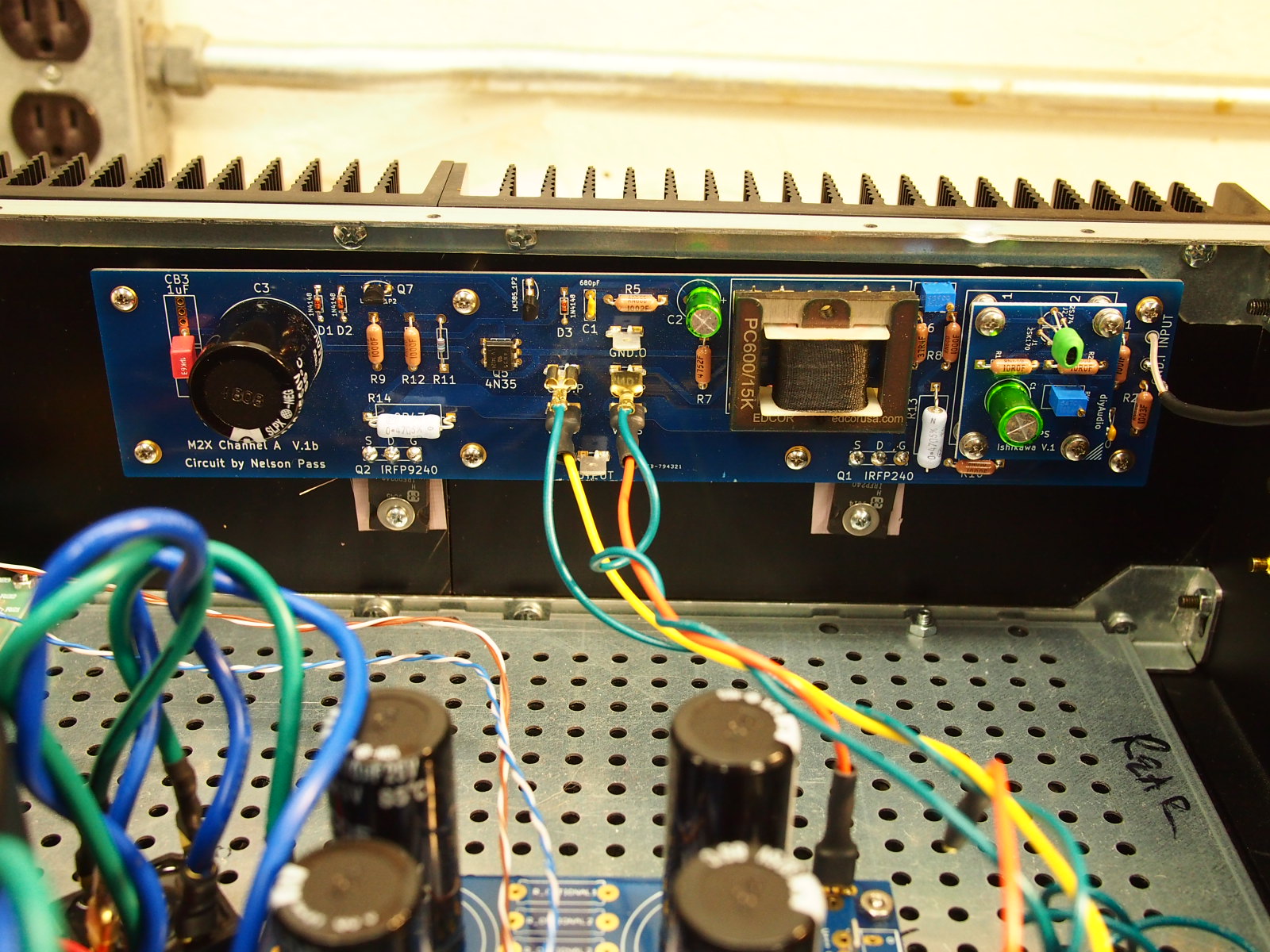

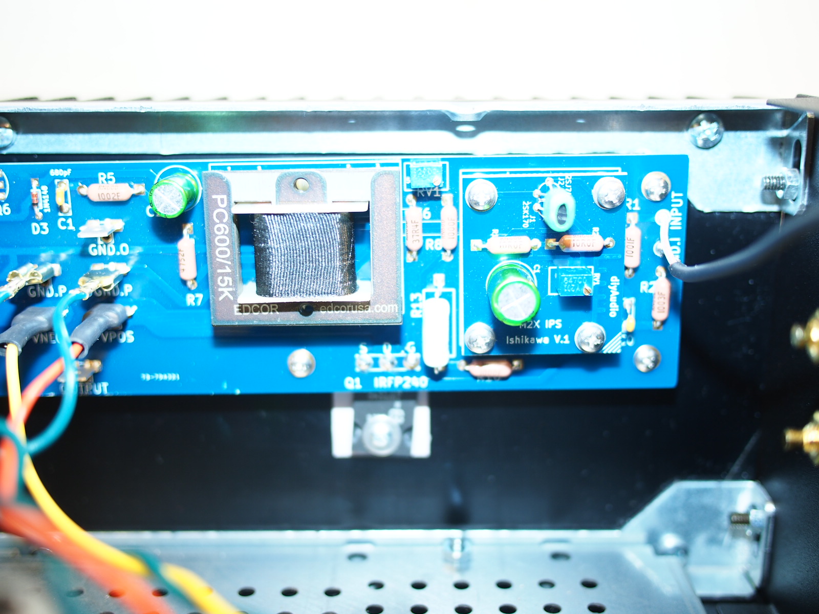

Greetings, I just finished my M2X with Ishikawa boards late today (way overdue). I made the recommended modification and used R6 = 37k and RV1 = 20k. I can't get the offset to zero. The closest I can get is about +5V (both channels). I'm assuming I made some bonehead mistake and it's not a matter of just decreasing R7. I read through about 50 pages of this thread. I haven't started to troubleshoot this but thought I'd be lazy and ask what kind of obvious things I must have screwed up. Thanks for your patience.
5V? Yes, check for errors elsewhere. Stuffing errors are the most common.
Also post a series of well-lit, in-focus photos here. 🙂
photos
Here are some photos. I hope they show something interesting.
I just getting ready to go over each component and verify against schematic.
Well, duh... I put a 37 ohm resistor into R6....
Changing it now.
Great catch! Hope this clears up the issue.
