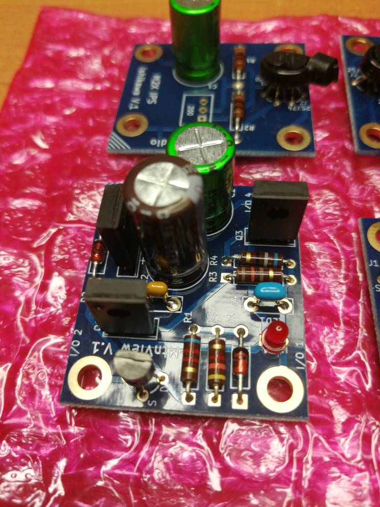

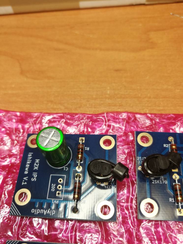

Ischikawa and Mountain View are ready too. Can I run and check my daughter's cards without ampboards and without the regulated power supply? I only have a power supply for M2x and DMM. I saw a nicely described diagram for Norwood, can someone add it to other cards?

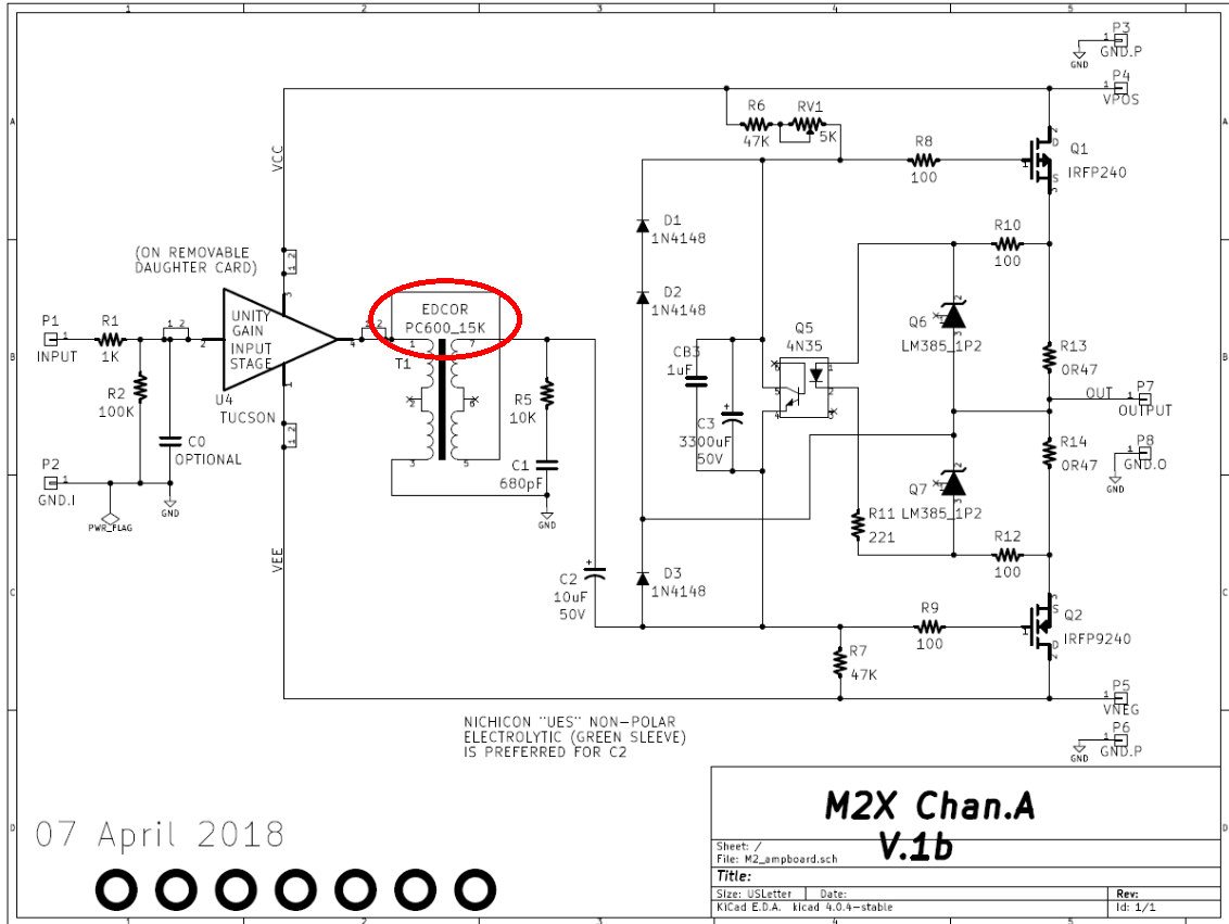

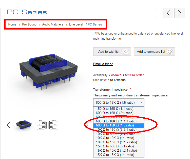

I'm not entirely sure of what Edcor transformer series is being used in the M2X. I'm looking at the Edcor website and I believe it is the "TPC Matcher Series" (just not mounted on the Edcor-supplied PC board) or is it the the "PC Series" which comes unmounted?
I ask because if I look at the M2X schematic vs. the schematics on Edcor's website, the pin numbers/phase relationships are presented differently.
The TPC Matcher Series shows Pins 1 and 7 being in phase, while the PC Series shows Pins 1 and 5 being in phase. I note that on the M2X schematic, NO phase "dots" are indicated for the transformer - so I'm confused.
Can somebody please help? Thanks!

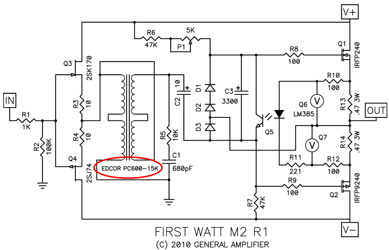

Besides this M2x thread, there is another resource here on diyAudio. It's a thread about the commercial product M2 which was sold by FirstWatt. Nelson Pass created the thread and attached his M2 schematic to post #1 of that thread.
Official M2 schematic
Nelson Pass's M2 schematic is the first attachment below. I've included some other attachments, hoping to make clear which Edcor transformer is used in the M2 and the M2x.
_
