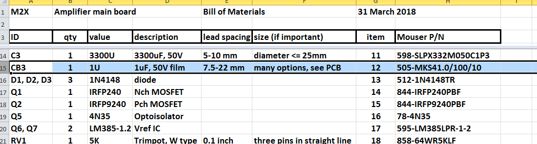

Look closely, CB3 is on the M2x schematic {created by me} but it is not present on the official M2 schematic {created by Nelson Pass}
Unlike other folks, I actually do know with absolute certainty, why CB3 is on the M2x schematic. I know exactly why I put it there.
CB3 is on the M2x schematic (and on the M2x PCB in the diyAudio Store, which I laid out) to give DIYers the option, but not the obligation, to connect a film capacitor in parallel with electrolytic capacitor C3. Stuff and solder CB3 if you wish, leave it out if you wish. Your decision, dear builder. All I have done is give you the option.
Nelson Pass apparently didn't think CB3 was necessary. He didn't include it in his schematic. And I myself don't think it is necessary. But I do think: maybe it is fun. And maybe it will soothe any outbreaks of audiophilia nervosa, the irrational fear that you haven't spent enough money buying Premium Parts. Install CB3 or not, it's your call.
I included CB3 in my own M2x build even though I don't think it is necessary. Why? So it would be present in the photographs of my M2x; and because of this, I wouldn't have to answer a hundred nervous questions "why don't I see CB3 on your boards?"
The specific capacitor I purchased and installed, is the one called out in the M2x Build Of Materials, screen capture image below.

Mark, is that also why you have the 4 holes under C3 in case someone wants to use a small cap under the board?
I had a Dayton Audio Grade 1uF MPC laying in a box from a crossover upgrade, so I soldered it in. I was temped to solder a socket in to try some different stuff and see if I could hear any dif. I also have REW and XTC, so I can do some testing if I get round to it.

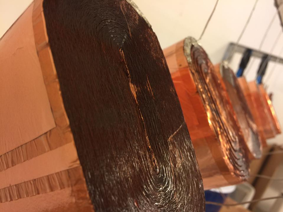

Yes, copper foil and silver foil caps are many times more expensive than alu foil. Alu foil is the perfect material for caps as alu foil oxidizes naturally. Alu foil caps are also physical smaller (at least those I have compared).
normal caps have a micron vaporizated copper not foil,plus as you know a caps is a microphon...

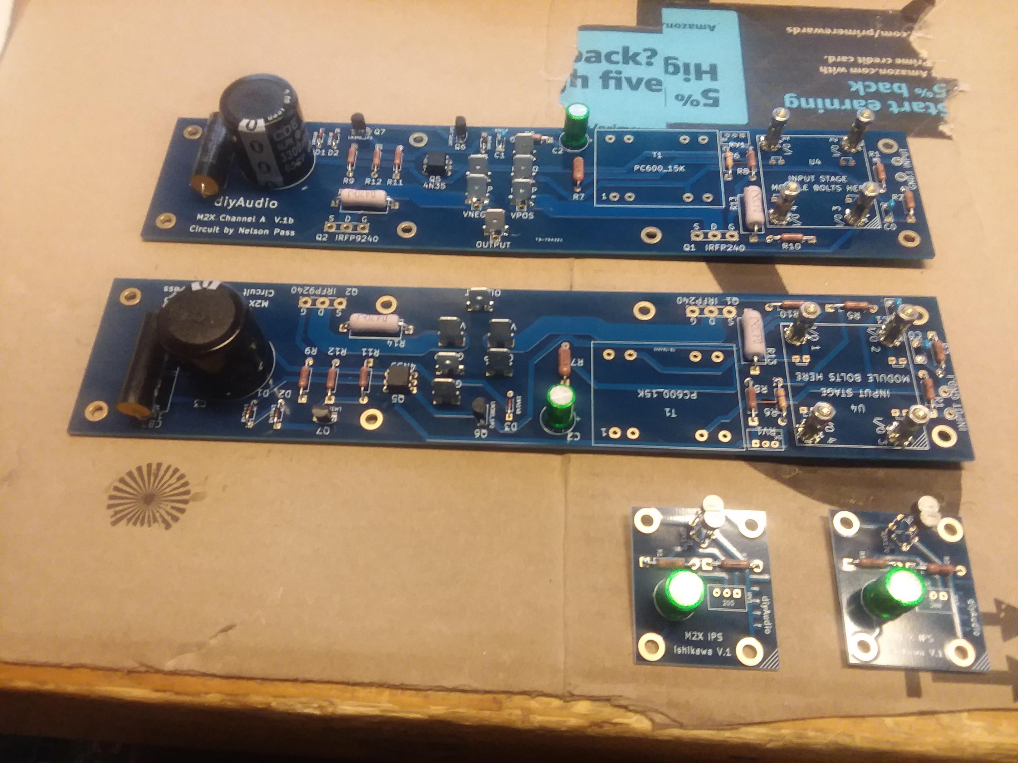

I think I remember seeing a set of M2 PCBs a couple years ago, which were laid out in such a way that the builder had the option to install either the Edcor transformer (as here), or another transformer by Jensen, or a third transformer by Lundahl, or a fourth transformer by Cinemag. This provided the builder an opportunity to re-create the listening tests which Nelson Pass performed before finalizing and publicly releasing the M2: Which transformer gives the most pleasing results, to you ?
I seem to recall that NP said he himself preferred the Cinemag, but a large majority of his trusted listeners preferred the Edcor, strongly, and that's why the Edcor got shipped in the final product. But, who knows, maybe some listeners will find that swapping out the transformer yields amazing sonic improvement vs. the Edcor. To their ears. The good news is, it's a comparatively cheap experiment to try. Most of the cost of an M2 or M2x is in the heatsinks, chassis, power transformer, and power supply. The amp channel PCBs & parts are comparatively inexpensive.
Sorry that I don't remember who created and displayed those PCBs, or whether they were for sale, or what they cost. Laying out an option-rich amp channel PCB yourself would be a viable alternative; it's a large roomy board with very few components and loads of space between them. You could even put the transformer on is own daughter card, if you wished; that would transfer the pinout-scramble from the amp channel PCB to the daughter card, and it would also enable builders to fabricate a mu-metal shield box which completely enclosed the transformer including its bottom side. With daughter cards, swapping transformers would take only 5 minutes; you could audition all four different possibilities in less than an hour.
You'd probably want to locate the transformer's Zobel network (R5-C1 in the M2x schematic) on the daughter card. That way each transformer gets its own unique and optimum Zobel. You don't need to find a "compromise" Zobel that sorta works okay with all four transformers.

I've really enjoyed trying several of the alternate IPS boards that come with the M2x kit, and have even tried some new flavors and variations of my own. Since this is all in the name of good fun, why not?
