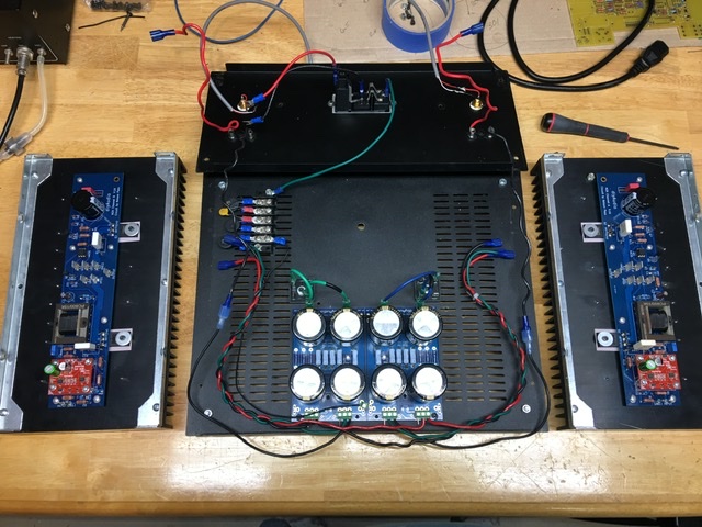

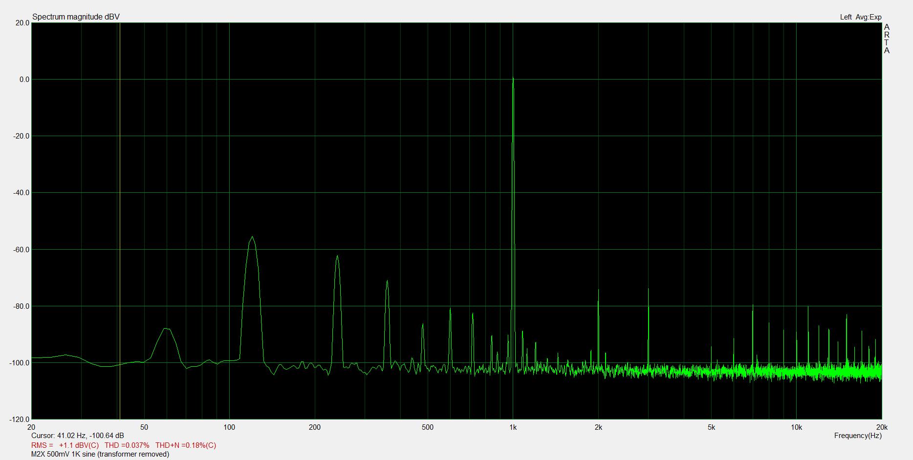

I tried shorting the inputs at the M2X board, moving speaker ground to the PS board, and shielding the signal transformer with Mu metal. None of these made much change to the noise I hear at the speaker.
Next step is to install some larger capacitors in the PS.

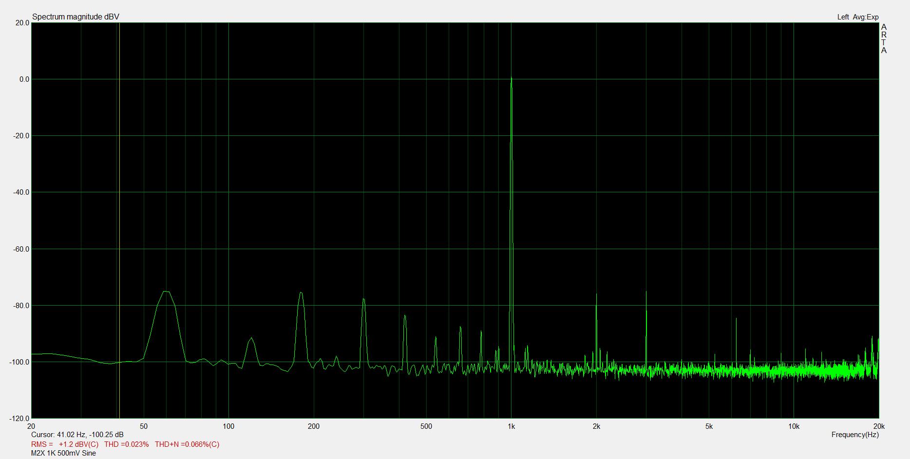

This is what it looks like on the spectrum analyzer (1K 500mV Sine).

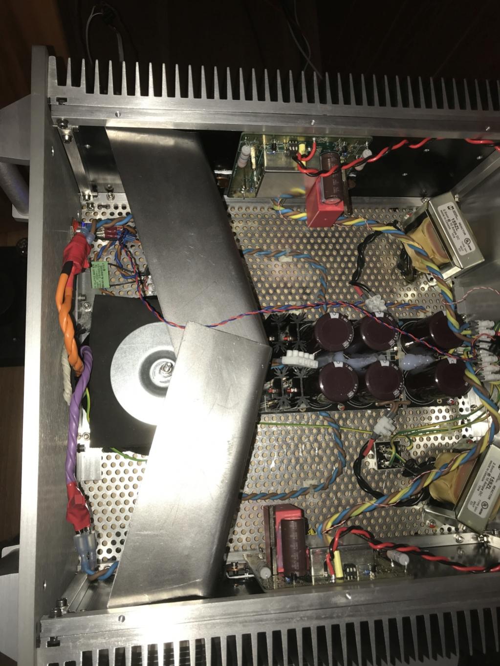

Transformer coupling. Not PSU DC rail ripple; larger capacitors most likely won't help.
I take this from years of reading John Atkinson's measurements at Stereophile, where he always analyzed that mains frequency and its odd harmonics (3rd, 5th, ...) stem from magnetic coupling with the power transformer. :)
Rotate power transformer, re-orient it (mounting vertically, e.g.), or try to put a steel shield around the mains transformer. (steel type has to be ferro-magnetic, so attracted by a magnet).
Hope this would help,
best regards,
Claas
P.S.: attached a picture how my M2 looks like - that helped, along with rotating the transformer for minimum noise ...

I don't know Kevin, it looks rather strange.
I was expecting to see a linear reduction in the entire spectrum.
Your 50 Hz fundamental is lower, but its harmonics are higher or stay the same.
Similar things with your 1 kHz harmonics.
Something in your PSU is causing this big non-linearity I think.
I'm sure someone more knowledgeable than me with be able to decipher the puzzle.
What do you see if you measure just the PSU with some resistive load?

I've been trying to reduce the amp down the it's simplest form. I removed the fancy diodes I was using and replaced them with a standard rectifier block. I removed the input transformer which I built into this amp. I'll leave the transformer out of the case until there is progress on other fronts.
When I originally built the amp and on first turn on there were mistakes with one optocoupler pin not being inserted in it's socket, resulting in the source resistors getting very toasty. wondering if that event is somehow linked to what's going on now>

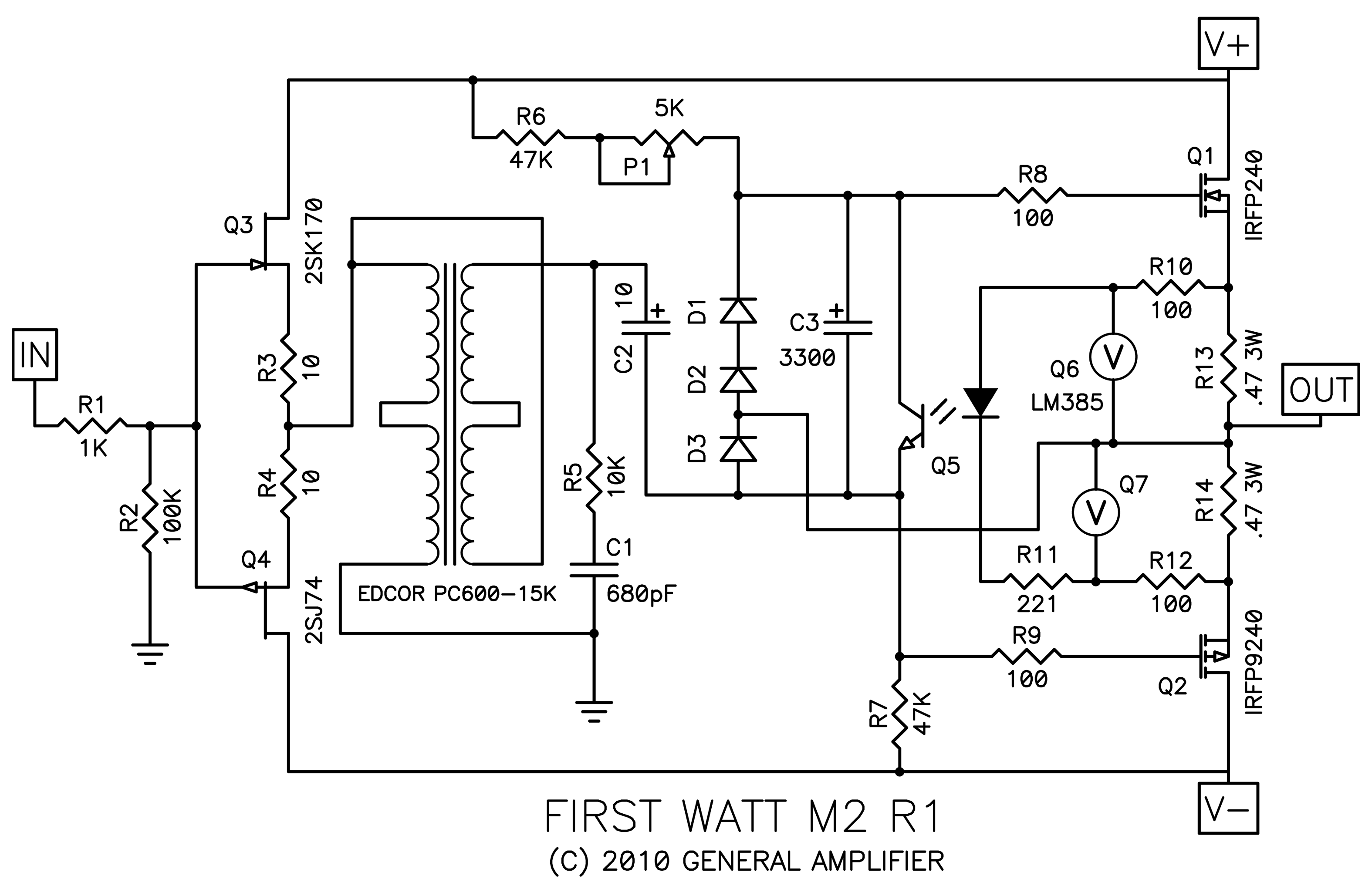

the other question:
from the original schematic, connect the junction between R1 & R2 directly to the positive of C2.
of course you have to find a way to break the link (traces) to the buffer and from the Edcor.
might be easier to build a small cct of R1 & R2 on a piece of proto board
and connects its output to C2.
below is the schematic for your reference
keep in mind I have assembled but not tested my M2 yet, so you are far ahead of me.

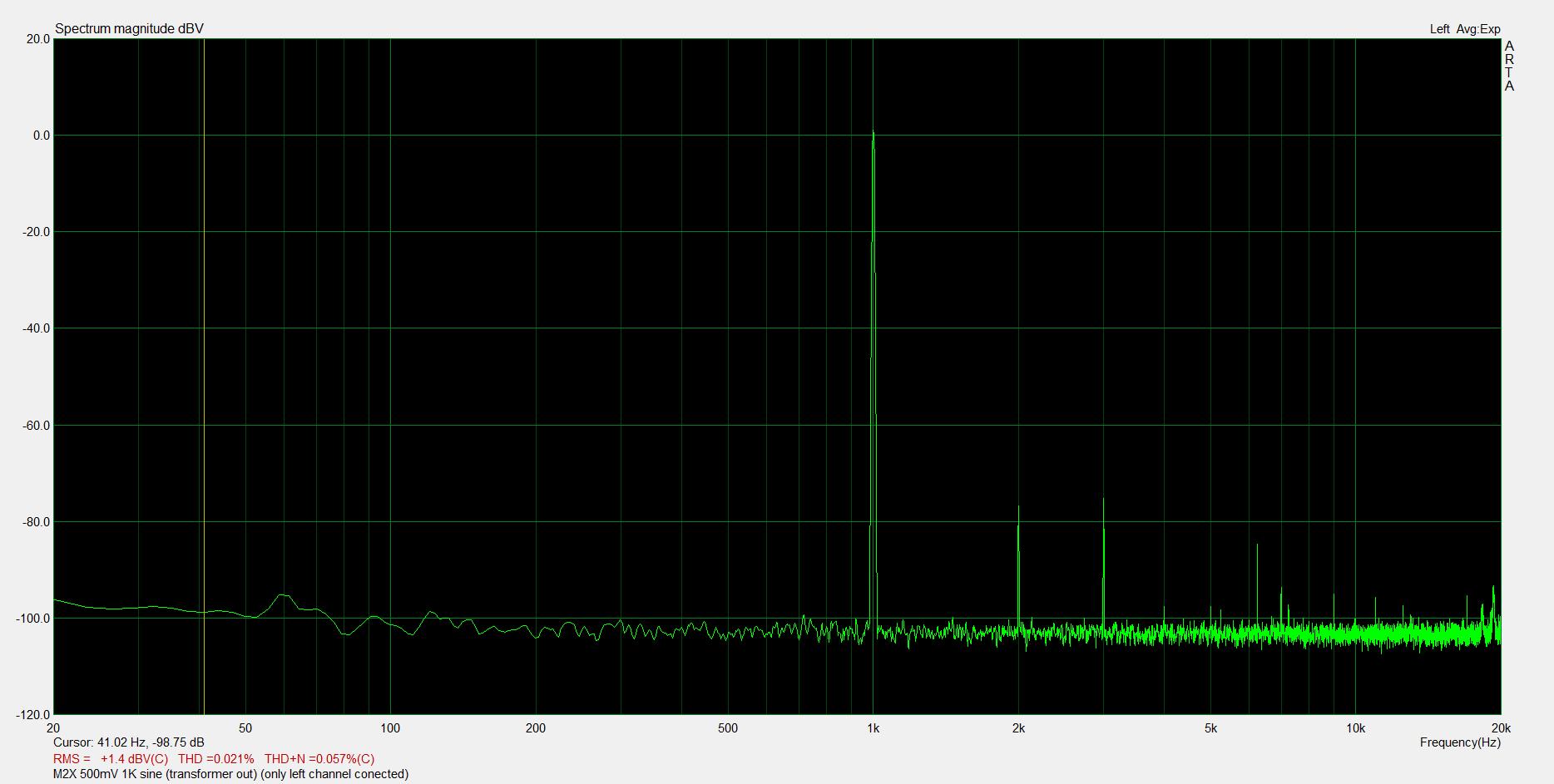

Wow, big improvement.
Is the trafo back in the case or still outside?

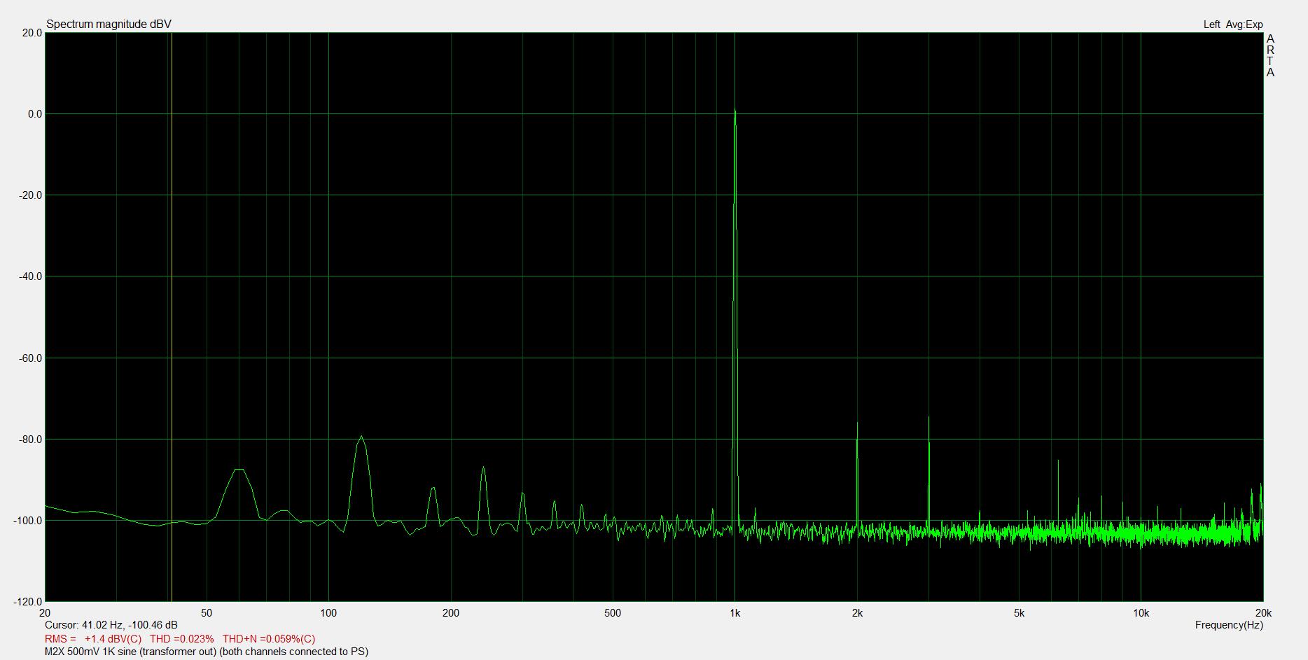

Still outside. If you look at the bottom right corner of the spectrum analyzer I put notes about the configuration.
Here's the spectrum only the right channel connected to PS:
And then both channels connected to PS again:
I added a grounding wire towards the back end of the PS board, this seemed to help some, but still not right.

Kevin,
I can not figure that one for you but I think you are not using RV1 for what its role is - offset adjustment.
There must be a better way to suppress that 120 Hz spike.
Maybe you can try a Cap Multiplier, like in Zen V4 or FW F3.
It will eat 4 volts from your supply and it has to be done for the positive and negative rails but I think is worth a try.
