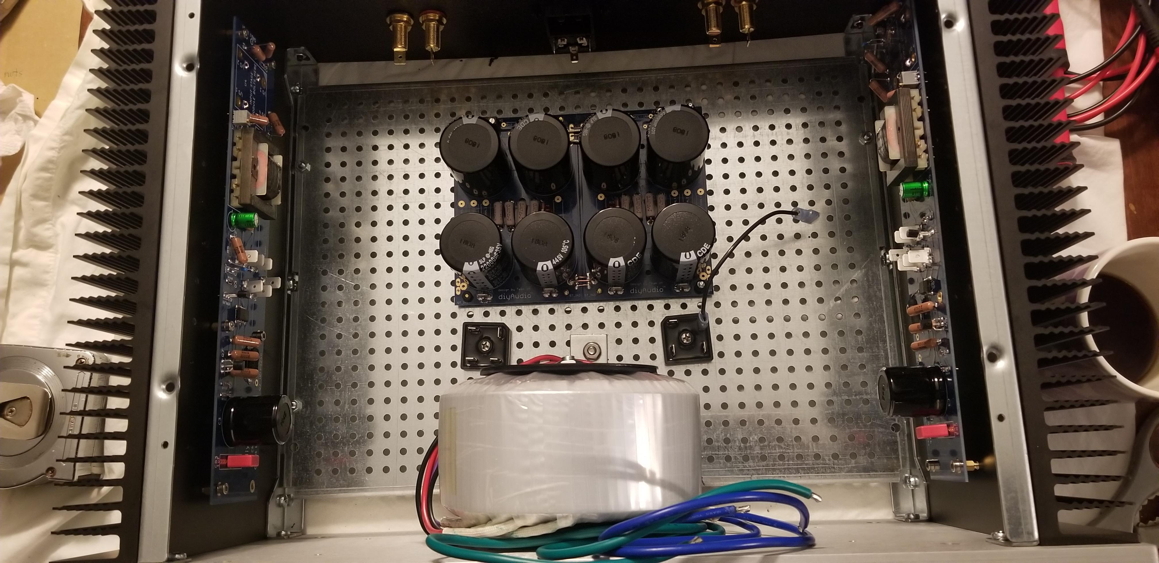

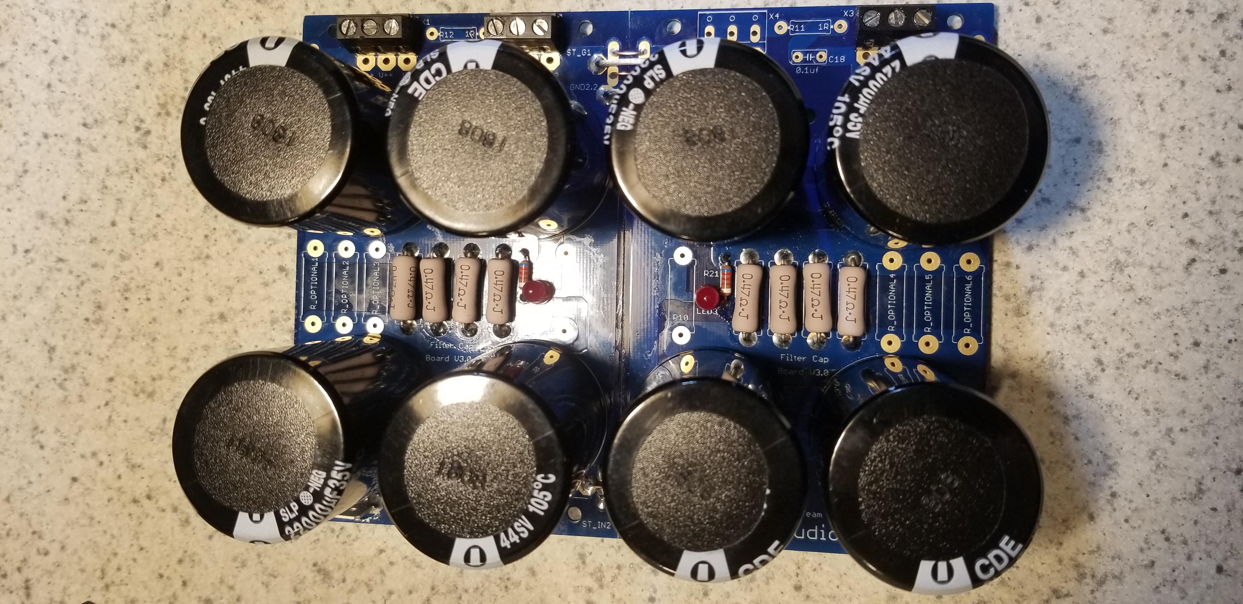

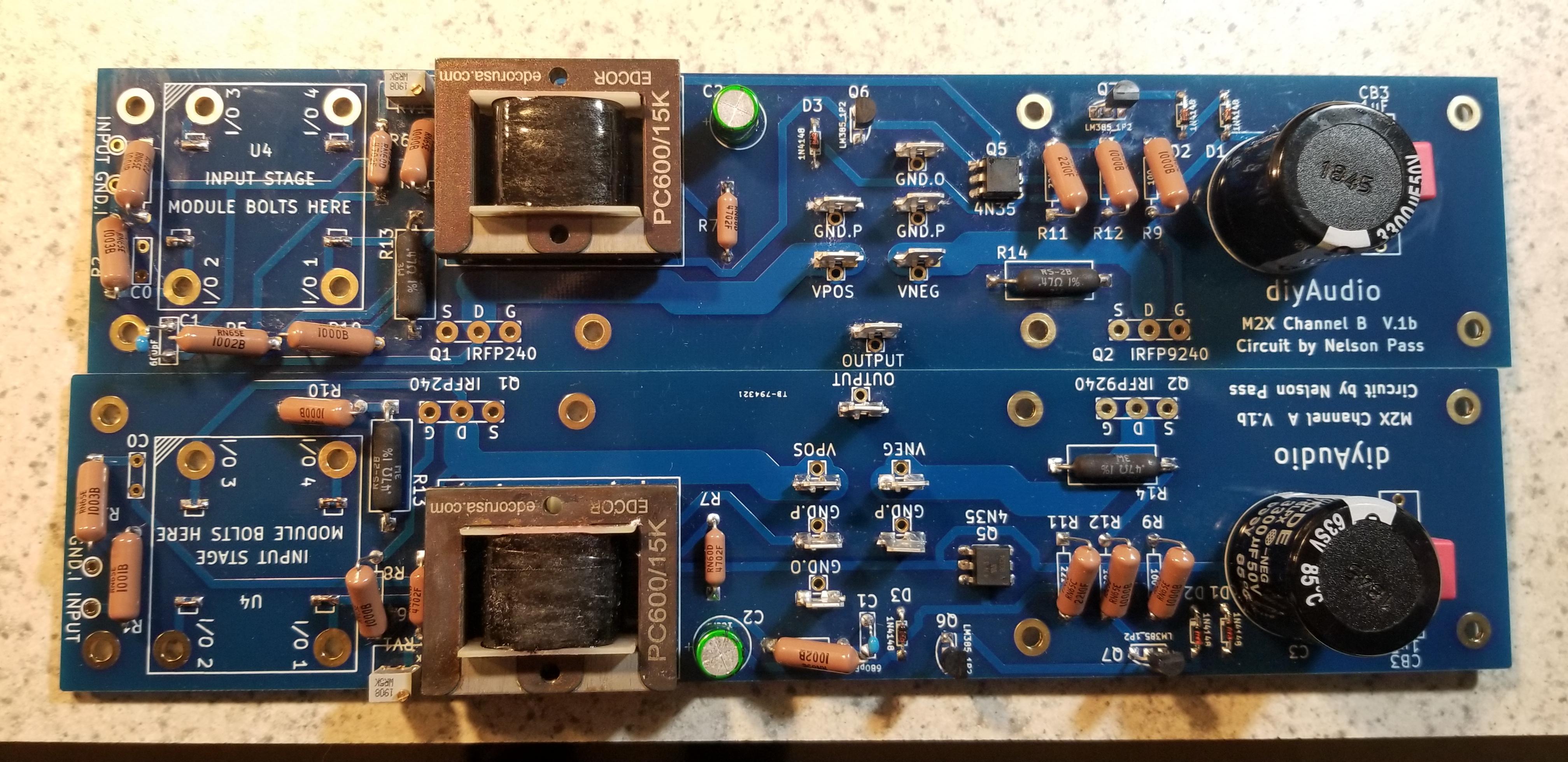

Howzit everyone. This is as far as I can get for now. I didn't order all that is needed. Oh well....I was home on vacation and I'm going back to work for 3 months and unfortunately I can't bring my hobby with me.
I need minor items, just a few things that I want to order through Mouser.
What you see in the chassis is all loosely bolted for temp just for storage.. Please fill free to critic and please advise as necessary. I appreciate the support from this great community. I'll keep up the reading in these posts on DiyAudio.
JJ
JJ
