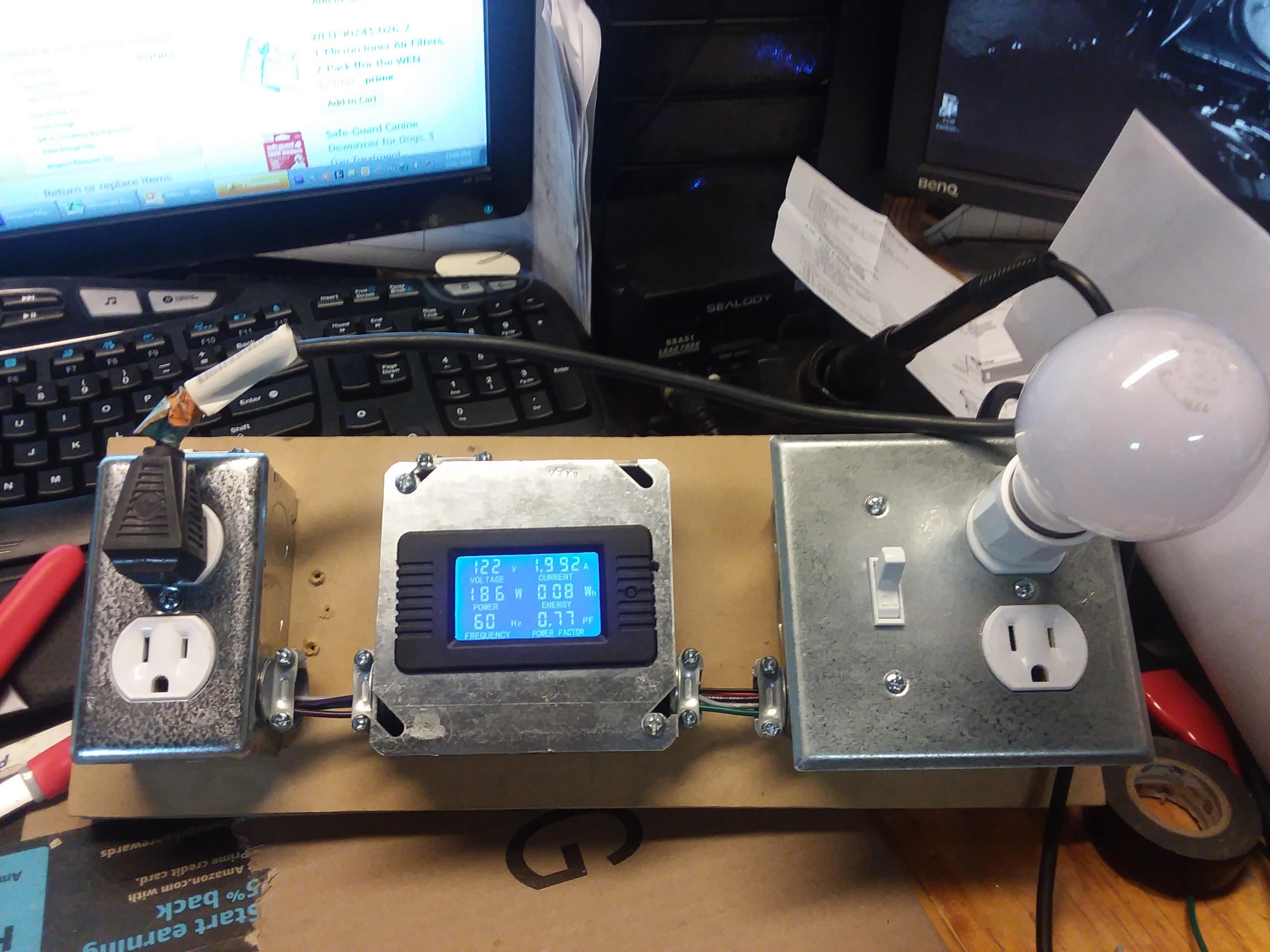

Waiting on the Edcors and some power supply stuff, I had the chance to make this today:
The reading are of the J2... It's wired, so to measure off both sides, the left at full mains and both controlled by the switch.

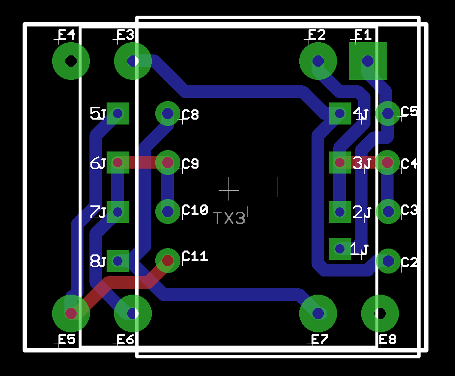

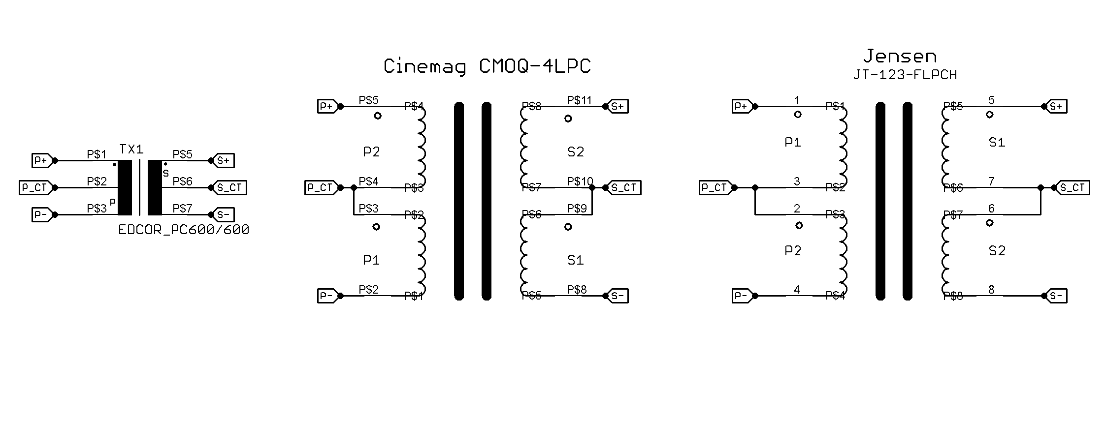

I think I remember seeing a set of M2 PCBs a couple years ago, which were laid out in such a way that the builder had the option to install either the Edcor transformer (as here), or another transformer by Jensen, or a third transformer by Lundahl, or a fourth transformer by Cinemag. This provided the builder an opportunity to re-create the listening tests which Nelson Pass performed before finalizing and publicly releasing the M2: Which transformer gives the most pleasing results, to you ?
[schnipp]
Sorry that I don't remember who created and displayed those PCBs, or whether they were for sale, or what they cost. Laying out an option-rich amp channel PCB yourself would be a viable alternative; it's a large roomy board with very few components and loads of space between them. You could even put the transformer on is own daughter card, if you wished; that would transfer the pinout-scramble from the amp channel PCB to the daughter card, and it would also enable builders to fabricate a mu-metal shield box which completely enclosed the transformer including its bottom side. With daughter cards, swapping transformers would take only 5 minutes; you could audition all four different possibilities in less than an hour.
You'd probably want to locate the transformer's Zobel network (R5-C1 in the M2x schematic) on the daughter card. That way each transformer gets its own unique and optimum Zobel. You don't need to find a "compromise" Zobel that sorta works okay with all four transformers.
Mark, I'm 99% positive it was teabag and it was his F6 convertible you are thinking of here diyAudio - Tea-Bag a 1/4 way down the page there is the F6 convertible with the daughter cards for different transformers.
Hmm, that may be what I once saw, but I sure don't remember any white PCBs. M2 builders take note: enormous flexibility and multitudes of options are available to those who create their own PCB layouts.
An excellent demonstration of " ... that would transfer the pinout-scramble from the amp channel PCB to the daughter card"

cinemag?
Anyone know what type and model cinemag would be used in place of the Edcors for the M2X?

see in first post of Babelfish M25/Sissy SIT tips and tricks thread
though , there are all classic repeaters (so called 600R:600R with CT in primary) , resulting in slightly lower gain than you are getting with 600R:15K
repeaters, as connected in mentioned amps, are giving 4V/V , while with 600R:15K in M2 - gain is 6V/V
