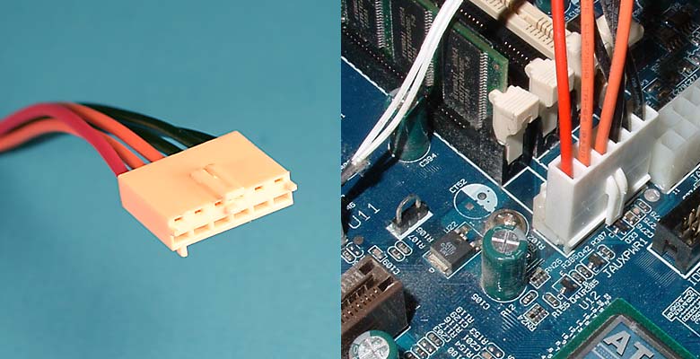

For anyone interested in making their own capacitor sockets, I found that PC fan connectors work brilliantly:
Just cut them off any old fan, or look up "Multi Fan Connector" in Google Shopping - you should be able to get a nice multi-fan connector for less than £3 off eBay (inc. shipping) and it will yield four sockets.
They are the perfect size for 3-pin voltage regulators, TO-220 packaging diodes (such as MUR860 or MSR860), small capacitors and many, many other things. The holes are actually wide enough to accept most bigger capacitor leads too - I even managed to fit in a BG STD 1000/50 without effort (although the leads have to be long enough).
For bigger size capacitors though, I recommend this:
It is an "ATX Aux" power connector - obsolete now, but older PC power supplies should still have it (a Chieftec HPC-300 I found at the bottom of my cupboard did).
It accepts comfortably and securely virtually any conceivable device that has wire leads.
Installing sockets makes comparing stuff so easy. In the past, I have not done much comparing (pretty much as little as I could get away with), mainly because it was too much time/effort to solder stuff over and over. But with sockets, it's truly a 10-second job: power off, take item 1 out, plug item 2 in, power on. Brilliant.
You only have to keep reminding yourself not to swap things too often or you'll lose track of the changes 😉
