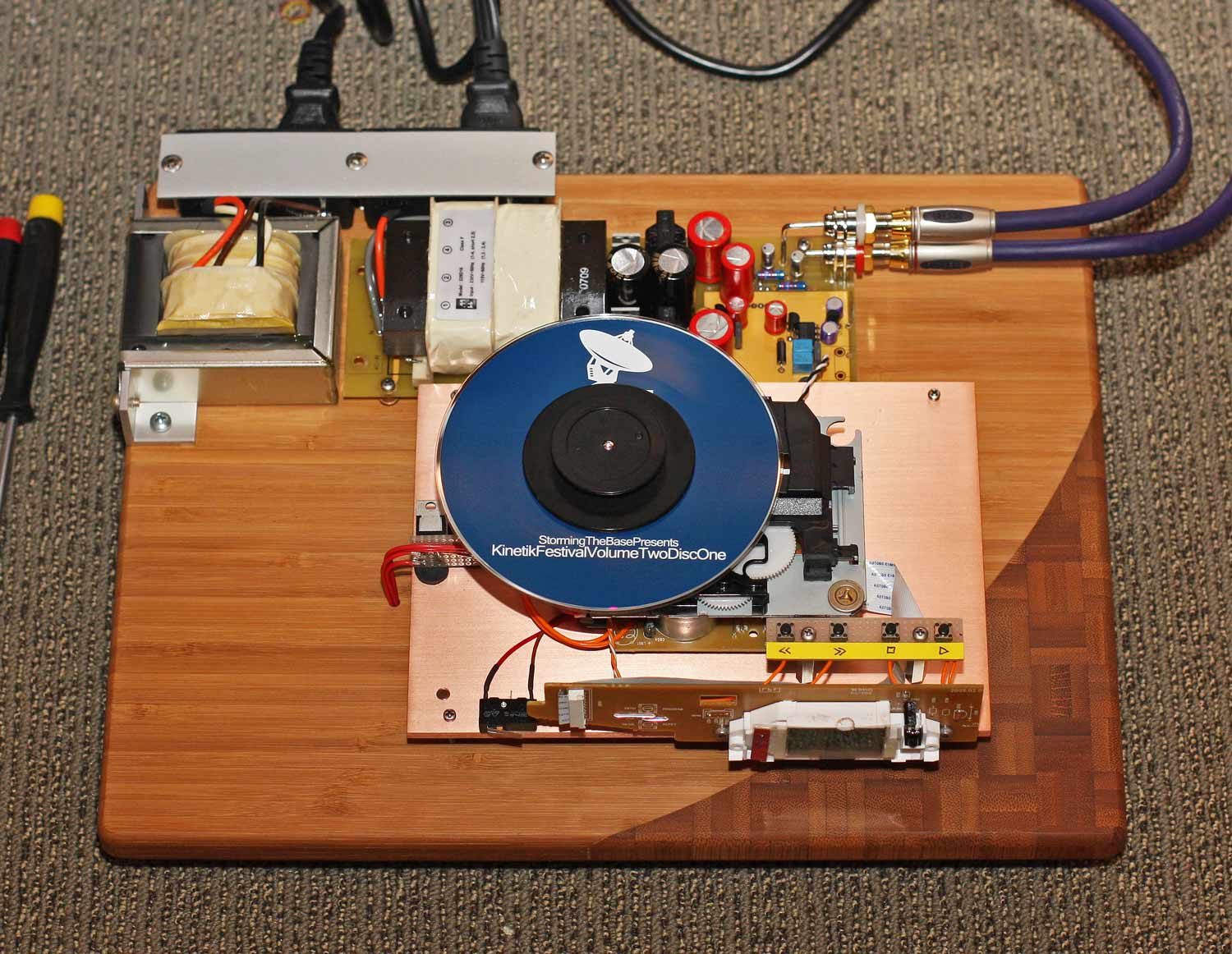

I don't see a reason not to place 7808 with the transport.
External PS box should only contain rectifiers and transformer.
An umbilical cable that came with my CEC TL0 is at least 6ft long.
Does this transport have easy access to I2S?
if this has been answered, forgive me.
I see you have the DAC next to the transport which makes me think this could be an easy implementation of the mysterious I2S.
What do you think?
What do you think?

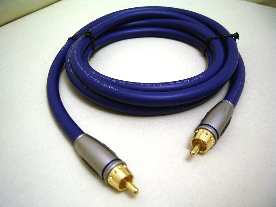

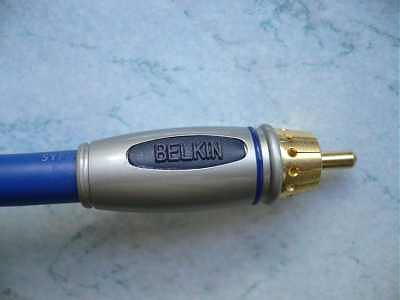

As to digital interconnect, I'm using Belkin Synapse. I learned about it from goodsoundclub.com forum and this is what Romy says about the cable:
"Belkin in 90s produced a line of audio cables: Bronze, Silver, Gold, Platinum. Yes, it was Belkin - the company that does cheap computer stuff. Among all this cables there was Platinum Synopsis (cost $24) - an ugly blue 75Ohn digital cable. This cable sonically is much more interesting then any other S/PDIF cables, at least that I have tried, and it was quite a large number of cables tried for a person who claims to be a normal.
In 2002 Belkin introduced a new revision of the Platinum Synopsis Digital - it was black cable with molded terminator - that Platinum Synopsis was bad sounding cable. In end of the 2002 I spoke with Belkin and they informed me that the old Blue cable is not longer in production and there were only 200 of them left in their inventory. Soon those cables were gone and nowadays it is impossible to found a record of the Blue Platinum Synopsis Digital (#F8C310-03-PLT) when you talk with Belkin support people.
The sonic magnificence of the cable was discovered by a NY friend of mine why purely accidentally used his computer cable in his DAC and was surprised by the result. When I tried it I sold immodestly my digital cables and never even tried anything else since then (I had Dominus Digital at that time). BTW, at that time I bought other Belkin Platinum Series cables - they turned out to be nothing special"
It's my current reference and I don't think I'll ever switch to anything else either 😉

Thank you for sharing Peter. I just ordered my jvc. Is it possible to slave the transport to a DAC or seperate master clock?
Did you wire in a power switch? Just curious.
Thanks,
JG
I asked him via PM earlier. He did not.
Yes, What I describe in a post#12 here: http://www.diyaudio.com/forums/audio-sector/160373-cd-transport.html#post2069003 is slaving the transport to a clock. This particular clock was built using Citizen crystal, but you can use any other 4 pin clock. Mount the clock with a DAC and run separate wire to a transport.

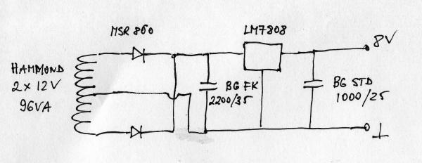

I recently tried slightly different PS enclosure, made out of 3 x 2 aluminum tubing and 2 x 2 angle. The transformer type is the same I'm using with my DACs (229D20)
Hi Peter,
I try to understand how you wired the rectifiers to the transformer. Did you take the parallel secondaries output or the serie output. I wire my tranformer like you I get a dc voltage of 9 volt. Is it ok ? I use 229D16, wich give 16v in serie and 8v in paralell.
Thanks,
The schematic show external PS. Two wires from PS are connected to the pads where choke was. Since BG FK is hard to find these days, I use BG STD with BG N 4.7uF bypass.
If using the BG STD instead of BG FK is the value of the BG N bypass cap important? I was looking around and 4.7uF seems to be hard to find.
