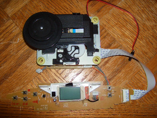

JVC RC EZ-31 for sale
I bought this after reading Peter's postings, but run out of time to persuade project. Now want to sell to whom it may find useful. $75 + shipping. Primarily shipping the transport + display pcb. May (or may not) have more suppy for diyers later this year.
i would like to have it, please PM me your payment method.
