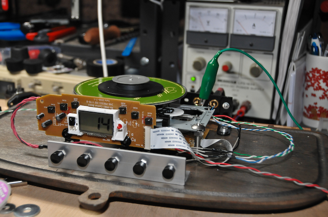

on the bench
Thanks for the advice John M.
Well I had a good weekend 'fiddling with my knobs' as my family call it (bless the little dears!)....
Haven't received any of the Caps I have on order yet, but just with what I found locally it sounds fairly good! Running off my DC bench supply for now (it's a pretty good one I got ridiculously cheap)...
I found out how to fix the noise from the drive itself... turn the music up!
Same principle as dealing with irritating rattles in the car.
Joking aside now, it seems quieter strapped-down to a piece of cast iron griddle, I would like to seperate the mechanism from the boards, but getting the laser sledge stop reed switch in the right place seems like it would be tricky. The switch is fixed to the board as standard
How critical is that switch positioning anyone?
Bill

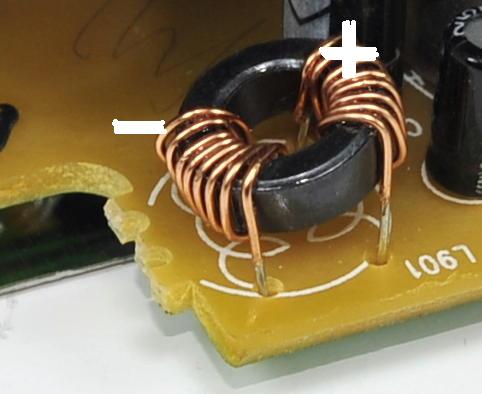

I am just biulding my own shigaclone. Already have a PS according to Peter`s design. I know this may sound silly, but could someone tell me how to connect it to the main transport board? Should it be this way or the other way round? The last thing I would like to do is burn my precious Ez31 🙂
Thanks in advance.
Thanks in advance.
Thanks in advance.
u have got it reversed (wrong way). u need to swop them around.
