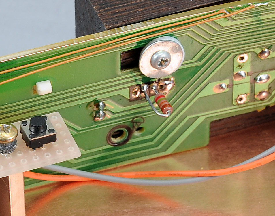

display connection
Hi Peter,
Can't view photos on the forum today for some reason. Do you connect power directly on 10K resistor or to side holes on the black pad? Reading should be 5V...correct? Thanks.
Hi Peter,
When the display board is trimmed like in pics here: http://www.diyaudio.com/forums/audio-sector/160373-cd-transport.html#post2068891 you can use the 4 pads to mount resistor and connect wires there. However, this only works for trimmed display board, otherwise you will damage the chips on main board.
It's best to find out which pads connect to the LED, and solder wire and resistor there, power wire is connected to 10K resistor first. LED is powered from first cap on regulator board (18V or so) , reading after resistor is most likely less than 5V.
Yes. I've trimmed the board and mounted identically to your photo. Just to make sure: from the rear-view of mounted board, I should connect red+ to left pad and the black- to the pad on right of resistor....right? Thanks.

In picture below, I connect red+ to resistor lead on left and black- to pad on right. You can follow the traces to see how they connect to LED
