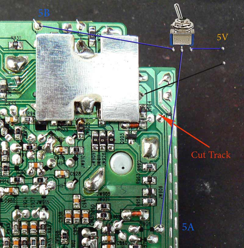

When removing L901, connect the voltage and ground directly to L901 secondary pads, no need for any jumpers.
Best way to feed separate reg 5V is from a separate transformer.
Attachment shows how to connect external 5V supply.
Hi Peter,
What is your technique to cut track...drilling?
Do you solder + onto the large pad near the JW906 label or onto the component itself?

Hi Peter,

i use a sharp knife and cut the track easily.
solder onto the large pad near JW906.
Is this the right pad where the yellow arrow is pointing to ?
today, i just tried supplying 5v to my shigaclone from Twisted Pear Placid shunt regulator. All the magic was gone. I still prefer the single 8v supply. I just don't understand how a simple single 8V supply shared by all the circuits can sound better.
Try feeding the 5V line from a separate transformer. If that doesn't help, then it is possible that the regulator you are using is simply not suitable for Shigaclones...

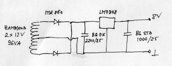

Hello,
I'm thinking about trying the 266p24 which is a dual primary. How did you hook this up to PS? Did you wire in parallel?
Convert it to CT and wire as here:http://www.diyaudio.com/forums/attachments/audio-sector/156187d1264974944-cd-transport-66.jpg
