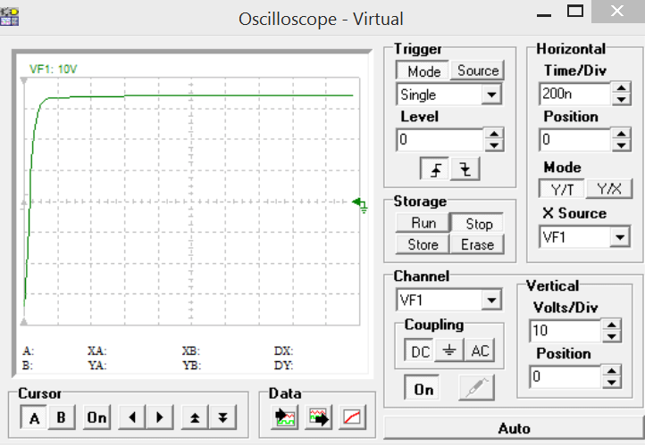

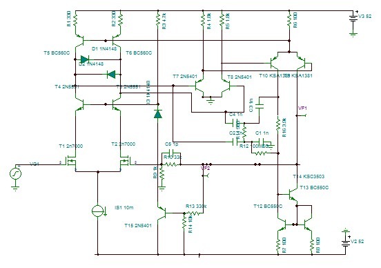

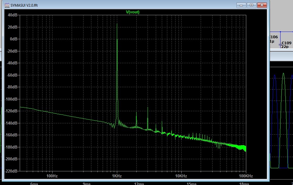

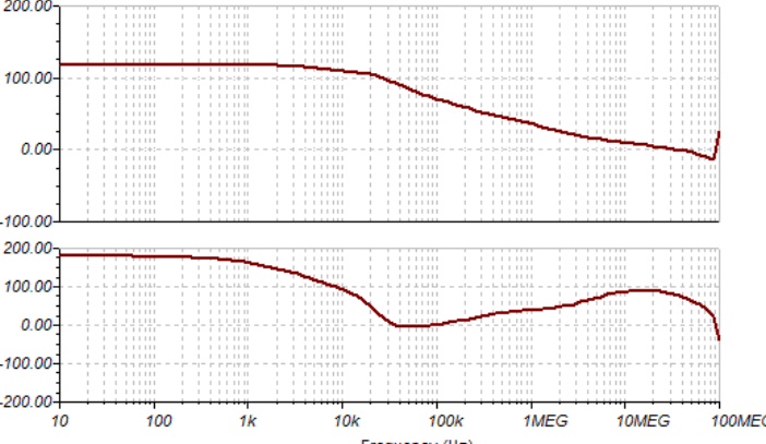

To get very high slew rate, I used the other phase as output because the capacitors on the output were limiting it. Look the fabulous OLG. The saturation slew rate reaches 1000v/us. The distortion is 0.0002% for now.
1000V/us ?? What OPS could do that. Simulation is one thing , real world is another. Present day BJT EFx OPS's have a low 300V/us limit.
This was tested (Slewmaster).

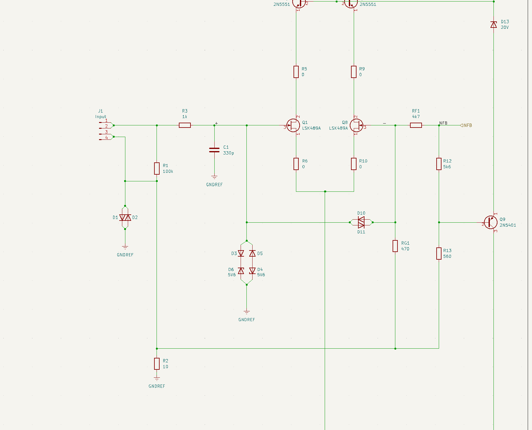

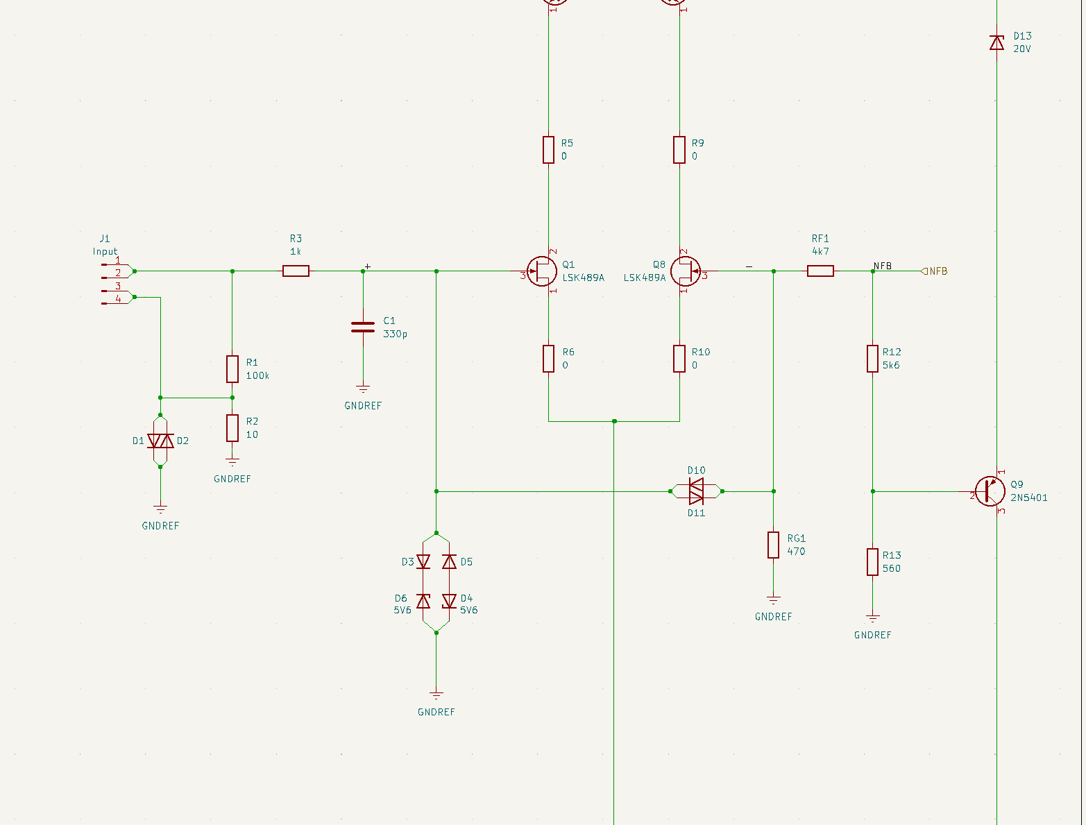

Removing Ground Lift:
Im trying to descide on the ground-lift scheme. Only Input:
Or input and feedback:
My conclusion in neither as I was already planning to use this scheme off the amplifier board. A ground lifter on the input caused problems with the Green Comet Amplifier. One earth loop breaker per channel should be safer and make the input ground lifter redundant.

I have A1360 which has 200Mhz ft VS 150Mhz but on simulator it has lower gain. In fact the NFB@20khz is 104db if fall to 91db with 1360.

Nice , thanks to you ... I also have a crazy high OLG design. I did it with just 2 stages by loading it with current mirrors.
Most amps just have 10db extra at 20K. Wolverine has about 30 , (62db/20K). My new one has 72. 10db more goes a long way.
.5PPM at 20k.

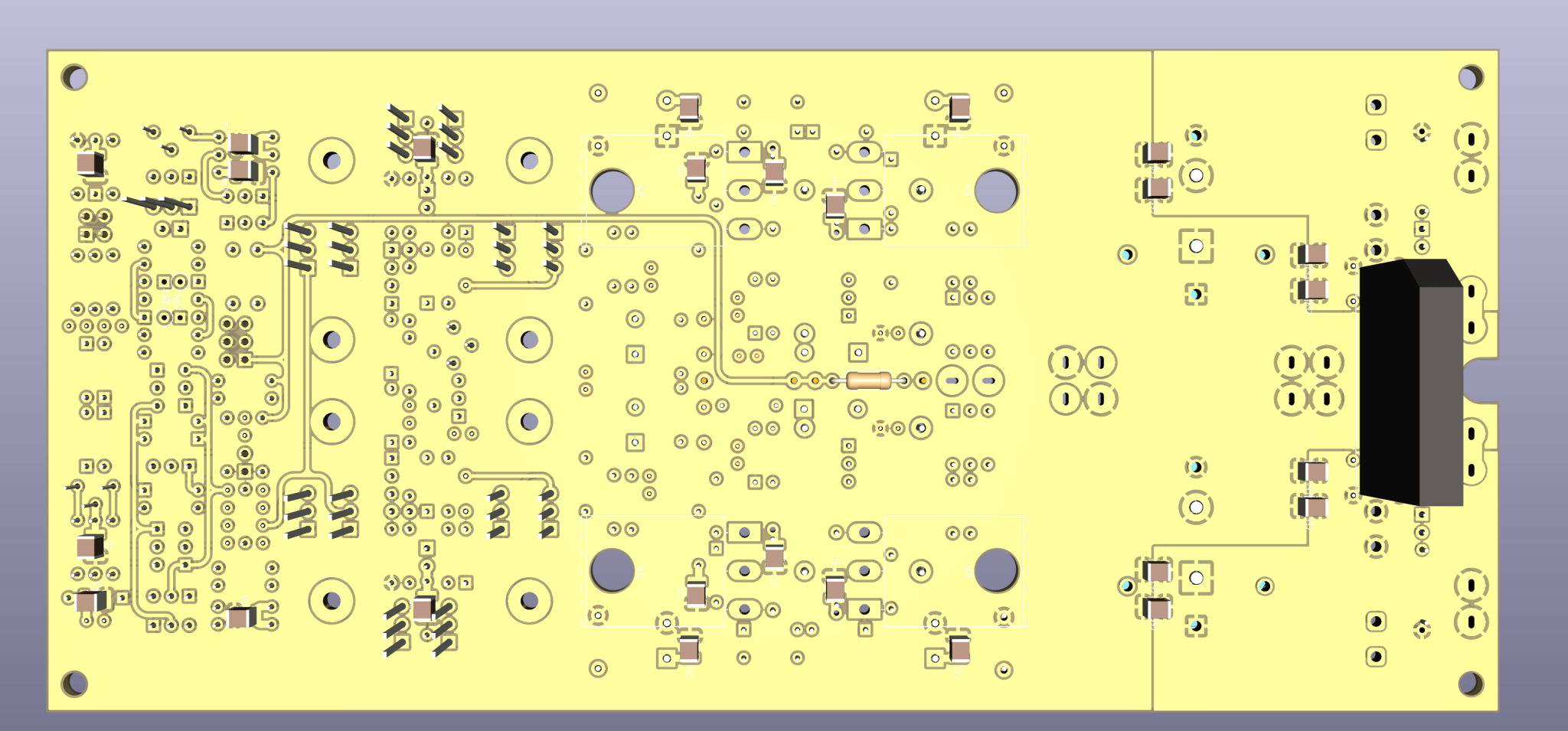

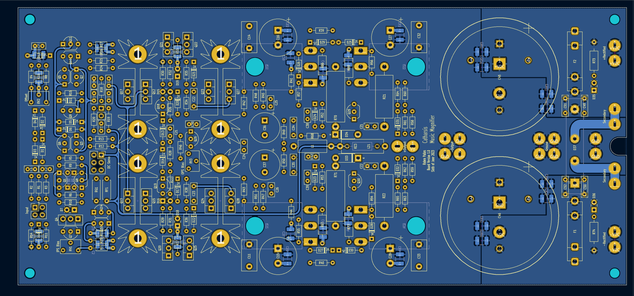

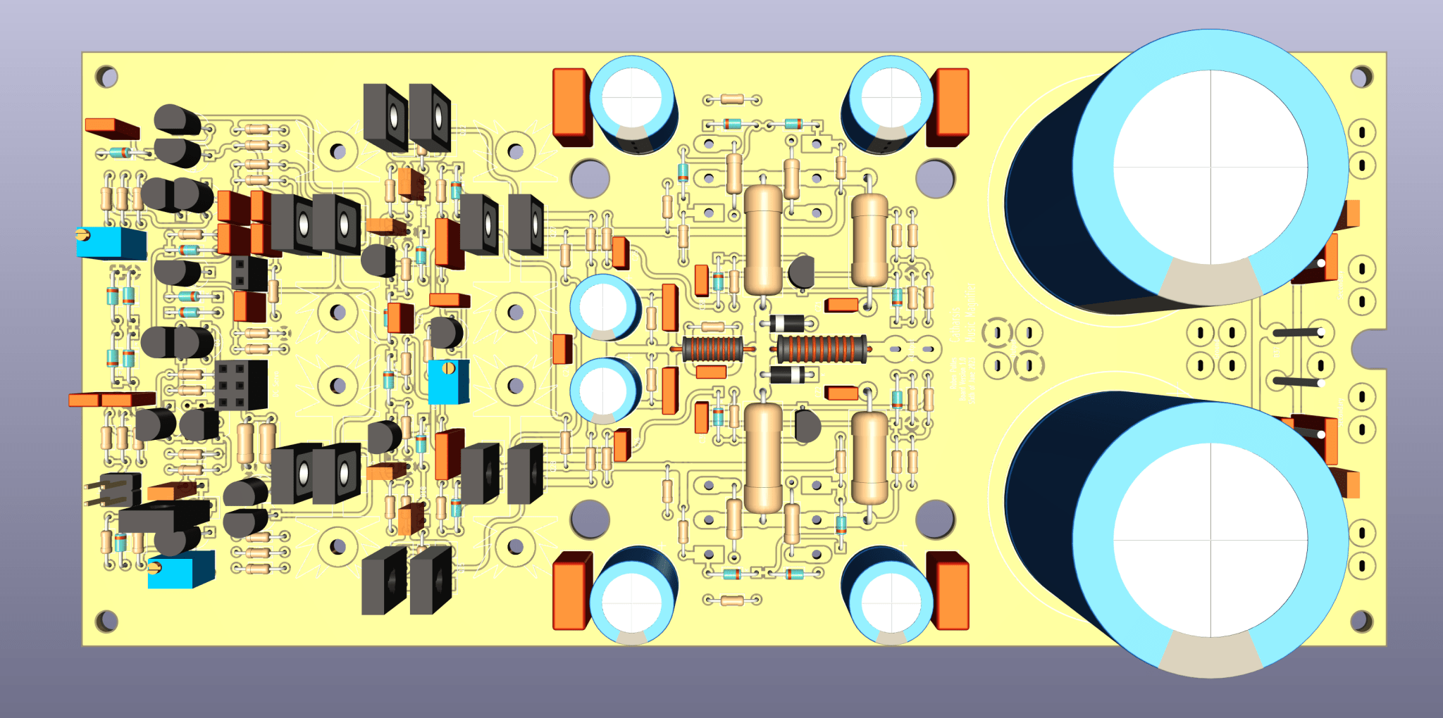

Your layout looks real nice , I see you are HF decoupling (.1uf) your big electro's underneath with SMD. I originally thought to do this on my through-hole
output board , opted to keep it ALL through-hole. Plenty of SMD's on the IPS's , which I intend to keep ALL SMD
I should get some fancy new 3D PCB layout software !
