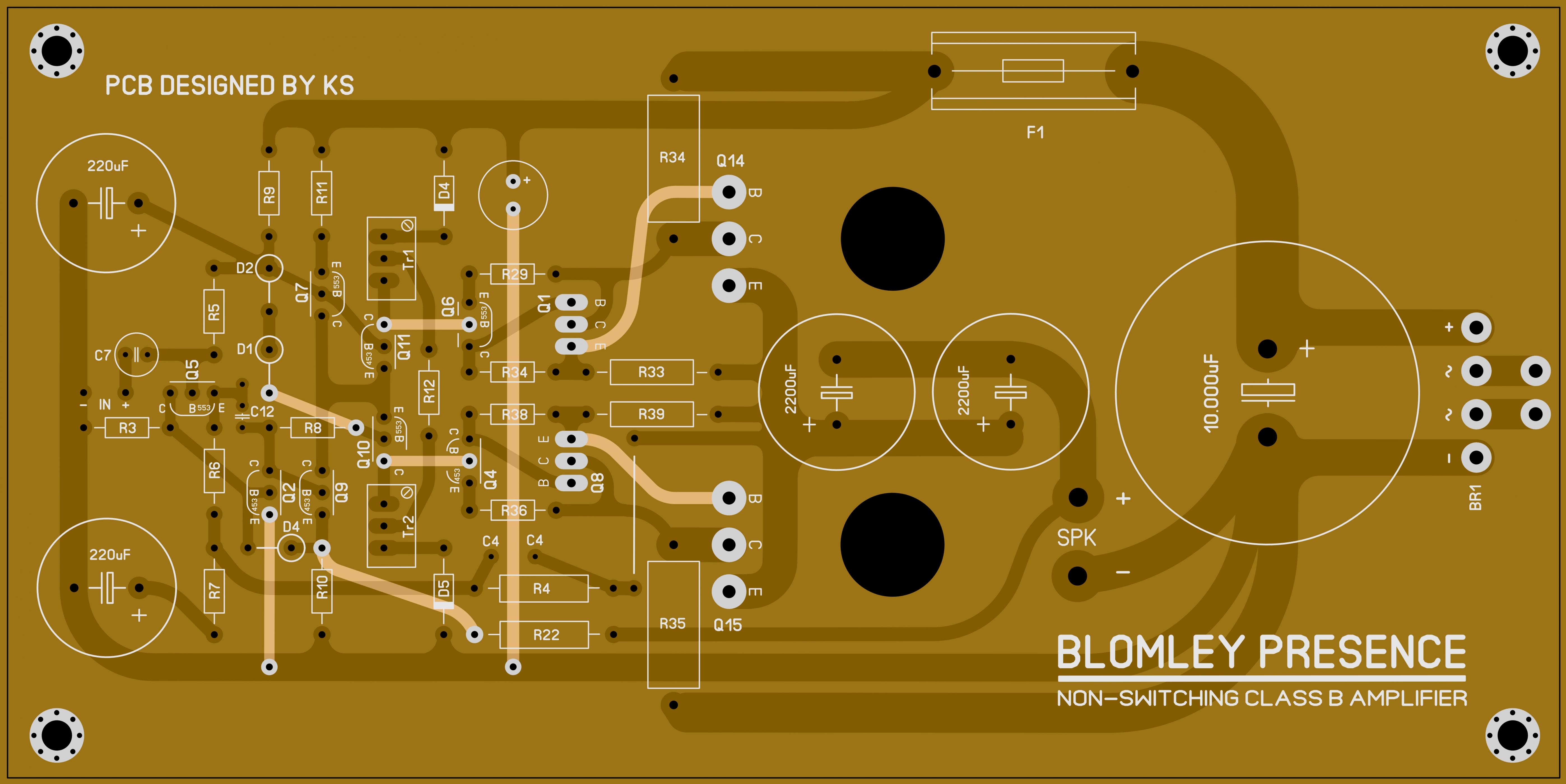

First, thanks for sharing the gerbers and schematic but I'm curious why the schematic you posted labels Q1 and Q8 ztx453 and ztx553 respectively yet also labels the pin order BCE when those parts are only available in CBE. Did you mean to label Q1 and Q8 the TTC / TTA and also what are you using for Q14 and Q15 (and why are the footprints so gigantic)?
While I'm here, I happen to have a +60V supply but how can I resist the beauty of that giant ripple rejection cap -- do you have a favorite bridge rectifier for BR1? Also, by my calculations a 44Vrms transformer? 125VA?

Sorry for the late reply. In positions Q1 and Q8, I designed TO-126 case transistors from the beginning, considering that 20mA is not enough for proper sound. (reason for this has already been discussed above) 60-80mA is optimal, so you need a larger transistor than ZTXs, optionally with a small heat sink. Therefore, the pinout is different. Q14/15 are NJW0281G/NJW0302G.
Bridge rectifier that I used: GBU25KH Diodes Incorporated | Mouser Hungary

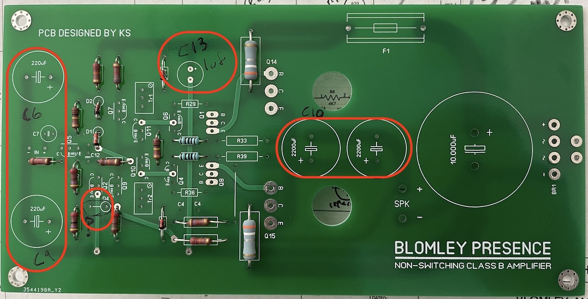

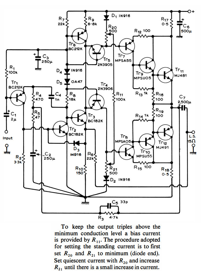

When Blomley says "to minimum" on diode side, does he mean to 0 ohm or to 500 ohm (on the diode side)? I built one but my idle current is fixed at 87.3mA no matter what I turn. I made a mistake somewhere. Building another now. I'm going to set them to what's in the spice settings before I solder them on this one. Also, just to be clear, quiescent current is measured between the collectors of Q14 and Q15 (Blomley's TR11 and TR12), right?
I have a few more questions if @egra or anyone else can help.
1) Do I have C6 and C9 labeled correctly and what is their recommended voltage?
2) The @egra PCB has 2 D4, one of which is not in the @egra schematic. It connects Q2's base to R10. This is D3 in Blomley's schematic and is also a 1N914?
3) Voltage for @egra C13 1uF 100V? This is Blomley's C6 (500uF?).
4) The @egra C10 is Blomley's C7 (2500uF) - also curious about recommended min voltage for these.
This is technically my second power amp build ever and the last was in 2003. Thank you for your patience with my very basic questions 😱
