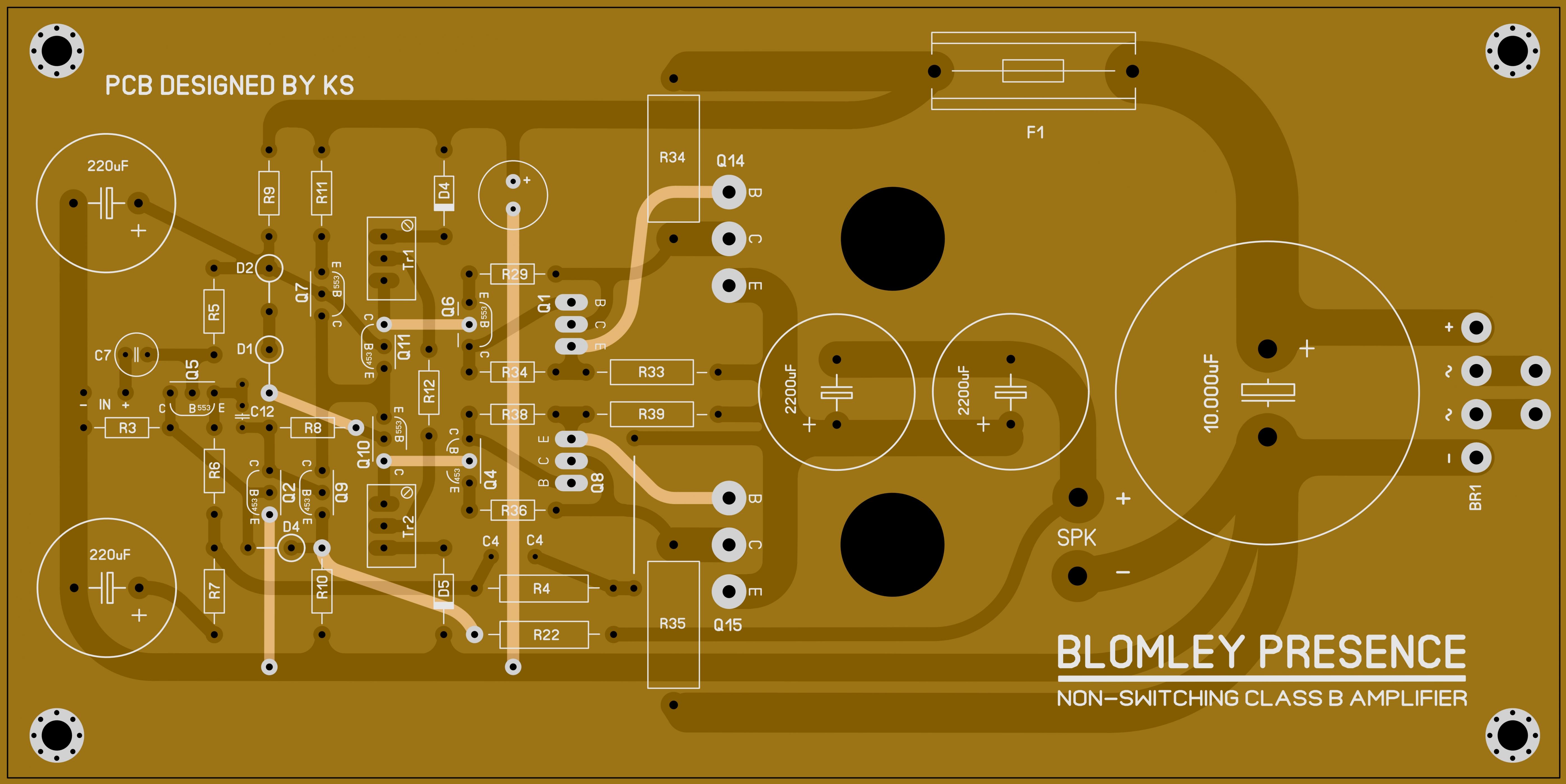

Dear sir, can you send me this pcb file? I like this amplifier very much and want to DIY it myself. Thank you!
As egra says, it is LTspice. Click my signature line to see how to get started.
Thank you sir, I use LTspice to open the analog diagram, and I need the PCB diagram.
Some notes on construction. All small signal transistors are ztx453 / 553, except drives, they are Toshiba TTC / TTA 004B. If you want to use different transistors, check the pinouts. In the feedback network, increase the elko from 200uF to 470uF for proper bass response.
Hello, sir. How to debug? What is the quiescent current? What are the input and output voltages? How are differential transistors paired? Thanks for answering
The original amplifier was specified for 15 ohm speakers. using 8 ohms causes problems because the higher current drive needed biases the -I presume protection - diode (D3) on before full output is reached.
As Trev said I had already put a Vbe multiplier in simply because of the scarcity of ge diodes. Though a Schottky might be an adequate replacement.
Some pointers for 8 ohms - reduce the emitter resistors in the power transistor stage (0.33 ohms) reduce the local feedback resistors R10, R6 to 100 ohms and 10 k respectively, reduce the current source resistor R9 to 4.7k to keep the balance, and the feedback resistor to 2.2k (halving the gain). I removed the diode D3 in the simulations as the local feedback voltage is now higher.
Also reduced the compensation capacitors C6 to 470pF and increased C5 to 68pF to keep the frequency response.
Overall distortion at 20kHz lower than simulated for original at 15 ohms. (.07%). Simulated THD at 1kHz in the region of .005%.
Not carried out any stability analysis. Expect it may need further optimisation as square wave shows ringing on negative edge, and less on positive edge but so did original, where the negative ringing may have been clipped due to the low bias on tr4.

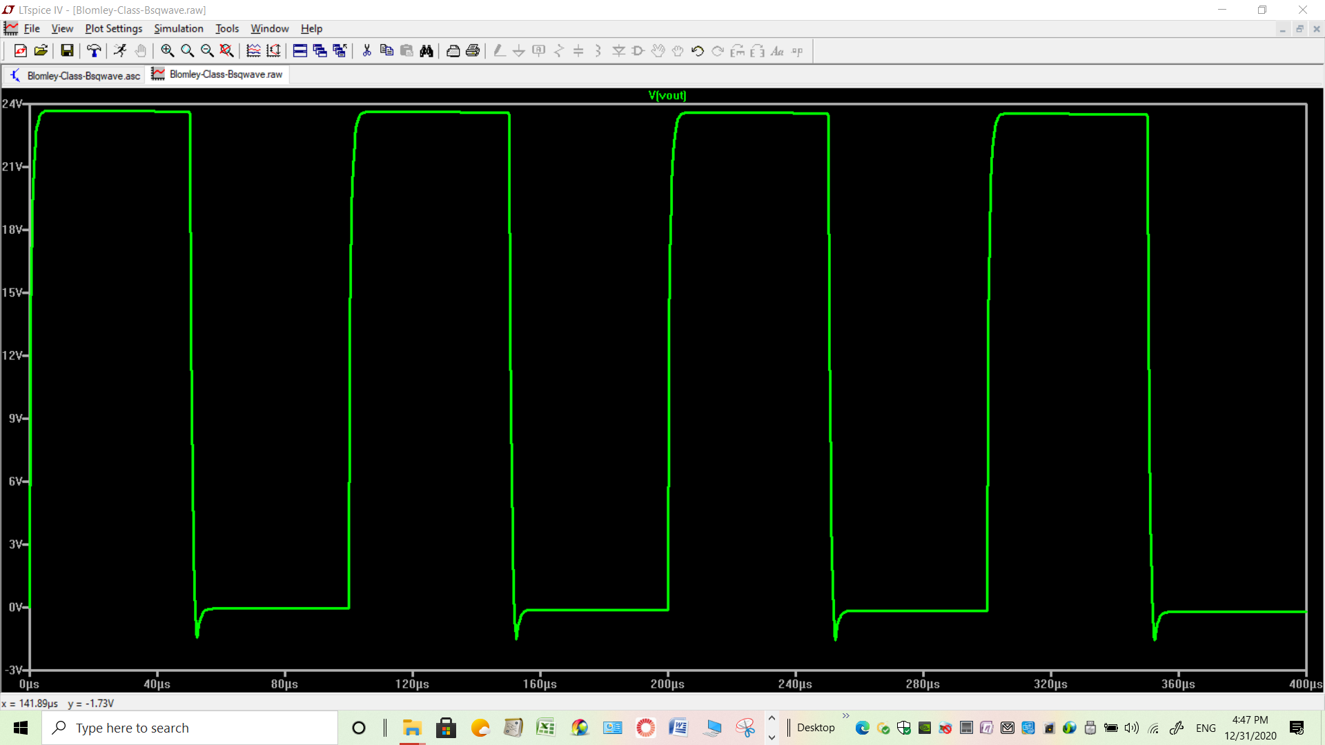

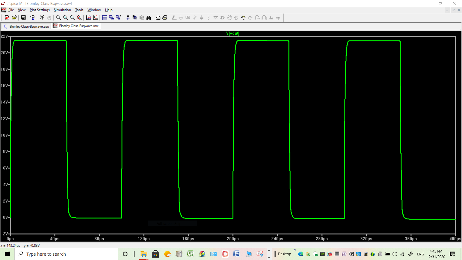

I have simulated this circuit on 10kHz square wave adapting Ian Hegglun's .asc file. The attached images and .asc file refer.
The problem was the value of R6 limiting the current flowing between the output and Q3 emitter. I reduced the value from 22k to 12k.
This had no significant effect to the output voltage however the output transistor standing current did increase to 136 m.A. putting this in the Class AB league.
I used 1N914 diodes for biasing since germanium transistors like OA47 are hard to find.
I would be cautious about using two silicon diodes to bias the current splitter. They form a bias voltage for two transistors (possibly a BC546/BC556 now) and if not careful this may cause an excessive bias current. There is nothing to limit the current in these splitter transistors - and thermally, that is as bad as any bias compensation without mounting all on the same heatsink and even then needing power dissipation to be held similar (although for low power stages that may be less of a problem). I'd recommend using a Vbe multiplier as mentioned in my previous post.
I also noted the need to reduce the local feedback resistor but when investigating the option for making an 8 ohm load version of the circuit.
This design was such that the quiescent current in the output stage is never to switch off, so it largely should not matter what the actual quiescent current is. Except that higher currents which push the output transistors into a lower gain regime would increase the distortion rather than reduce it, perhaps, if older style transistors are used. i'm not sure what the classification of the original design would be. Class B possibly, except the output devices are not supposed to turn off, so not quite Class B so could never achieve the theoretical efficiency of a Class B (in theory).
If however the bias current from the phase splitter controls the output stage, as I think the use of two silicon diodes would, then I agree it has moved into Class AB.
I suggested a method of setting the bias using the Vbe multiplier in my earlier post.
