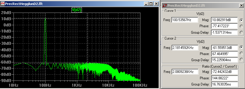

Hi Anton,
Your file now showing V(D2) as visibly clean, I'd say you can't hear any distortion from this.
Weighted THD 0.27%. It's safely below my suggested 1% threshold for audibility.
The weighted THD FFT looks good too.
I added the double differentiator from Post 10 circuit (eg F6 Copy/Paste). Added a bufer because of your high 4k7 load. Added Av from Vout/Vin (4.7V/1V), then mached D2 for about the same peak as Vout.
BTW you used square brackets rather than curly ones.😀
You might be the first one to use this method apart from me.😉
Cheers, IanH

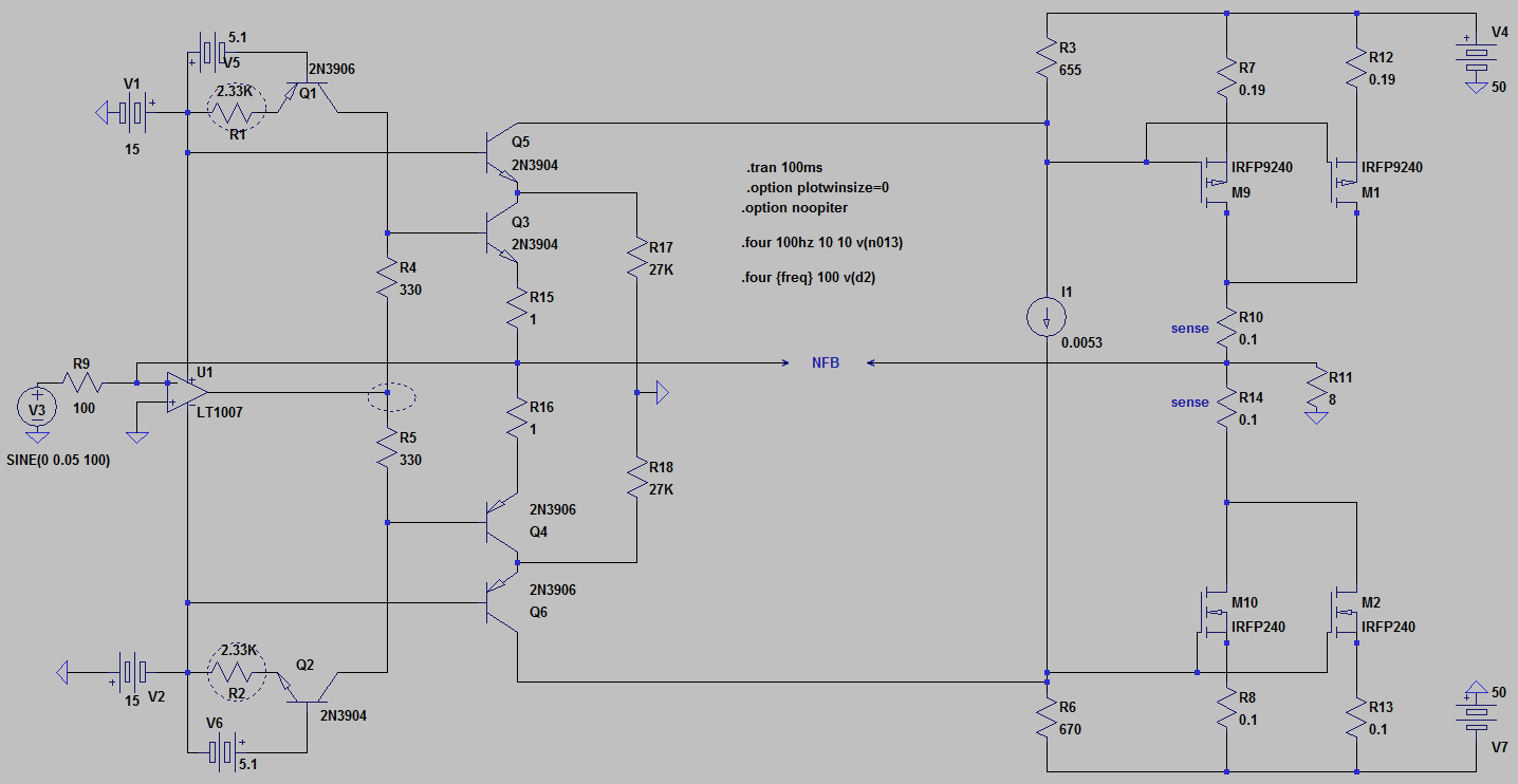

Hello Ian, and All,
Please find attached the schematic for a simulated Class aP amp per your request above. Please note:
1. I am using a complementary symmetry precision rectifier [CSPR] using switching BJTs instead of JFETs. Its rectified music signals [analog pulses] are clearly defined. I am also uneasy using JFETs like in the last post because they may operate in enhancement mode.
2. The %THD at the output of the OpAmp [encircled] is a strong function of the idle current flowing through the switching BJTs. I adjust their bias to be Class AB with the encircled resistors of the constant current sources.
3. The power output stage is made of complementary symmetry Mosfets operating in common source configuration. They have different values of resistors at their sources and for their gate drive; because;
4. I use CSPR [as a convenient tool] to match the performance of the upper Mosfets to that of the lower Mosfets before applying overall negative feedback; so as to minimize [or attempt to] %THD. The outcome of this fine tuning are close values for idle and pulse currents across the [0.1] sense resistors. The pulse currents do not bottom out at zero.
5. The application of overall negative feedback using a [1K] resistor gives a THD = 0.03%.
The .asc file will follow.

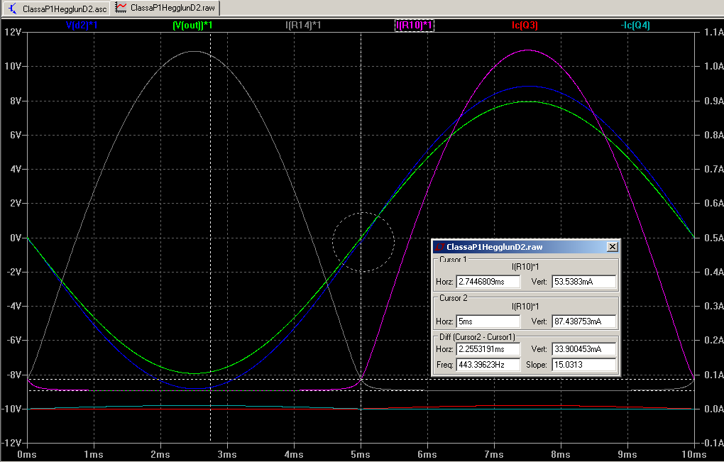

Hi Anton,
No worries. I was asleep then ... in Australia. Expect delays.
I don't know how you intend to implement the negative feedback part?
What I can show is how to analyse just the splitter. I have used an ideal linear output stage amplifying the splitter currents by 100 times.
Looking at the D2 waveform distortion is only just visible. Weighted THD of D2 is 0.7% (ideally we want 0.1% or slightly less to be on the safe side).
BTW your splitter stage biasing is very sensitive to R1 and R2 values. This highlights the need for some sort of Vbe temperature compensation because you want to keep the idle point fairly steady from at least 10C to 30C (50-85F) range.
Notice R17 and R18 can set the stay on current for non-switching in the output stage. So if the idle current from the splitter can be set less than the stay on current then the output stage idle current will be less sensitive to the splitter's idle current and it's temperature changes; which was/is the intent of the original Blomley.
Notice the ordinary FFT plot show about -60dB/decade rolloff which is a highly desirable property for Class-B amplifiers because the high order harmonics cannot dominate giving the "Class-A sound" with Class-B.
I guess you will be adding an input stage since driving into 100 ohms is rather low.
Your Class-aP circuit could be improved if the output stage is made more linear and less sensitive to temperature changes. It all depends on how much global feedback you use. If you don't want to use much global feedback then you need a more linear output stage than the one at present.
Cheers

Hi Ian,
Thank you for your post which is rich in valuable guidance and know-how. First and foremost, I admire your evident high-level proficiency in both Electronics and LTSpice modelling. Commendable.
I'll gladly adopt your above points of advice. I'll further simulate the power output stage of Blomley which has high gain and is possibly more linear than the one I'm using.

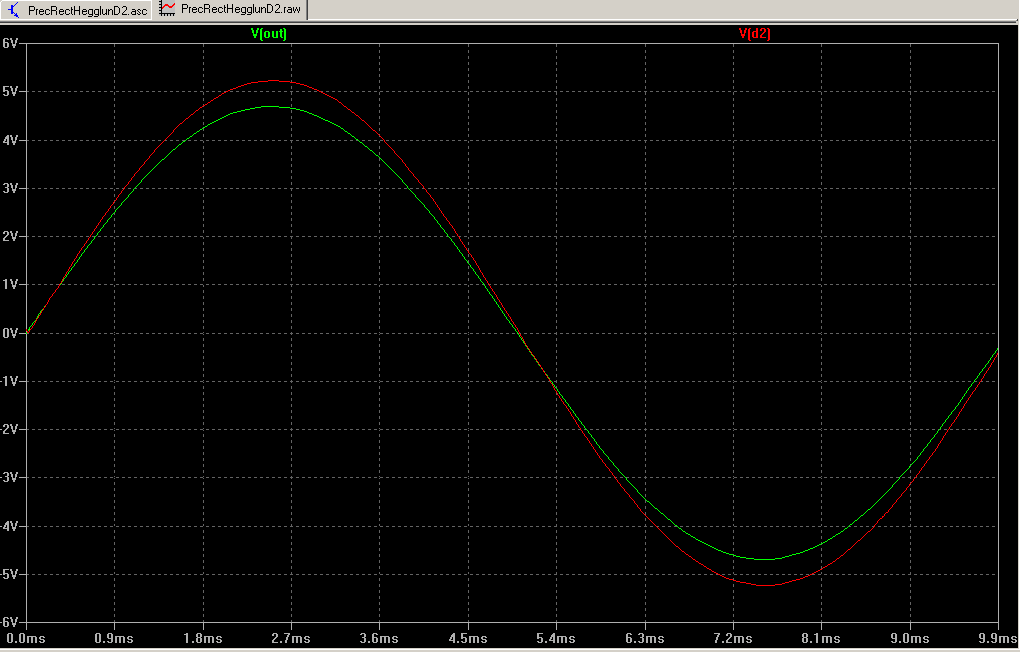

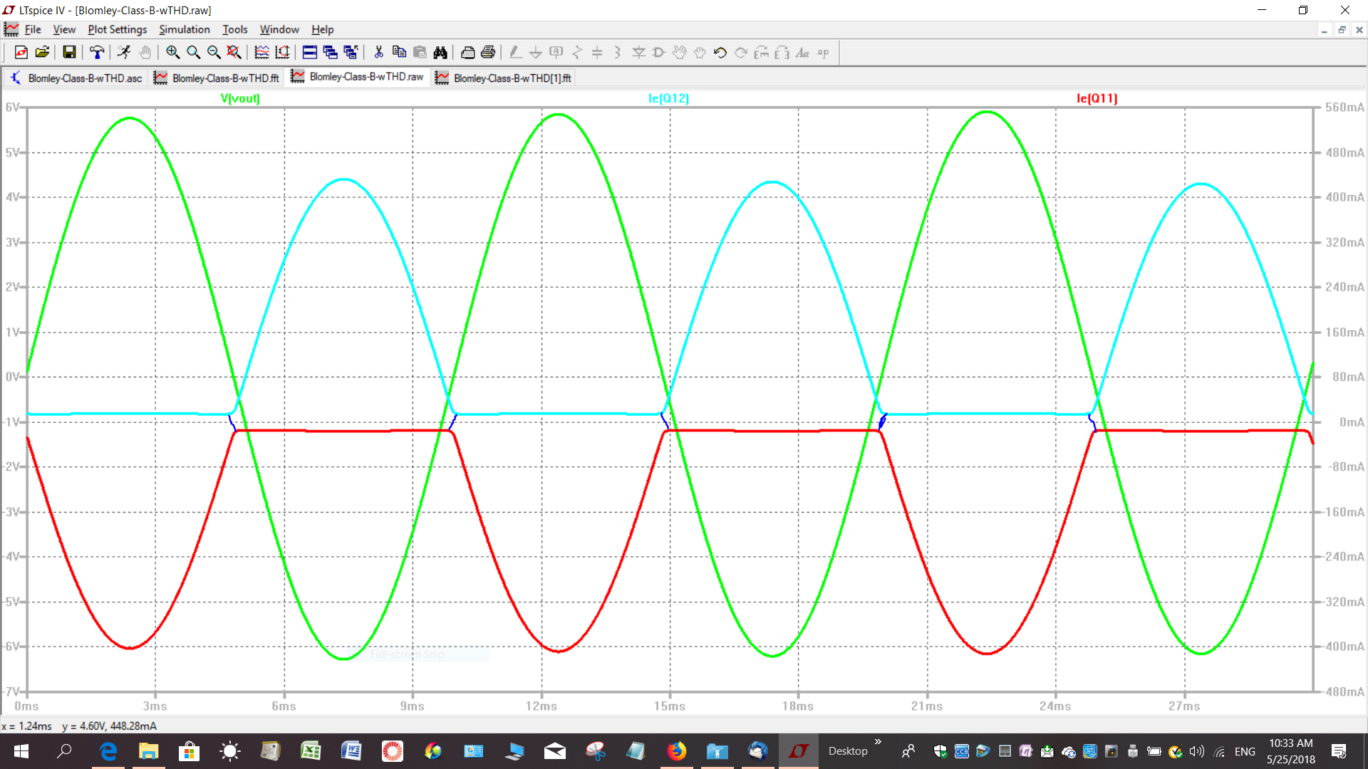

Opening the Gap
In the attachment which plots output current with 60 mV sine input I see a gap between the bottom line conduction in each circuit half and if the closest points are drawn then the middle conduction path looks like a square wave with sloping sides - with brief excursion blocks either side of 0 mA back and forth.
The red traces have greater magnitude than the blue ones - so if the result at the output looks symmetrical how much crunching has there been by the red trace signal and how has this affected the harmonic structure.

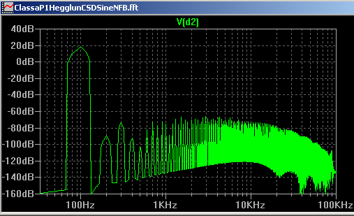

Hi Anton,
Thanks for your kind words. I have been working on nonstandard typologies for about 20 years and started with Tina 4.
The Blomley used CFP type triple "sub-amp" because the power transistors then were quite slow and their beta's were useless for direct current drive from the splitters. Sure, have a go at his sub-amps using modern parts.
Attached is a CSD (current source driven) power stage as per Linear Audio Vol.13 amp using RET's. Modern RET's have a fairly constant Beta up to a few amps and in this configuration can be paralleled without emitter ballast resistors (base resistors instead).
The problem with direct current drive from the splitters has been turning them off fast, eg, for when using a 20kHz full swing test signal. With the help of a few on diyAudio a speed up circuit was developed and is included in the attached so cross-conduction can be mitigated to a safe level.
With two RET's in parallel you can safely get 100W for 8 ohms. Current limiting and basic SOA is provided by the base resistors. One of the benefits of CSD power stages is no Vbe biasing thermal feedback is needed. A thermal cutout can be used to reduce heatsink size and for shorts on the outputs.
With an extra opamp for NFB it gives 3ppm unweighted and 0.03% weighted (see attached). The extra opamp is for a demonstration only. I expect you will develop something more appropriate to suit your likes including some compensation.

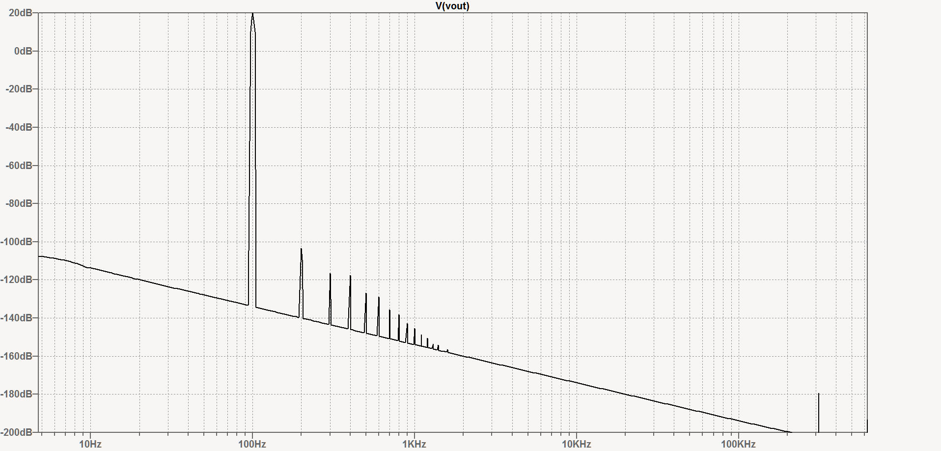

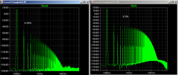

Logician,
(1)...The FFTs reveal a profile very similar to a well compensated, modern 'competent' design. That is, it has H3 higher than H2, H5 higher than H4, and H7 higher than H6. There is a long series of harmonics to the 200th created by the heavy global feedback.
(2)...I have not built this particular circuit but I have discovered that there is a relationship to harmonic profile and sound quality, almost regardless of THD. I would expect this amp to sound 'hifi' but not musical, unlike many of Pass' DIY amps, particularly the Zen series, and the JLH 10W which despite high THD sound wonderful. I agree that the high pole at 3MHz and very good phase margin is outstanding, but these do not make good sound quality.
(3)...People disagree about THD and sound quality. I would expect the Blomley with its non-switching output stages to deliver very low high, odd orders; but from Ian's FFTs these objectionable harmonics do appear, much like most AB modern amps.
(4)...Perhaps global feedback is part of this? But why does the non-switching advantage reveal very low levels of high, odd orders?

...(1) In each of my two earlier posts, only the first FFT is from the non switching version. The second is provided merely for comparison. i.e. the same output stage but without the non switching circuitry in operation. Also, I wouldn't read too much into the absolute shape of the mathematical noise floor as this is quite mutable over wide ranges of various input parameters.

Thank you Ian...
Unfortunately, my Linear Audio article in Vol.4 on harmonic weighting is behind a paywall, but I briefly cover it's application in my free Supplement on p17, mentioned in Post 10. The key point:
Why is the harmonic roll-off rate an important parameter? Our hearing sensitivity curves roll-up at
approximately +40 to+50dB/dec in the 1kHz to 3kHz range when multiple tones do not cause
masking. This means we want any harmonics from crossover distortion to roll-off faster than
-50dB/decade so harmonic distortion from crossover distortion cannot be heard.
Standard Class-B amplifiers have difficulty reducing the level of the higher order harmonics from crossover distortion due to:
1) Our ear boosts the higher order harmonics at about the same rate as they reduce so all are nearly equally apparent, and
2) The negative feedback factor of most Class-B power amplifiers rolls-off at 20dB/decade in the same frequency range where our ear boosts the higher order harmonics and this makes it hard to suppress crossover distortion and make it inaudible...​
After writing my Vol.4 article I realised that the rate of roll-off of harmonics in -xdB/decade is an easier way when doing simulations to assess whether high order harmonics like from crossover distortion than adding a special weighting filter. You can do it by placing a ruler on the FFT plot and slide the ruler to say 0dB and start of a decade and read off the dB drop at the next decade. Easy as.
If you read anything less than -50dB/decade then crossover distortion will most likely be the dominant distortion in the sound of the amp -- then you need to check if the weighted THD is below about 1%, eg by using the double differentiator I used in Post 10 and RMS add all harmonics to the 100th with a 100Hz fundamental; the ErrorLog THD using ".four {freq} 100 V(D2) ". You probably want a 20dB safetey margin, that's a target of ~0.1% for D2 100 harmonics with 100Hz to be safe enough to say any HD will be inaudible at this power level. Note a double differentiator is +40dB/decade not the +50dB/decade of our hearing so it under estimates what we can hear, but this is partly offset by taking harmonics to 10kHz (rather than 3kHz where our hearing sensitivity to falls).
Effectively the double differentiator magnifies all the higher harmonics so they can appear on a FFT plot of V(D2) at the same relative audibility as the lower order harmonics. And when D2 is displayed on an o'scope IF you can see any harmonic distortion then it's most likely you can hear it as well from your amp.
The two plots you gave with 100Hz, the first with NS and about -60dB/decade harmonic roll-off is very good. Also the first low order harmonics are -120dB below fundamental, so low that they would be hard to measure let alone hear.
The second without NS has about -30dB/decade, but with the first low order harmonics at -120dB below fundamental you have a safety margin of +80dB (below 1% needed for audibility). So even if you weighted the higher harmonics they are unlikely to get to -40dB to become audible (at least at the output level used here).
You can conclude that 1) NS does in fact reduce high order distortion, and 2) that the distortion even without the NS is not likely to be audible.
Regarding the Blomley approach, which uses 1) current drive of the splitters, and 2) non-switching in the power stage. The use of current drive of the splitters increases the amount of high order distortion compared to ordinary voltage drive splitting. Current drive of the splitters causes a faster transition through the zero-cross and a doubling of the rate when weighted with say +40dB/decade (double differentiator) gives 4 times the level of higher harmonics, that's a net increase of +20dB/decade. So unless current drive of the splitters can reduce the level of higher harmonics by -20dB/decade at the same time then you are not getting ahead by using current drive of the splitters.
An exception might be in the extreme case where the switching rate at the zero crossing is so fast that the majority of the higher harmonics are pushed above 20kHz where they don't affect the audible range (assuming there's not much other nonlinearites to created demodulation into the audio band by intermodulation). Antoinel's Class-aP (Post 5) would seem to fit into this category if the switching rate is fast enough. I'd be interested to see FFT plots and some D2 values for any of Antoinel's Class-aP amps.
Cheers
