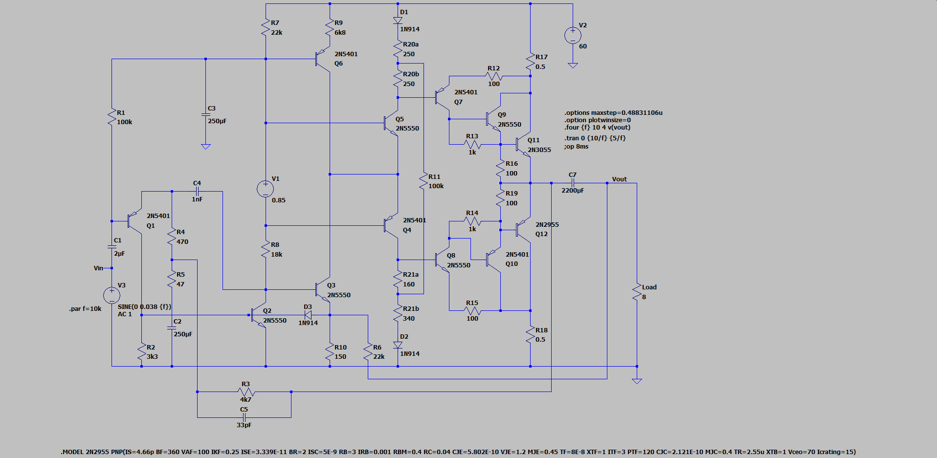

Very interesting amplifier. But I think it helps to redraw the schematic for understanding (attached). So far, it seems to me that this moves the switching action to the driver (or pre-driver) stage as others have done. In this case, the 10KHz THD is not that impressive. I think the same thing can be achieved with better, more modern topology, and better results. For example, consider a "blameless" circuit where the drivers switch but the OPs do not.

I have simulated this circuit on 10kHz square wave adapting Ian Hegglun's .asc file. The attached images and .asc file refer.
The problem was the value of R6 limiting the current flowing between the output and Q3 emitter. I reduced the value from 22k to 12k.
This had no significant effect to the output voltage however the output transistor standing current did increase to 136 m.A. putting this in the Class AB league.
I used 1N914 diodes for biasing since germanium transistors like OA47 are hard to find.

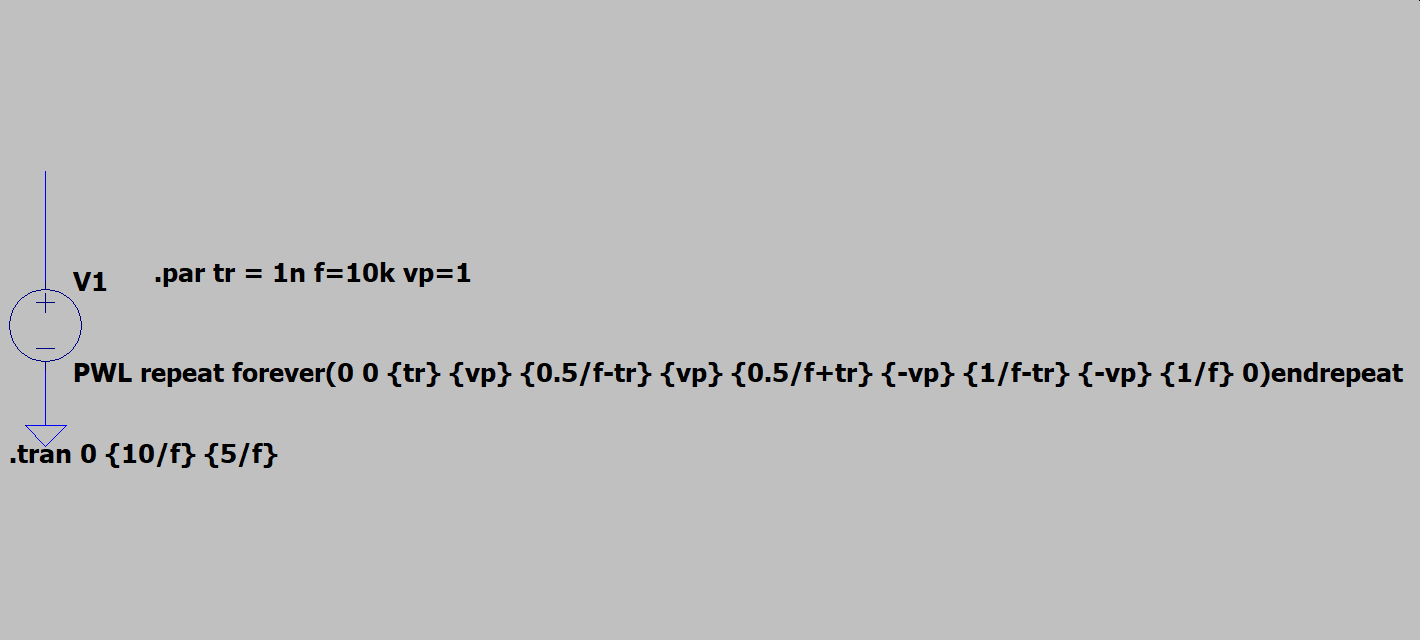

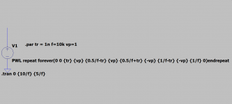

I picked up a trick from Ian that makes a better square wave source, ie no DC offset.

When Blomley says "to minimum" on diode side, does he mean to 0 ohm or to 500 ohm (on the diode side)? I built one but my idle current is fixed at 87.3mA no matter what I turn. I made a mistake somewhere. Building another now. I'm going to set them to what's in the spice settings before I solder them on this one. Also, just to be clear, quiescent current is measured between the collectors of Q14 and Q15 (Blomley's TR11 and TR12), right?
To minimum would mean the sweeping connection (centre pin of the trimpot) to the diode. Which gives you 500 ohms across the trimmer and minimum current.
Quiescent current is through the output transistors, and is measured across either of the 0.5 ohm resistors. The current going through the drivers via these resistors is considered to be negligible.
