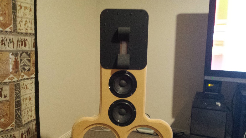

I am really undecided on this one. According to danny_66 the C173-6-090 works well with the RAAL 140-15 as per his thread here http://www.diyaudio.com/forums/multi-way/226914-my-refspeaker.html but for someone like me doing open baffle with the RAAL dipole 140-15D AM, perhaps the new 5" would be better if the SPL could be raised through a small horn either side...
The two Scanspeak 12MUs per side I am currently using work real well, and wonder if two of the new 5" would be in order, but that gets real expensive quick.

Well the problem is I have changed from an active four way setup to an active three way setup. I am trying to cross over below the vocal frequency, and the 4" drivers are a tad small to reach that low without distortion. I am currently crossing over at about 180Hz but would like to cross over lower to make the bass duties easier.

As much as anything... with amp changes and new interconnect cables (Furutech FA-220) I can now hear a bit of colouration in the paper 12MUs that was apparent before. The vocals are very nice, but if I could cross over at around 120hz with less distortion I would be much happier.

If you went with four units, would you do an MTM ?
The 12MUs are fairly shallow in the cone so I didn't bother inverting them, but if I was to use the accutons then I would probably have to CNC a holder up that also acted as a bit of a tube.
Even if the the distortion reduction will be insignificant as the illuminators have extremely well built motors the front-rear dispersion is not symmetric but would be if you inverted one of them. Though if you cross below that point where the rear dispersion fall soff which should be somewhere around 2000 hz then you will be fine, but with your current tweeter I do not think that is possible.
