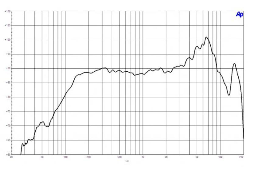

What about a pro type 5" or 6.5" driver? The B&C 5NDL38 looks like it's good from 200Hz to about 3KHz. It has 90dB sensitivity.
