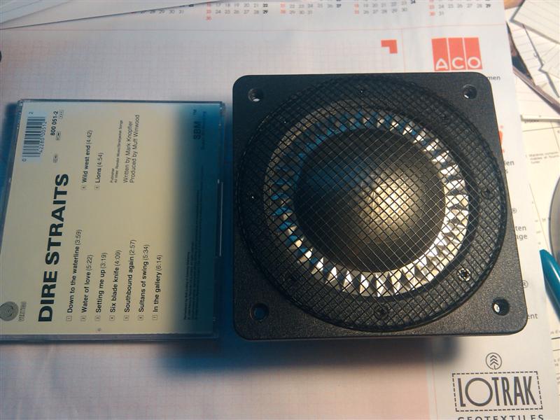

JBL 095Ti (3" Titanium Dome) 1000-4500hz
I have a number of the 095`s + some 093`s and a pair of the car audio variant, the T030.

Short of using an eight inch wide band driver in a front loaded horn, I'd have to agree to split the mid-range, but I'd opt for crossing at around 750Hz.
Why? IMO a largish driver is needed to push enough air at the lower mids to sound realistic, but then cone beak-up causes problems in the upper range, so why not use a smaller devoted MID range driver for the upper mid-range, to complete a 4 way system. Again, IMO, 4 way systems are the best overall approach.
