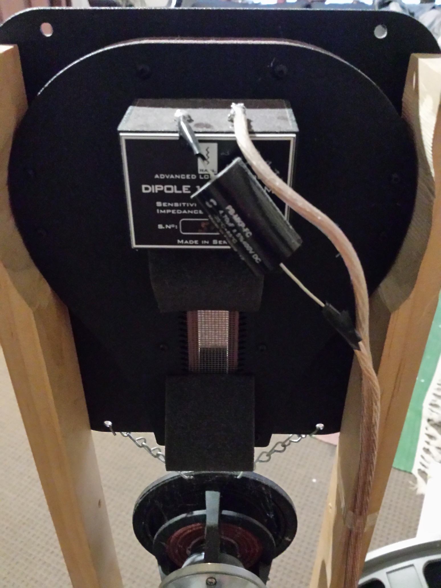

I still stand by my original suggestion of the illuminator series ScanSpeak drivers, but which ones depends largely on the tweeters you plan to use, and where you want to cross over. Even though I haven't heard them in a while (in box under the bed) I still remember being blown away by the RAAL 140-15AM monopole drivers (not to be confused with the dipoles I am currently using in open baffle). I made the mistake / lack of understanding of not better preparing all of the drivers together. Again you can have a "best" driver but unless it fits the whole system there can be better choices available. I would still love to hear the Accton drivers with the RAALs. Don't know if they would be too much, but would be a great listening experience.
I have been extremely happy with my RAAL's over the last 3 or 4 years, I just need to pull my finger out and build the other 7 speakers.
If you decide you like the 140-15AM which I am sure you will, make sure you run a small cap on them. I run a 4.7uF cap on each of mine.
I made the mistake of buying all my mids first (something like 20 of them) before I bought my tweeters. I should have bought the tweeters first because different RAAL models have very different xover points and perhaps may have chosen different mid drivers.

Thanks, I looked at the madisound website and didn't see the monopole raals that you speak of. Now I would be using the AE TD6m in a sealed enclosure so is it the monopole or dipole 140-15 AM that you recommend for this application. I don't want to order the wrong raals. I could run the TD6m from say 250-400hz up to say 1600-2500hz then cross to the raal. Is this what you would suggest. Help me pick the right raal at madisound please. Thanks in advance I really appreciate your help.
This is the monopole with a sealed back (I have 3 of these) https://www.madisoundspeakerstore.c...l-140-15d-ribbon-tweeter-with-amorphous-core/
This is the dipoles I am currently using (have two of these) they have an open back https://www.madisoundspeakerstore.com/ribbon-tweeters/raal-dipole-140-15d-ribbon-driver/

All tweeter have the AM core. Be ready to be surprised how heavy they are. These are some serious tweeters and weigh a ton.

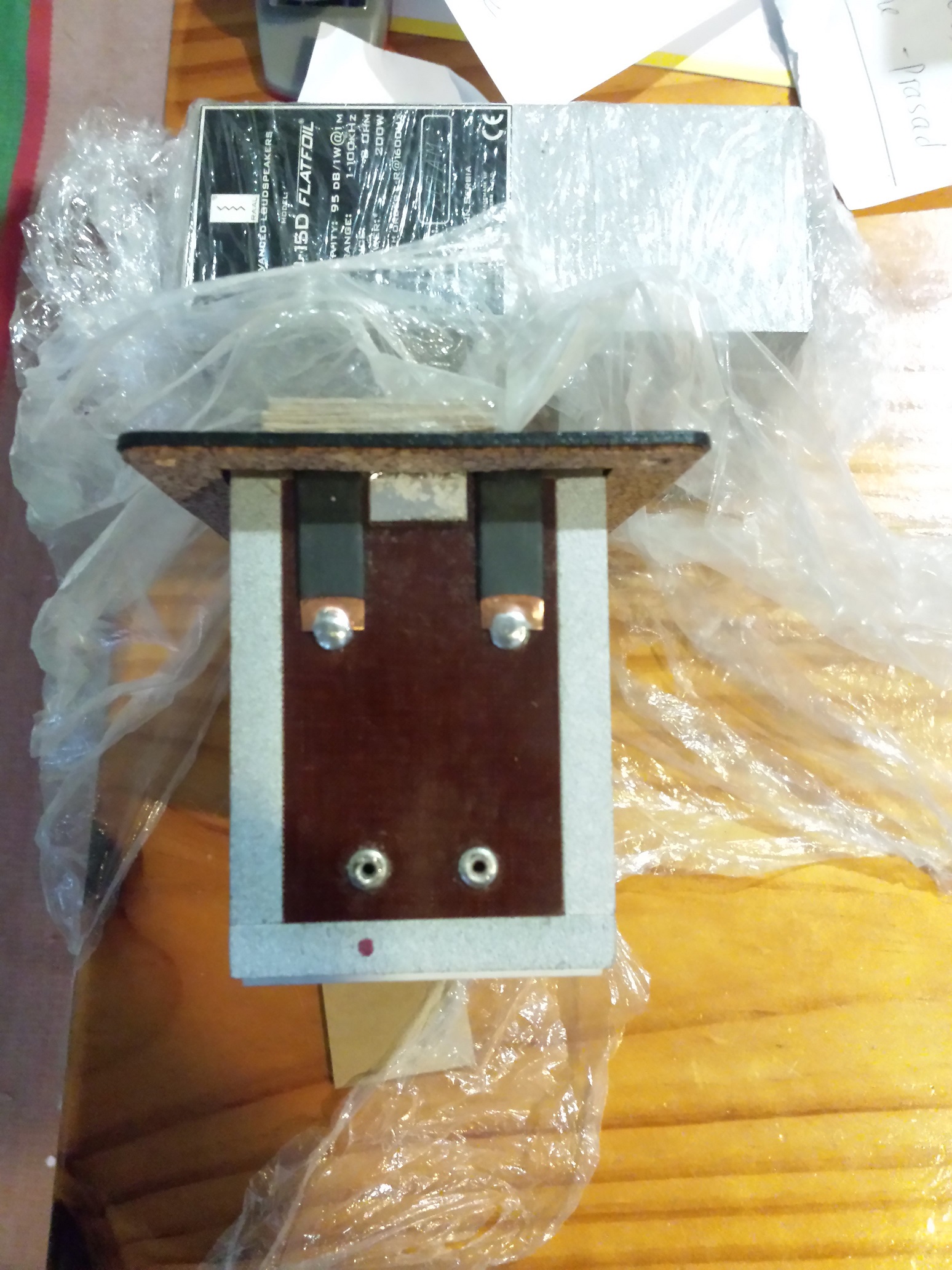

Just had a dig under the bed to see what RAAL recommends... And if you're looking for AM to be printed / stamped on the tweeter it isn't. The only way of telling is the AM at the end of the serial number.
The only negative I can say about the RAAL is having to solder the speaker wires on which is a PITA. But the build quality is solid. In the second picture (the ones you are looking at) that whole back is cased in something like stone.

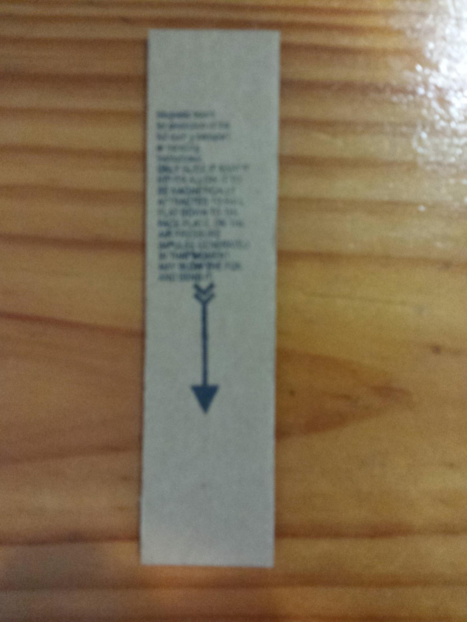

Oh and a friendly bit of advice heed the warning on the driver covers. DO NOT, AND I REPEAT, DO NOT TRY LIFT THEM OFF. Slide them off like directed on the cover. The cover has a fairly strong magnet in it to make sure the aluminium foil is protected, but because the back of those drivers are sealed if it is stronger than you think and pulls out of your finger it compresses the foil and wrecks it. I nearly found out the hard way.
