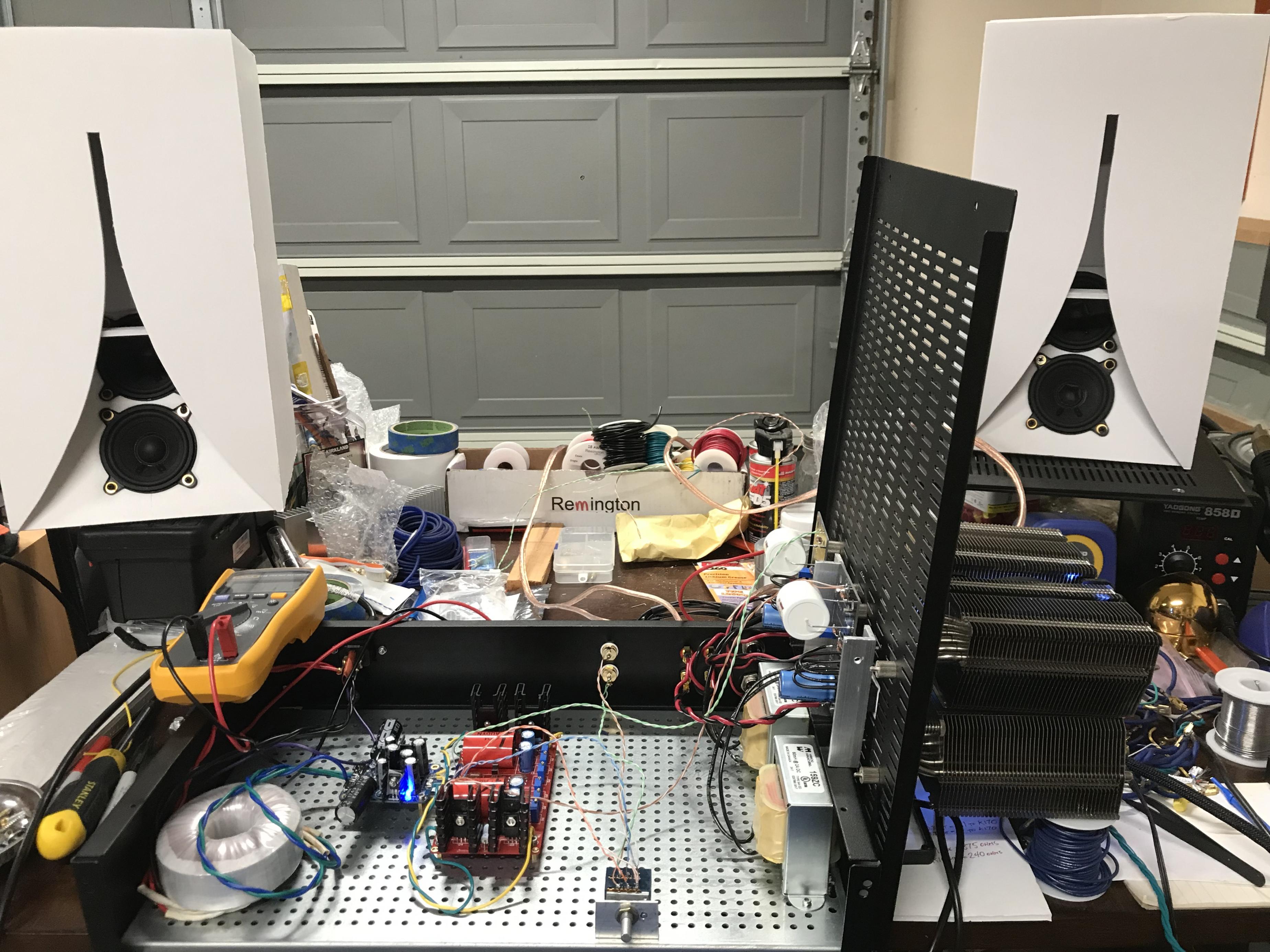

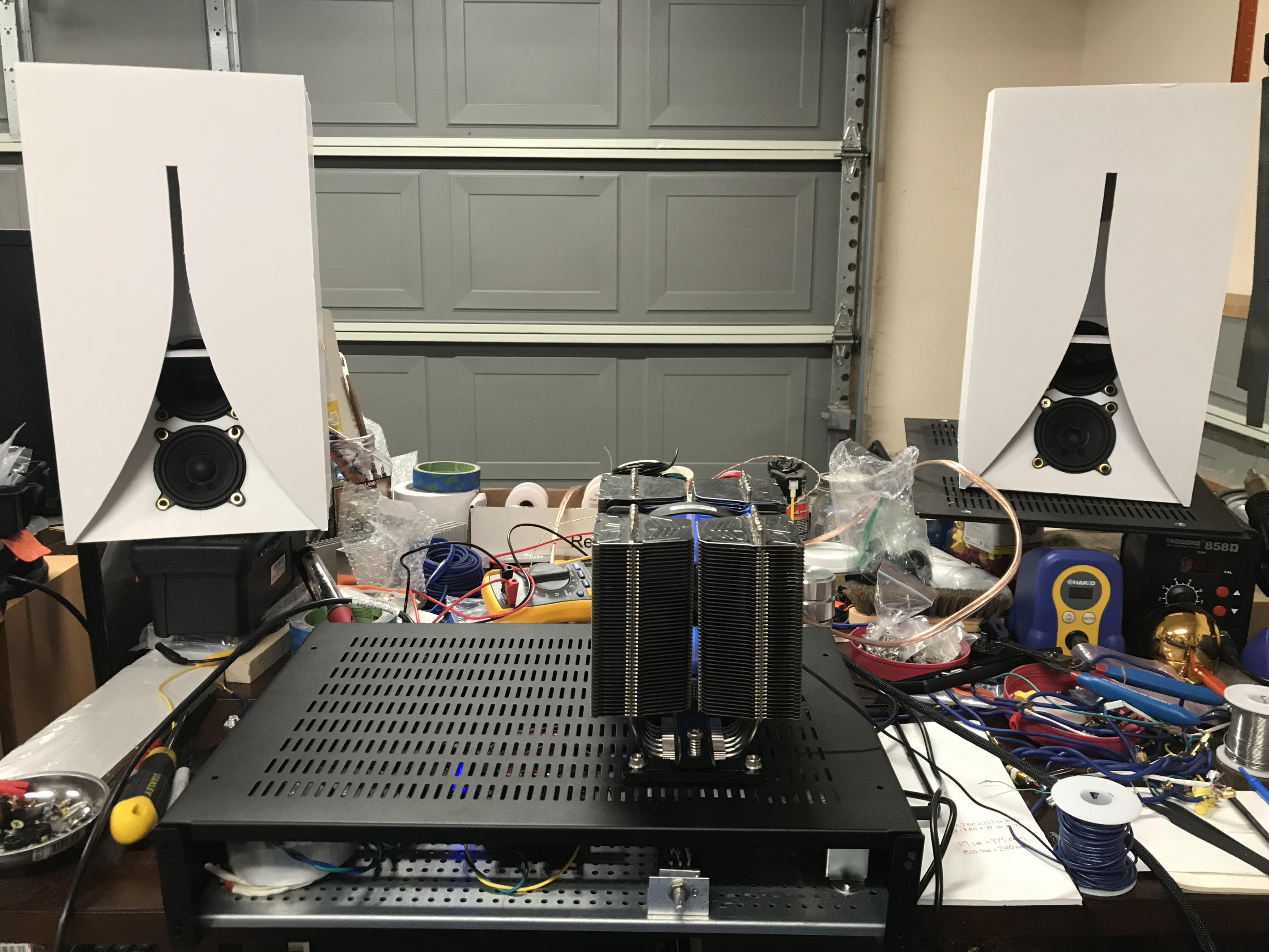

After a short hiatus I jumped back on my MoFo build. Got it up and running today along with the BA3 Preamp. The combination sounds great so far. Playing on my 0.53x mini-karlsonators the BA3 and MoFo go plenty loud. The combo is also dead silent with no turn on thump. This is turning out to be a great integrated project. Still have to get the phono stage soldered up but that’s another project for another day. In the meantime I’m going to get some more listening time on the MoFo. Thank you Michael for a fantastic amplifier and thanks again to 6L6 for the BA3.

Cool, fill us in a little bit on the CPU? heat-sink thingamabob. There has been a thought bouncing around of a build in a pc case using, perhaps, water cooling or some such thing, it's just random neurons at this point, but it's there.
Hi thompsontechs. So I don’t clutter up the BA3 thread I replied on the MoFo thread about the heatsinks.

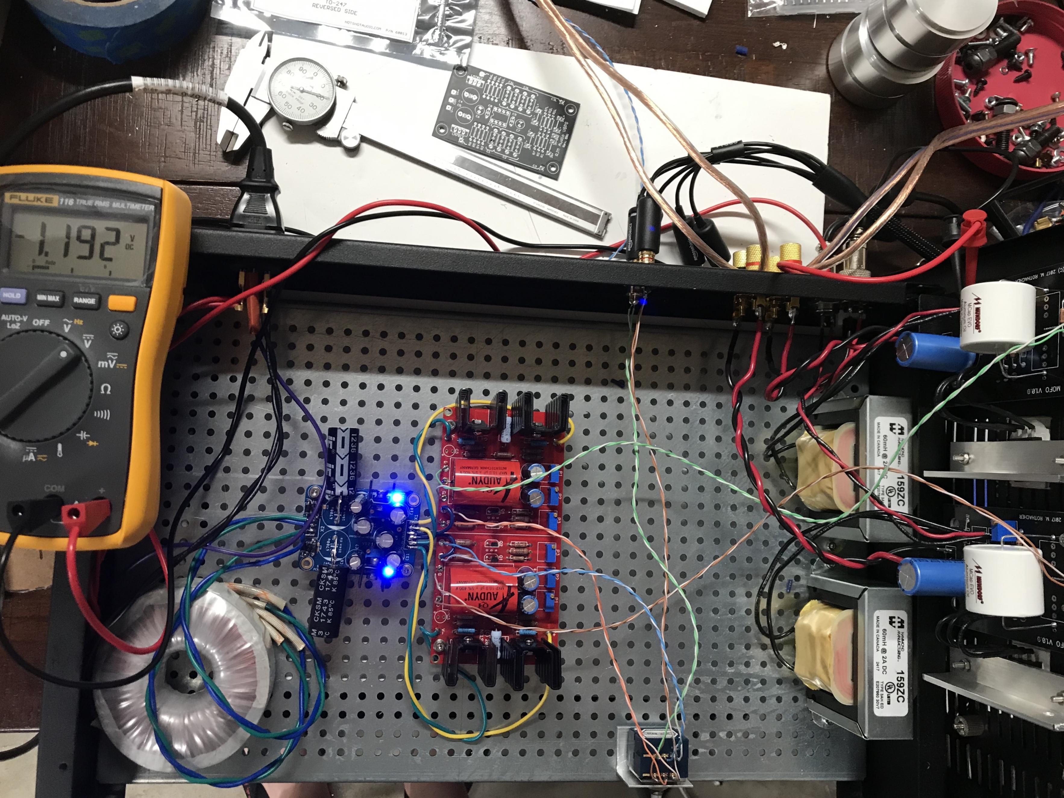

Hello people! I have the preamp up and running and I think I know what's going on, but wanted to get your input here before I make a change. First, I have noticed what some others have with the twitchy pots and some movement of the dc offset, but considering the output caps, I think we are okay with that. IN fact, as I come up on the bias, I am seeing less drift, but then I hit a wall... the wall is, I think in the power supply. To be more precise, my choice of the RC value in the supply.
Supply is the Glassware Dual/Bipolar BA-3 latest version from the DIY store Parts from the BOD here and the C11 are Clarity CSA 10uF
(Glassware) The documentation states if the load is light, a 10R can be used, The RC would then be 4700uF and .01uF and 10ohms. (I used 10R) I didn't know, at the time, that this amp was to be biased to 1v! Wow!
When I bias the circuit up to around .6 volts the voltage drops back to zero or close to it until I move the pot back and then it comes back up, but trying to go higher induces, what I think is an over current in the supply.
Proposed action is to decrease the value of R to 3.3r or 1r which is what John suggests for higher current load. I could just parallel a 3.3R with it to bring it down from 10R to 2.48R and see what that gets me, or do you suggest just going back and removing the 10R and replacing it with a 3.3 or 1R? I still don't understand all the math. Perhaps, one of you can share your thoughts....

Confirmed as the supply not being able to supply enough current. I temp soldered the 3.3R on top of the 10R for 2.48R and the supply did not bonk when the bias was turned up to 1v. This is the first channel she's stable a about 0-15mv dc. That damn pot is twitchy as hell and the dc moves around a bit, but with the top on and about an hour it settled pretty well at about 13mv offset at 1.012 bias. I don't think I will try and get the offset any better as it was a bit like a monkey F'n a football trying to get it there. 🙂
Anyway, for those who build this amp, don't bother chasing your tail until you get a cover on it and let it cook for a couple hours. I found that once you get the bias up there and allow everything to heat up good and stabilize, that the offset will settle down.
Before I figured this out, I would set it and watch it go from close to zero to 100mv or more and from the depending on the pot, it would go + to - or visa.
My advice is to take 6s advice and run one side to .750 and keep and eye on it only making corrections if the dc gets out of control. After a couple hours with the lid on get in there and get it close to zero. If it stays + or - 20mv dc leave it be. As I was typing this it was about 20mv and has fallen back to about 6mv. I will let it run the rest of the day keeping an eye on it and then proceed to the second channel.

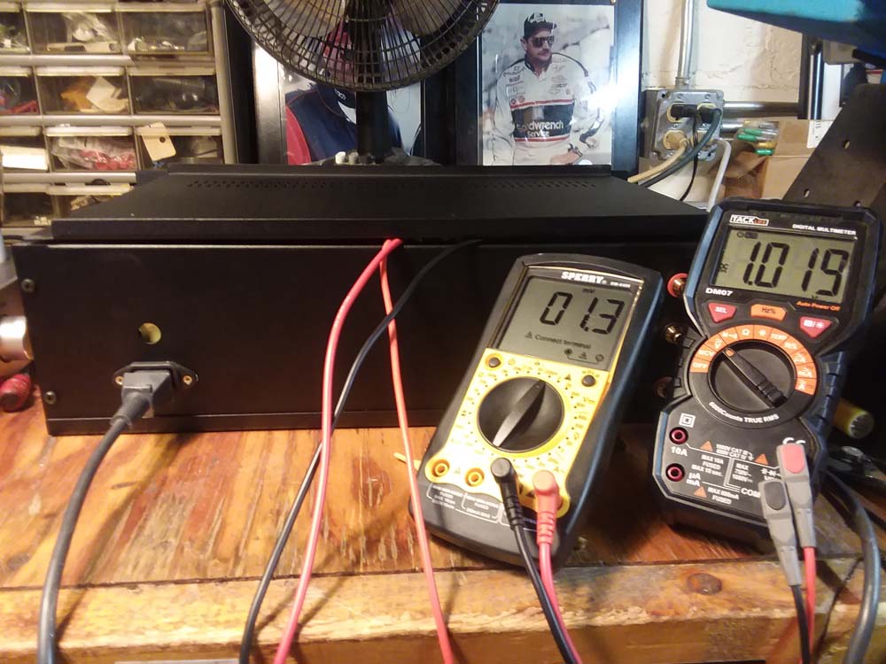

I am currently attempting to bias my BA3 and having some issues. Steps I took:
- Powered up with variac (no smoke)
- Confirmed +-25V at the rails
- Put one Voltmeter across R11 & another Voltmeter across R10
-Put a third voltmeter at Node of R12 and C3 Ground
-I turn one Trimmer at a time one turn. P1 then P2, P1 then P2, until i start to see a reading on my voltage meters.
- If I continue doing this method, I am unable to get to 1V and they max out at around .400mv
Am I supposed to be trimming down the offset as I go? And which trimmer would use to lower offset?
I currently do not have inputs or outputs hooked up to the Ba3 and using FQP3 Mosfets with 1K trimmers.
