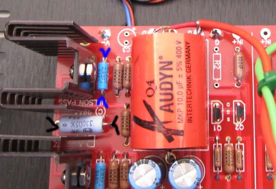

Thank you for the help! I attempted to bias the BA3 again this morning but I’m having trouble seeing any DC Offset when monitoring with DMM across R12. I get 0v the whole time I’m adjusting the pots and again can’t get over .400v before I run out of trimmer.
I currently do not have an input or output connected to the board. Do I need to hook these up and add a dummy load? Could that be my problem?
No, ideally you short the input and it has been stated by 6L6 that it makes it easier to set bias with a load on the output 2-5k, but you can do it without either and it would not prevent you from seeing a dc offset. Why don't you post a close-up of your meter connections to rule out any meter connection errors. Also, get some good shots of the board.
In the picture below the black arrows show the connection point for DC offset and the blue for your bias voltage.

Thompsontechs, the resistor you labeled for offset is R13. Russellc mentioned using R12 and the ground of C3. I tried this yesterday and see about 8mv of offset. I’ll send a pic once I get home.No, ideally you short the input and it has been stated by 6L6 that it makes it easier to set bias with a load on the output 2-5k, but you can do it without either and it would not prevent you from seeing a dc offset. Why don't you post a close-up of your meter connections to rule out any meter connection errors. Also, get some good shots of the board.
You are correct, I had it wrong, I was looking at R13. I will double check my own as well. I'm new too, so be skeptical of any help I may, "try" and give. 😱
No worries. Thank you again!
I get pretty much the same reading off both R13 and R12. R12 is very hard to get to because of the huge Clarity caps I have there. If I were to build another, I would make some test points for that one.
Not sure if on same page, one probe at the cap/resistor junction, (which is "before" the cap) the other probe to ground, right? This is for offset, not bias so you are shooting for 0 here, or as close as is manageable.

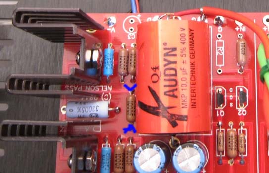

"Place one voltmeter (Set to DC volts) across R12 - to observe DC offset"
Across R12 see picture. This is how I did it anyway.
Russellc
Exactly as I did mine.
See post #45 where 6L6 corrects this instruction. You cannot measure offset "across a resistor"....it is DC on a circuits output, so it is measured at the output and ground.
See also post #23 by Zenmod as explaination. Always good to study entire thread for little details...I think where that instruction was aimed was that as bias is adjusted, offset will wonder, so its a back and forth procedure.
