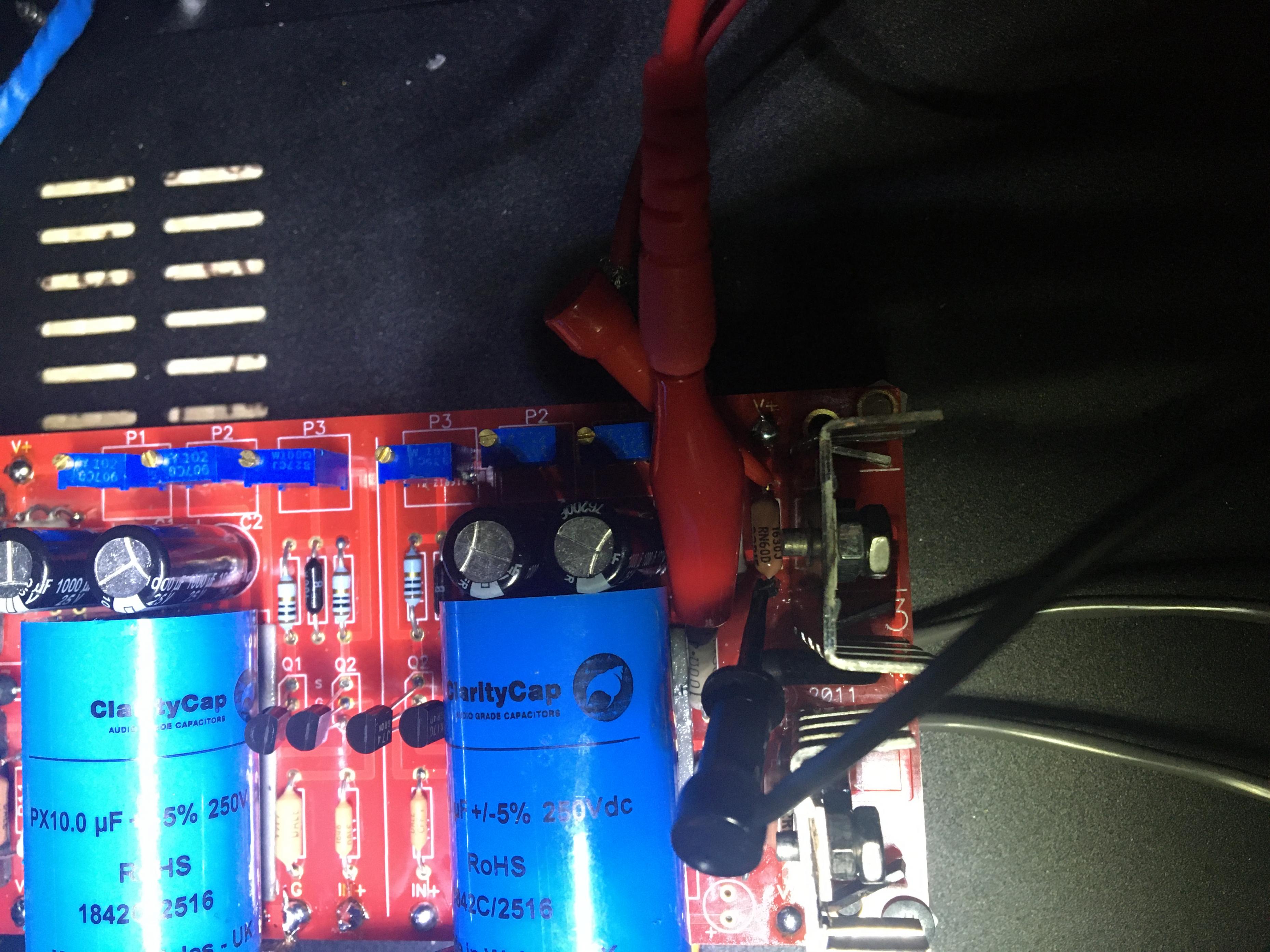

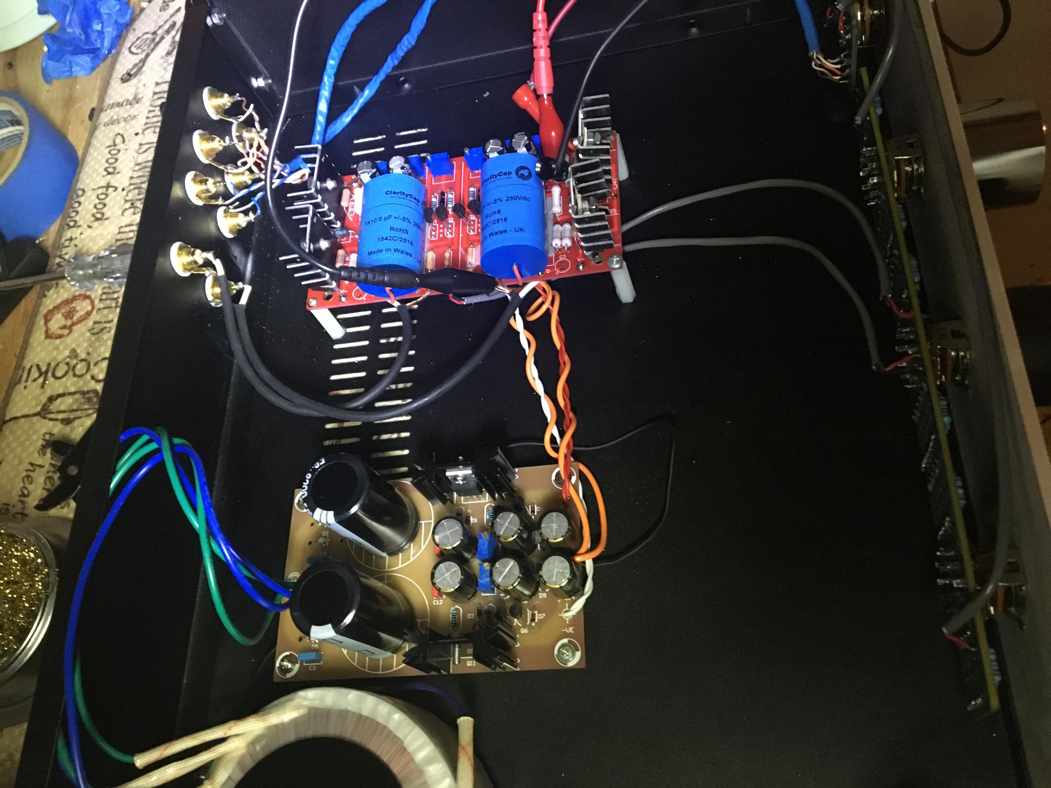

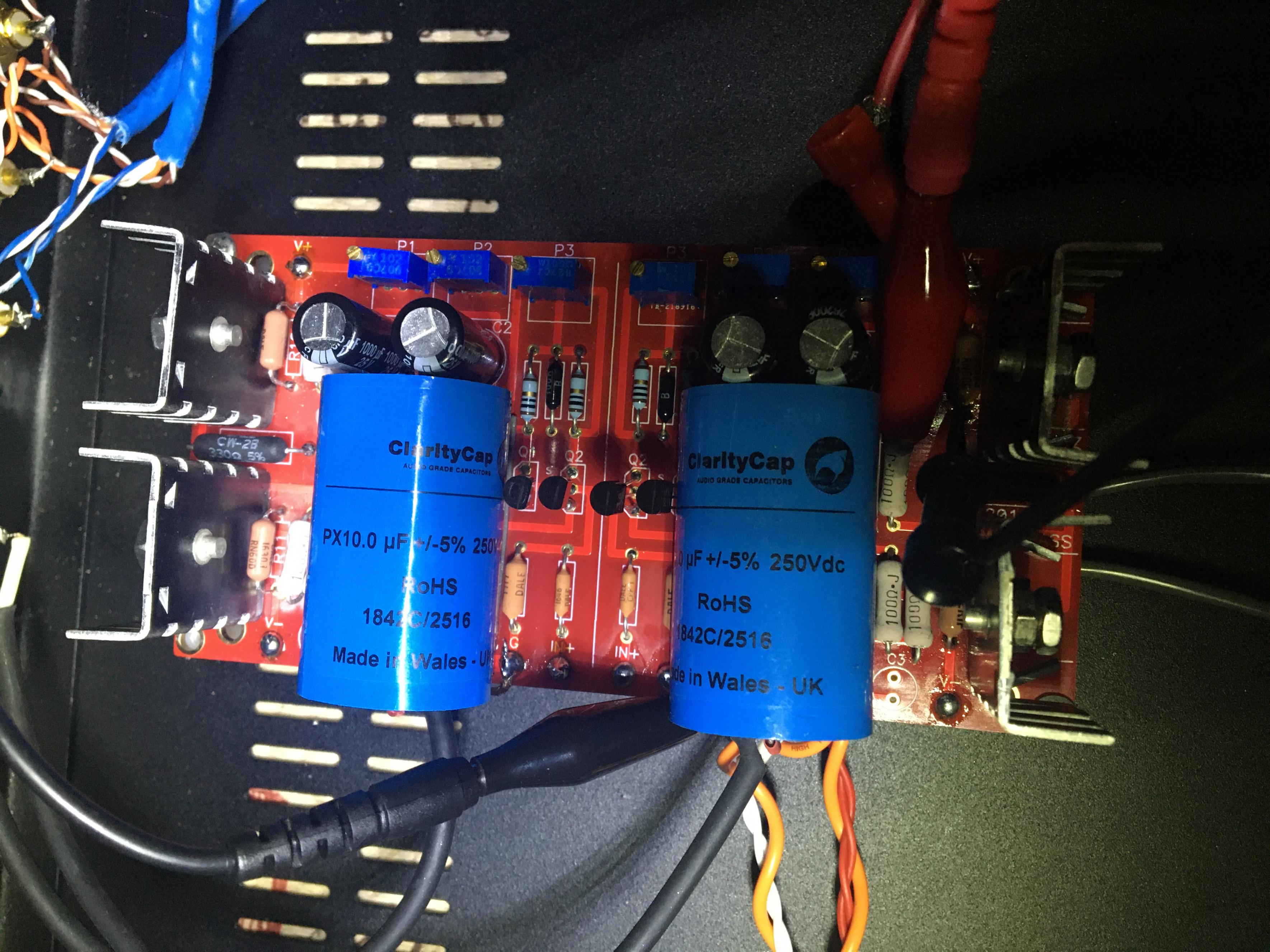

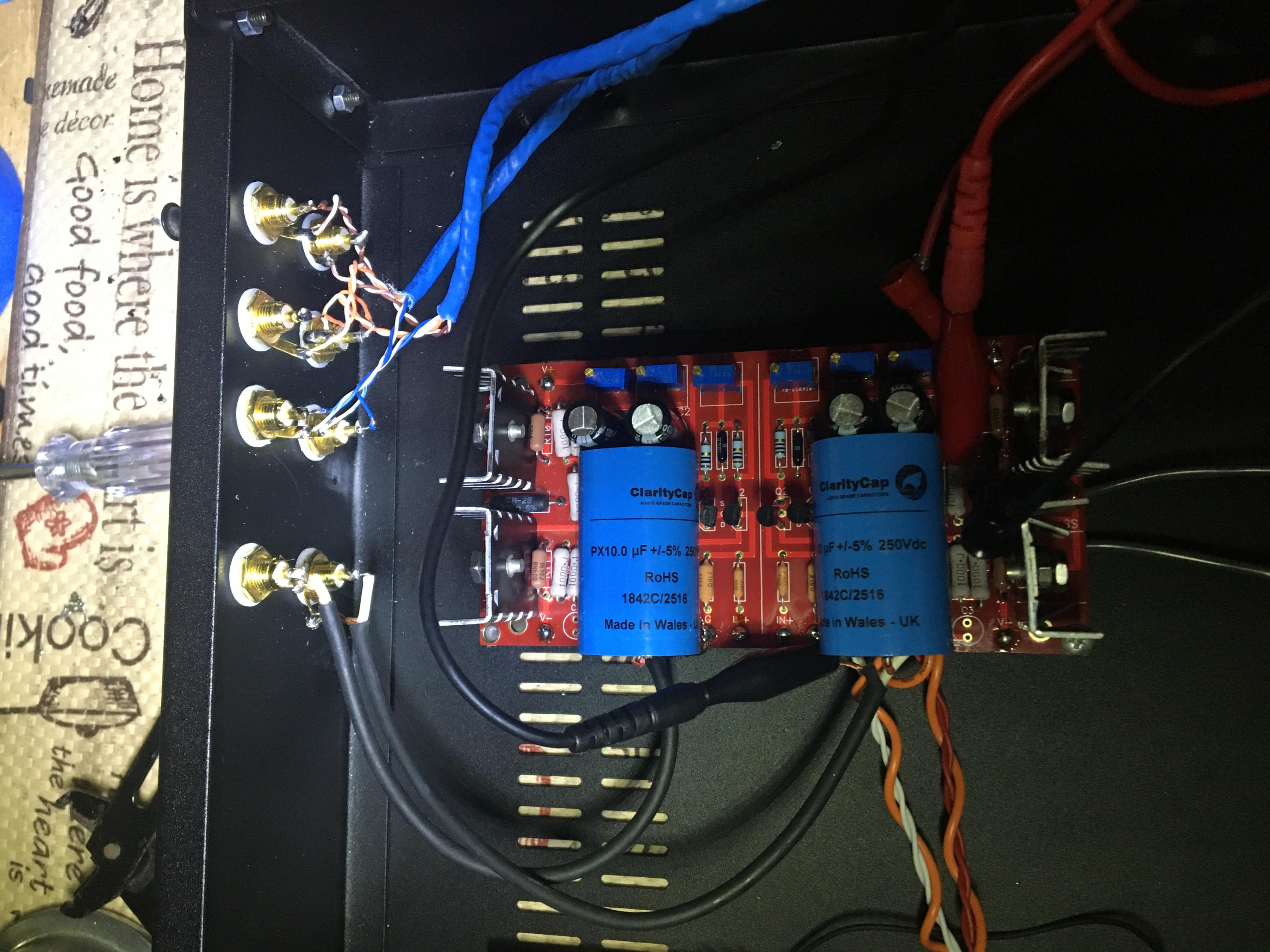

I am still having issues with my build. With my multimeter on the input of C3 and ground, I’m and still getting 0V DC offset and unable to get bias over 300mv. Below are the measurements I took at the JFETS:
-Q1 at D is 24V and at S is 44mv
-Q2 at D is 24V and at S is 34mv
Both sides are the same reading.
Is there a possibility I fried my Mosfets or JFETs. When I first turned it on I had installed my Transformer incorrectly.
Any help is appreciated. Thanks.
Just installed new mosfets and upon turn on I’m still not getting any Dc offset. I did test the old vs new mosfets and it seems they tested fine compared to the new ones. Could my problem be blown JFETs? I included pics of my build.

Hello Dneu2011,
Are your voltages correct on the input of your BA-3 - board?
Measure both channels from +V to ground and -V to ground.
Did you use TOSHIBA or LS-JFETs? Check pinout of JFETs and orientation on the pcb?
Did you use IRF MOSFETS 610/9610 or FAIRCHILDS?
As MEPER mentioned to bias the FAIRCHILDs up you need 1 kOhm trimpots in P1 / P2 position.
And set P3 to midposition.
Only some thoughts..
Greets
Dirk

I checked my voltages from the Power Board into the BA3FE and all check out at +-24V.
The Mosfets I purchased are: 512-FQP3N30 and 512-FQP3P20
I am using 1K Ohm Trimmer Pots @ P1/P2
I used Toshiba JFets. Orientation looks correct @ DGS
P3 was set to the middle position
Make sure your checking on the correct side of cap for offsets. Cap will block DC so no offset will show. Also, as mentioned above, check across R10 & R11 for any bias as you adjust P1/P2.
1> Check proper values of parts and try to reflow all solder joints.
2> Test P1 & P2: Power on, measure from cap side of R6 & R7 to GND. Make sure voltage changes as you adjust pots. No change, replace pot(s).
3> Test P3: power off - check across R3 & R4, DVM to ohms, turn P3, make sure resistance changes on each. No change, replace P3. Return to center.
4> Test JFETs: power on - check across R3 & R4, DVM to millivolts, turn respective P1/P2. If no voltage change, replace Q1/Q2.
