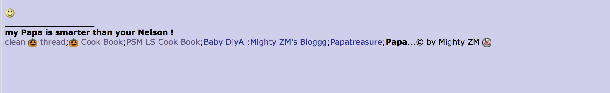

What is "PSM LS" article? I can't find it, or more likely I am missing something
Check Zen Mods footer. they are links to his PDFs.
