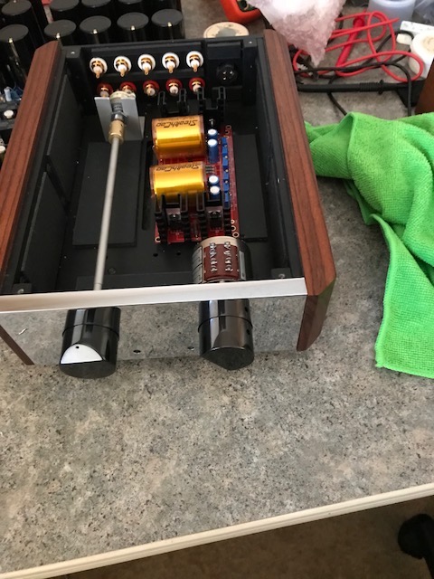

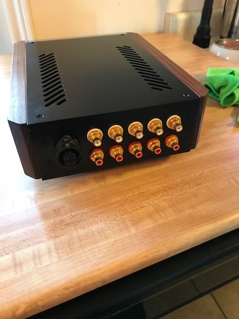

Preamp finished
Finally got around to finishing the chassis and hooking the mechanicals up. I will work on the power supply next and wire everything up. I will cross my fingers and hope all is well. May need help setting bias.

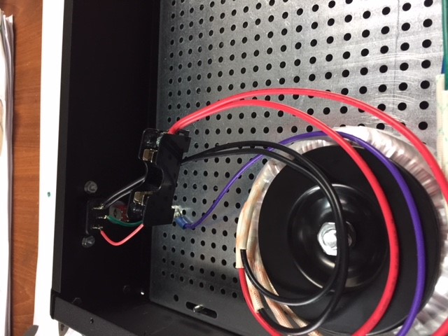

Antek Transformer to power supply
Would appreciate your help. I gather that I would have to connect both primary red wires to AC positive input and the 2 primary blk wires to AC neutral.
The Purple wire is for what? I assume chassis ground?
And about the secondary wires, 2 are green and two blue... One pair of blue/greens extend longer than the other pair, is this indicative of how to connect them?
How do I connect these to my PS board inputs. Inputs are labeled as S1/S2 pairs. Thanks in advance.
Looking into this further, I gather that one pair of blue/green wires that come out from the transformer further back but together, belong to one winding and the other pair of blue/green that come out at a different position belong to the other winding. So, I should connect the blue wire from one winding to the green wire of the other winding.... And the primary connection as described in my previous post. Is this so? Thanks.
Did this connection to check voltages across primaries (120V) and secondaries.
Fuse WAS a 1 amp fast Blow, It blew immediately. No loads on secondaries...I was checking for voltages, is this what went wrong --i.e., no loads.
I guess 1 amp fuse was sufficient. Thanks guys.
