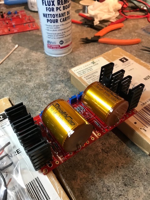

I thought I was almost done but I decided to swap out the Auricaps for a pair of Stealthcaps. They are considerably bigger and I have some space issues but it should be okay to solder the output wires and ground etc from below the board. The pads should be able to take the solder. Has anyone soldered from below the board and are there any issues with doing so? Also the cap wires are about an inch long? Is this going to cause me any problems that anyone can foresee?
Wires to bottom of board is no problem. Cap wires are no problem...you need to be able to measure DC offset before the cap so the length of bare wire is good for that.

In the process of biasing the right channel now. I notice there is a bit of offset after the cap (10uf mundorf evo oil), between 10-30 mv. Nothing reconnected to output at the moment. Is this acceptable?
