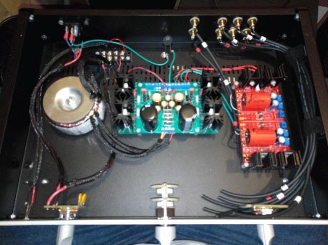

I have my BA3 line stage mostly finished. Just have to wire it up and make a few mechanical adjustments to the chassis. I used an ELMA selector switch and a TKD2P65CS stepped attenuator. I may(probably will) have a few questions regarding setting bias.I hope to have it up and running in the next few weeks. Could I just run a wire and a resistor from V+, on the preamp board, to make a front panel LED power indicator?
