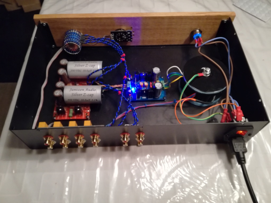

Nice work qwertly! What are the Jensen transformers for?
Thanks. Jensen transformers are converting unbalanced to balanced input.

A bit confused here. You say you are going unbalanced to balanced input and I see a 4 deck attenuator but I only see one BA3 FE board.? Nice and neat build.
nash
nash
Thanks. That's ladder type stepped attenuator.

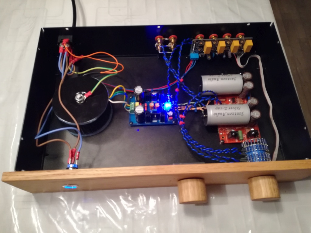

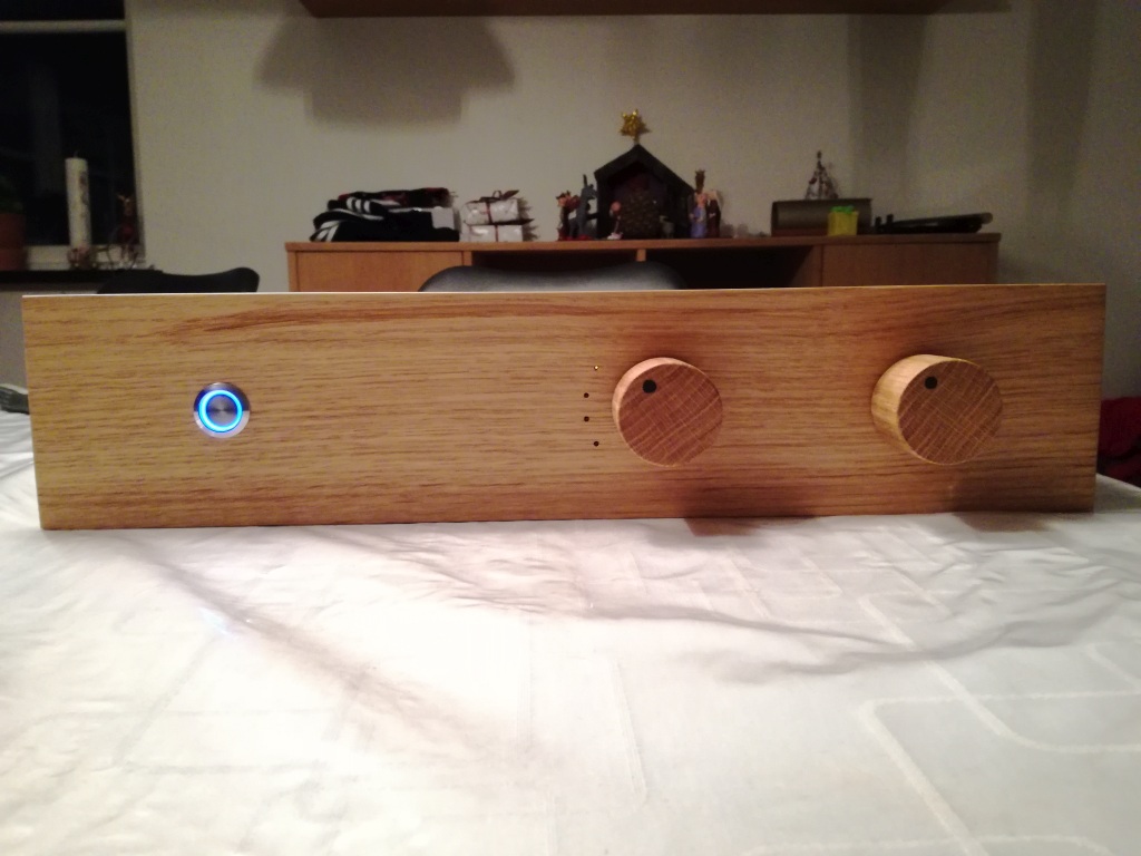

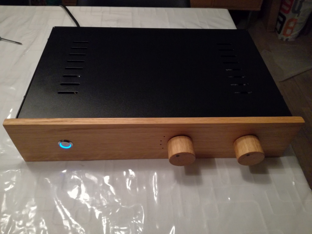

Just wanted to show my new BA-3😀
Thanks to 6L6 for all his help.
Have played on it a couple of days with my Aleph J, just wonderful🙂
Merry Xmas to all from Thomas, Denmark

Congratulations and beautiful casework!
I'm going to use that same power switch on my F-6 power amp and BA-3 preamp.
Where did you source your input selector? I like it!

Do not wire anything to toroid central bolt !!
that's most probably short circuit , you have there
I did not know thet! Now fixt, thanks🙂

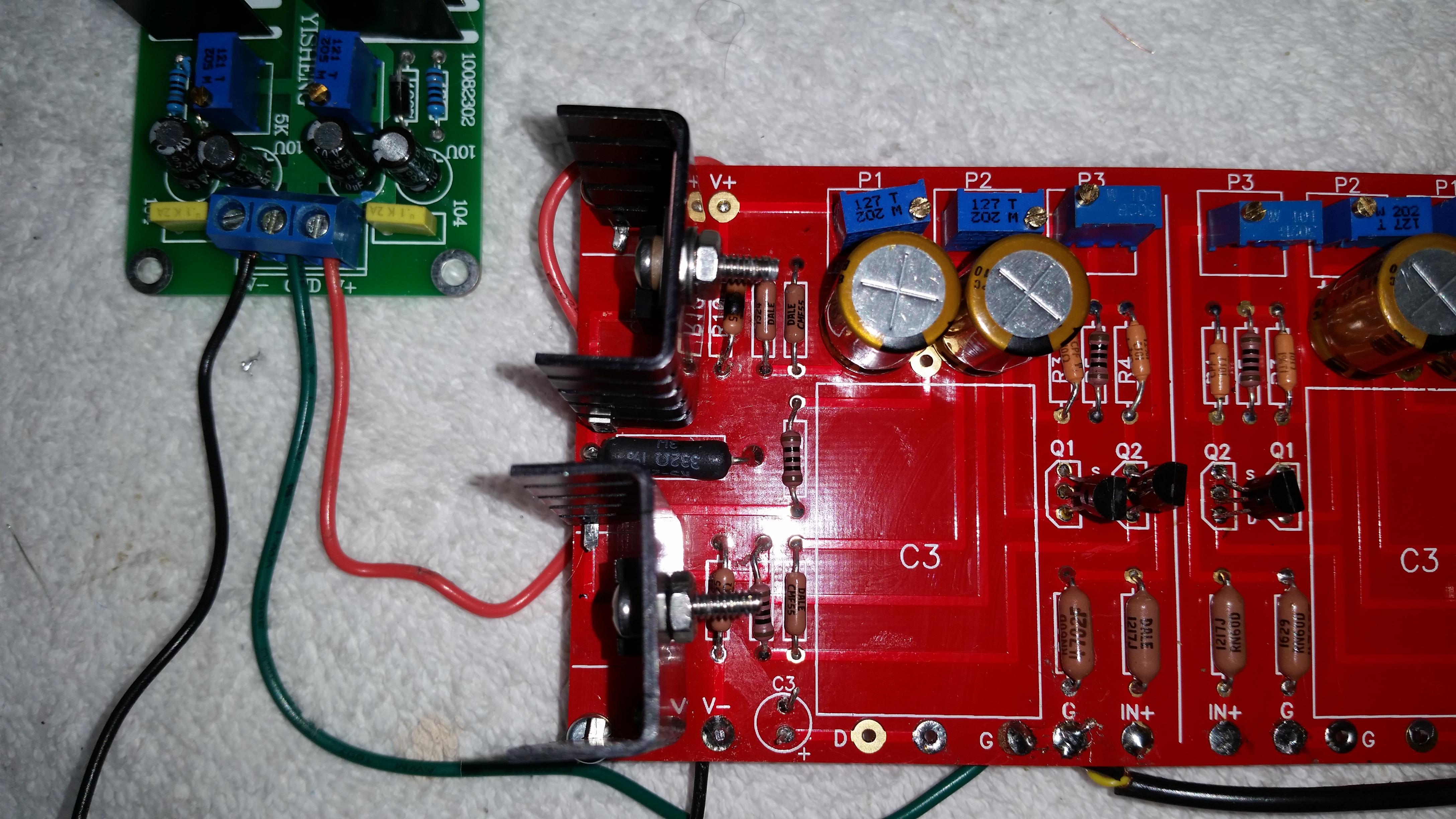

After successfully building F6 amp I decided to build a BA-3 preamp to go along with it.
However on powering up to bias one fully built channel of the board (no output cap yet as I wanted make sure board biased up correctly before soldered 10 uf cap as it takes all the real estate) using variac, I am running into trouble.
I am measuring about 8 v at full voltage across both R 11 and R 10 with no effect of P1 and P2 pots whatsoever. I had to lower voltage as R11 and R10 became brown but still measure 22 r.
I am using fairchild parts from mouser Fqp3N30 at Q3 and Fqp3p20 at Q4.
P1 and P2 are 2k pots and I made sure they are zeroed out before powering with a variac.
Jfets tightly matched Sk170 idss 7.1 and SJ74 Idss 7.09
V+ at 24 v, V- at negative 24 v Ground at G on PCB.
What I am doing wrong? Double checked the value of all resistors. All check out fine. Picture attached.
Please help.
