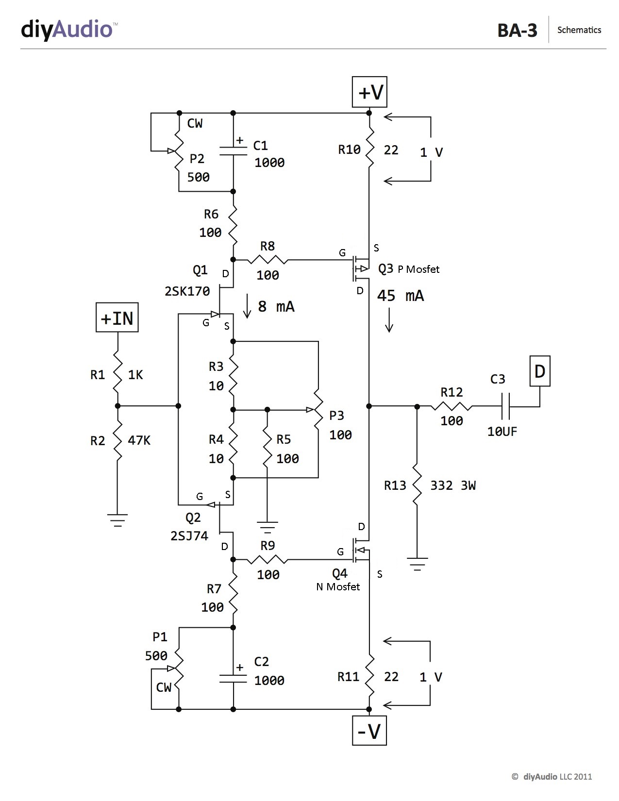

I did . Measured at the caps positive and negative terminals with ohm meter to zero . Turning the p1 and p 2 seems to have no effect. I double checked the pots to make sure they are not defective.
No, Q3= FQP3P20
Q4= FQP3N30

Also if you look at the schematic you will see that Q3 is the P and Q4 is the N

The four devices in the DIYaudio sch attached to post606 are all FETs.
It would be nice if DIYaudio could append Nch and Pch to the relevant devices.
It would help Builder Members to get this right first time.
In addition the mosFET symbols are not correct. The arrow direction and the double bond to the Source are correctly shown, but the shape of the gate connection should look like the lower diagram supplied by 6L6.
Ask DIYaudio to correct the schematic and think about incorporating the N/P information.

The Mosfet were unlabeled as there are multiple devices that could work, 2SK2013/2SJ313, IRF 601/9610. Fairchild FQP3N30/FQP3P20.
Please make the changes you see fit and I'll happily integrate the new drawings into the documentation.

Success gentleman.
Swapped the mosfets as suggested above.
Biased to 0.95v with stable .5 to 1 mv offset. Will leave there for now as suggested by 6l6 in his build guide and tweak final settings when she is settled in a case with lid on.

When I read the recent postings, they concerned me, as I had built a stand-alone BA-3 and wondered if I also might have misplaced the Mosfets, even though I had not experienced any problems as described. But after going back to Mr. Pass' BA-3 article, I was able to put my mind at rest.
The schematic in Mr. Pass' BA-3 article has them correctly, see:
<<http://www.diyaudio.com/forums/diyaudio-com-articles/194809-burning-amplifier-ba-3-a.htm>>
Also, Mr. Pass indicates in the BA-3 article that the BA-3 front end "is a relative of the F5 amplifier, scaled down and absent the feed-back loop." The F5 has the source of the P channel Mosfet attached to positive DC and the source of the N channel Mosfet attached to negative DC.
As Zen Mod often reminds us, we can benefit greatly by reading Papa's articles to better understand what we are building.
In this case, the reversed Mosfets appear to be an artifact of the schematic published in connection with the Diyaudio Store page.
