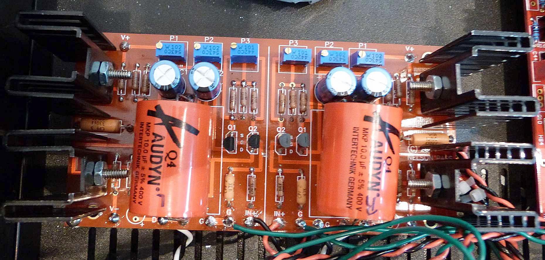

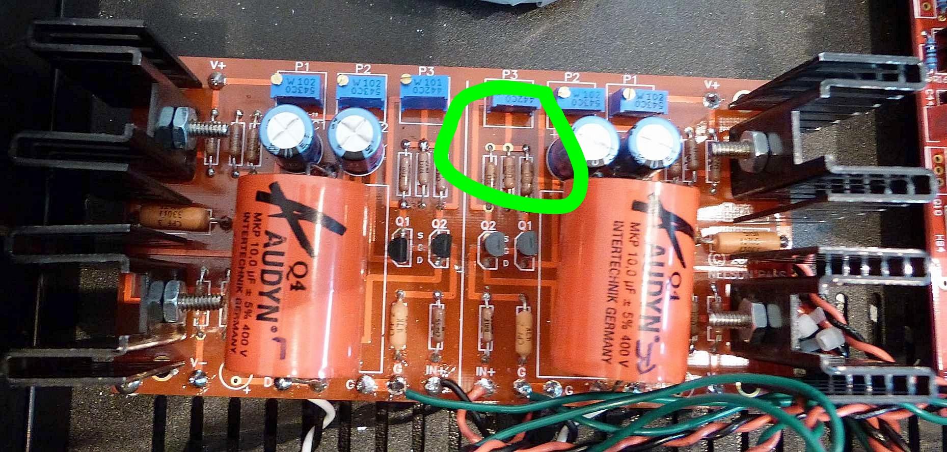

My guess would be that it's either a bad solder joint or, albeit less likely, a damaged resistor (loose metal end cap).
Hi Jim,Normal troubleshooting questions -
The problem stays the same if you switch the input wires L to R?
The problem follows the output if you switch the output wires L to R?
Have you measured the bias voltages when the channel drops out?
Please post some well-lit, in-focus photos. I am always amazed at what some members can see.
The problem stays the same switching input or output wires, I haven't measured the bias when the channel drops out. I'm hoping it's as simple as a bad solder joint that acts up when more power is applied. Here are some close ups.

It does change speaker when you switch input or output wires right?
Hi Guys,
Yes the fault follows the wires, the problem is originally in the right channel, if I swap left and right outputs the problem moves from the right speaker to the left, swapping inputs does not affect the channel problem. I reflowed every joint throughly today and the problem persists, once the volume is raised to a loud level the right channel fades out. I've tried three different pots so far to rule a faulty pot, same issue with all three. There is something really odd going and I'm really tired of screwing around with this board. I think I'll abandon this board and use the case for a DCG3 build. Thanks everyone for your help.

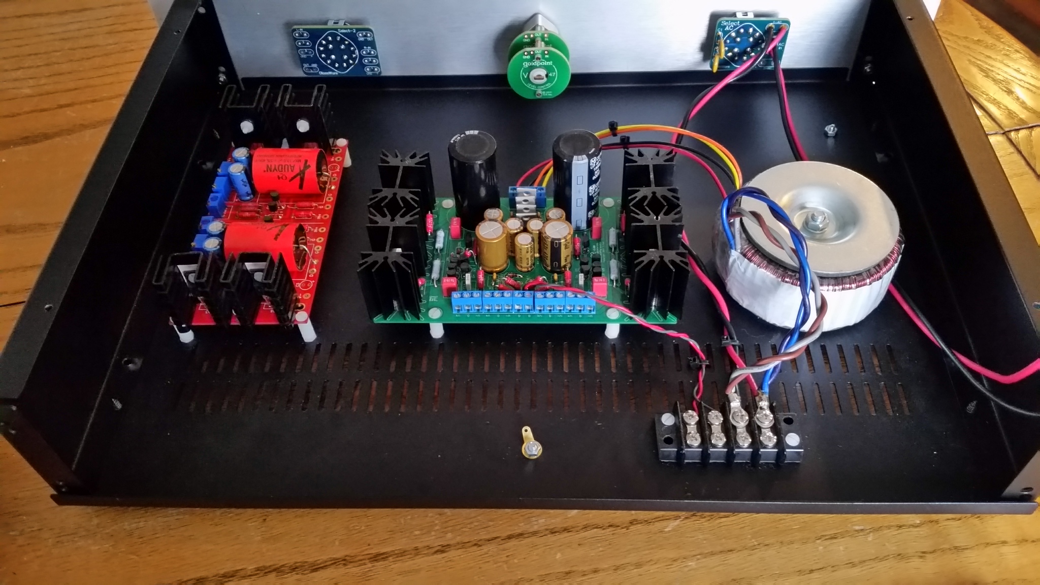

Hope to be done this weekend. Will test power supply first.
Power supply powered up ok. +24volts/-23.7 volts. Not sure what is causing negative side to be down .3 volts but this should be ok right?

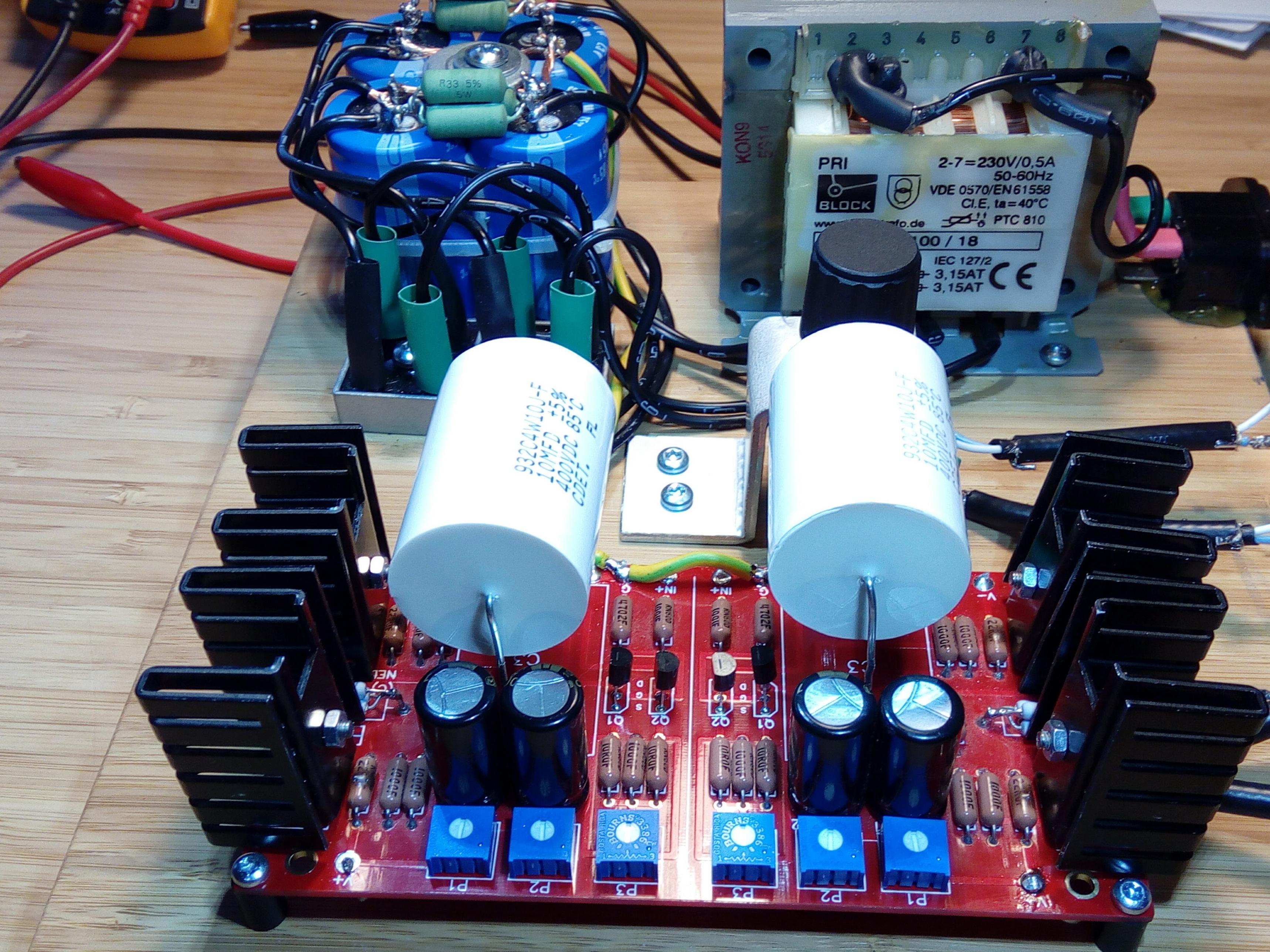

Had four smokes actually. Thought I was ready, conneted AC and smoked all four (R10/R11 22ohm) biasing resistors...

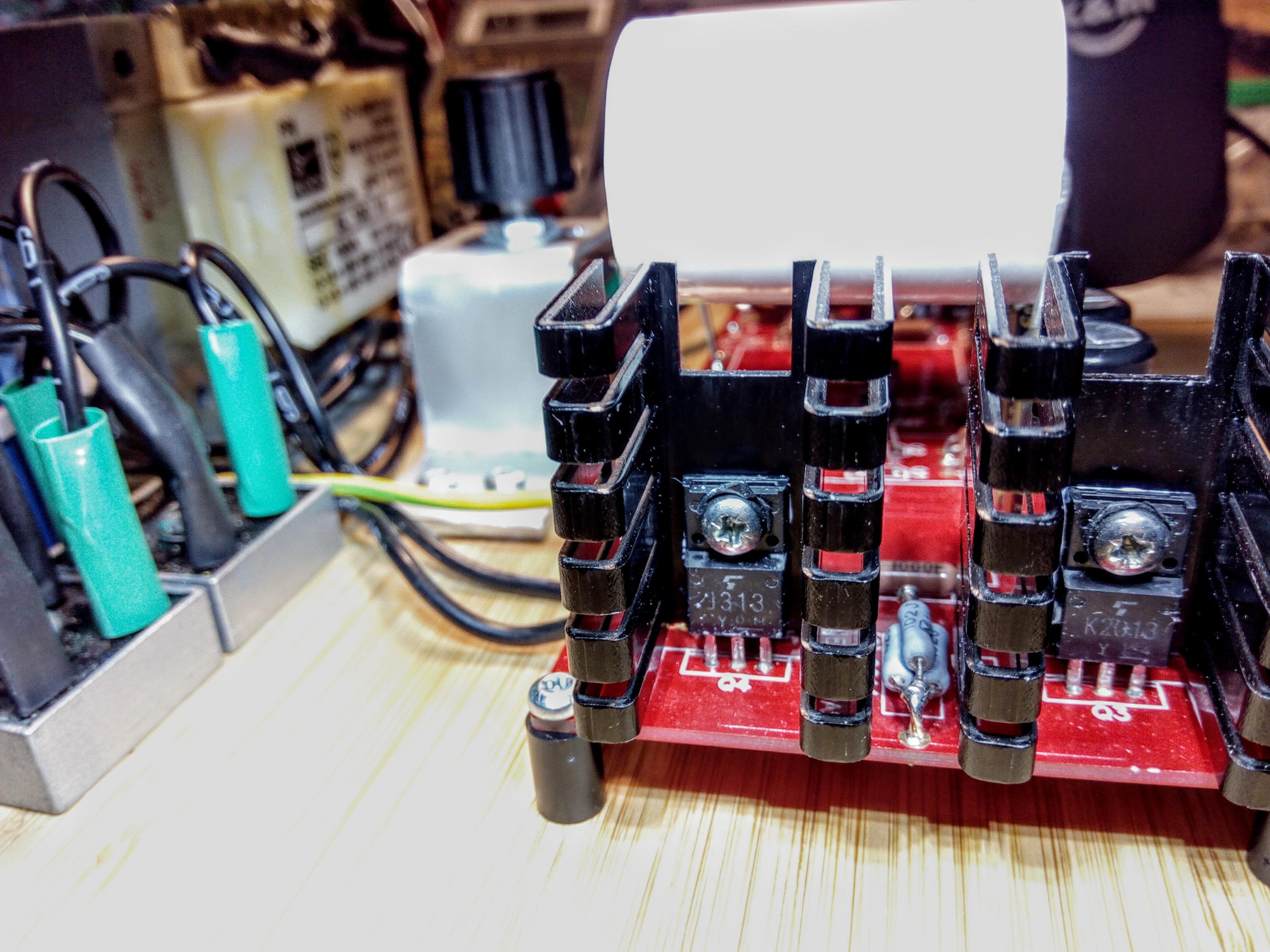

You guys see whats wrong? Q4 / Q3 the right way around?
Was no separate place to connect power ground - thought it's the same ground as signal - not so? Power giving +/- 26,7 DC withiut load.
That is the error - your Mosfet are in the incorrect locations. The J313 is P-channel and the K2013 is N-channel
That's OK.
Thanks 6L6! That's what I suspected... 🙁
I'll correct that - hope nothing else busted than the resistors...
