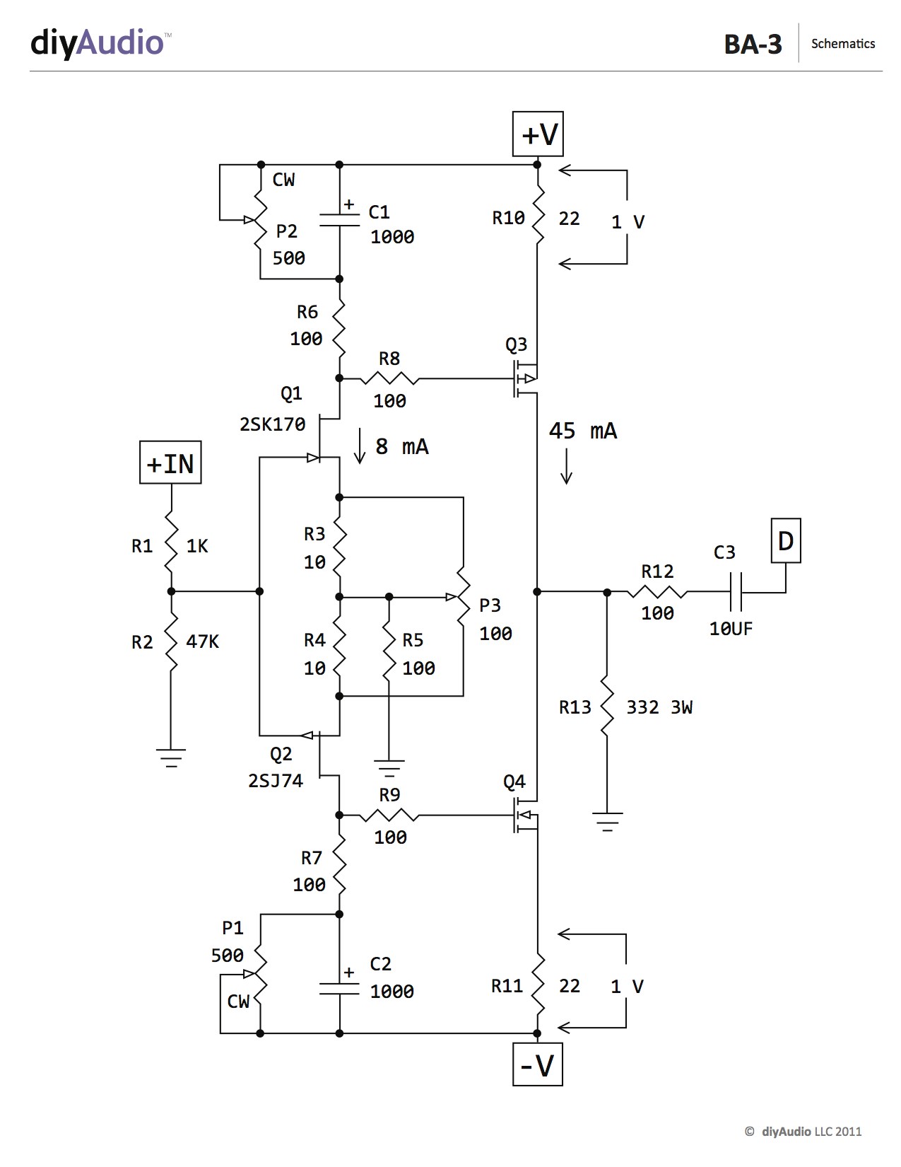

I'm about to start building a BA3 front stage to feed my Hyopex Ncore400 system and have some questions:
Regarding to FETS, which option between the following at my hand is better?:
1.- 2SK170/2SJ74 "V" grade NOT MATCHED + 2SJ313/2SK2013 NOT MACHED
2.- 2SK170/2SJ74 "V" grade MATCHED + FQP3P20/FQP3N30 to be mached (I can find cheap and would match)
3.- 2SK170/2SJ74 "V" grade MATCHED + 2SJ162/2SK1058 NOT MATCHED but same batch
And regarding to the regulated PS: I arrived late to SALAS SSLV and there's no stock for Glassware PS-19, so y chances are:
4.- High current low noise LT1083CP dual rail power supply assembled board ! | eBay
5.- HYPEX SMPS400/180 with +/-42VDC output stepped down to +/-24V. In this case, Which circuit would do with good quality?

V grade are between 10-20ma Idss, the low end of that range is useable, but as they get higher, the dissipation becomes a problem.
The Hypex would work fine, as would the LT1083 board you linked. I'd personally choose the linear supply.

Still not bought any fet, but seller says that V grade 2sk170/2sj74 are 0,1ma idss.
Any of the other options are matched.
Regarding to the PS, I will go for the LT1083 with a toroid 18-0-18V 30VA.
Will be enough??

The Glassware Item# LV-Regulator is in stock at the moment, and it is even quieter than the PS-19. You would need two of them, each set at 24V. You would connect the ground to the - output of one PS and also to the + output of the other PS to get + and - 24VDC rails. Do not use a center tap transformer but instead use a dual secondary transformer. I did this and it works great, but it does cost more and take up more space, but I tend to overkill.

Hello.
First of all, thanks to 6L6 for the preamp build guide.
I'm testing my BA3 front stage and I allways have 0 volts ACCROSS R12 as said in this guide, but I have some milivolts (20mV) if I take measures between the 2 legs of C3.
It happens in my board that any change at P1 or P2 pots makes no DC offset accross R12. I do have 0 volts always.
Is this ok?

Not across R12...between R12 and ground.
You need to measure between R12 and C3 and ground to get DC offset. Make sure you are not measuring after C3 (the 10uf cap nulls DC). An easy place to measure is the lead of C3 that faces the center of the board. Positive meter lead on that lead of C3, Negative meter lead to ground.
