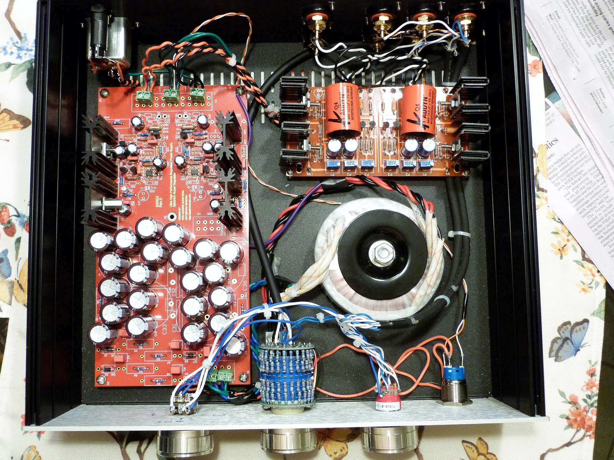

Hi All,
I finished my build of a B3 pre following 6L6's excellent build guide. I used Fairchild mosfets as per the BOM posted because I couldn't find the Toshiba's, and at first I couldn't get the thing to bias up. Then I read Nelsons B3 article and took his advise and changed out P1 & P2 to 1K pots. I used a long 3U galaxy chassis, and things are squeezed in pretty tight because of the size of the PSU. In any event it is singing now. Very quiet, and transparent swapping out my other SS preamp that I was using with my Aleph J was like removing a veil. Verrrry nice preamp. Thanks Nelson.

Wow! Looks great!!
What board are you using for the PSU? It looks really interesting but I don't recognize it...
Looks like the SSR03 super regulator: Sjöström Audio - SSR03 Sjöström Super Regulator Power Supply
Your right, that's the one. I picked up a few boards in a group buy a while ago and this was the first time I had the chance to use one.

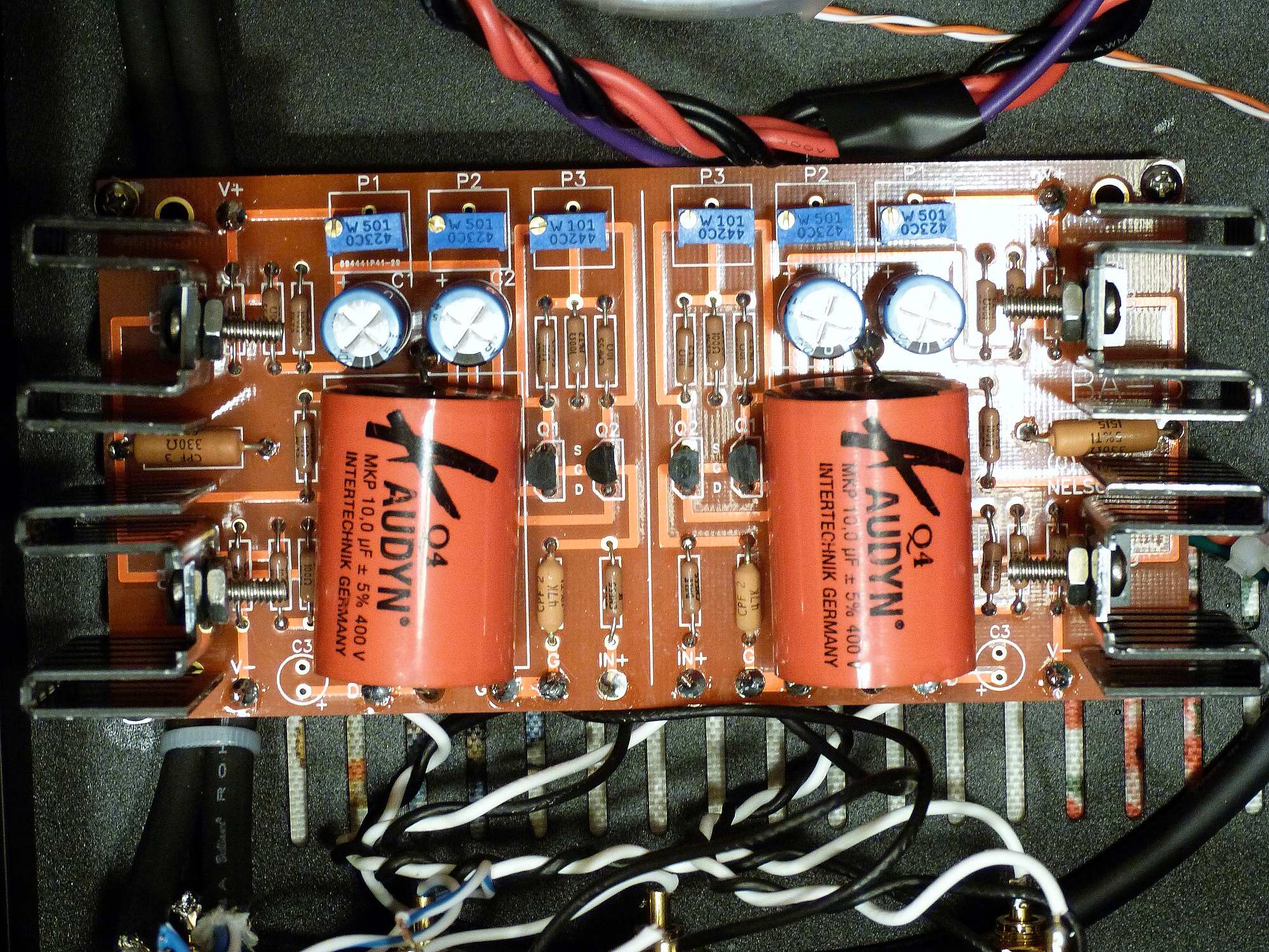

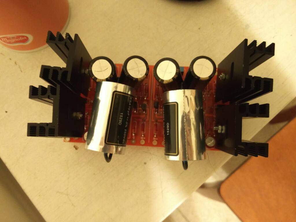

Bias is 50ma per channel. You need twice that in the shunt so 200ma for both channels.
I see you have an electrolytic and poly cap on the output. You only need the 10uf poly caps. The electrolytics will probably make the sound worse.
Also, you wont need that much heatsink but if you use them make sure they are insulated from the mosfet or make sure they don't touch each other of the chassis.
Looks nice though.
