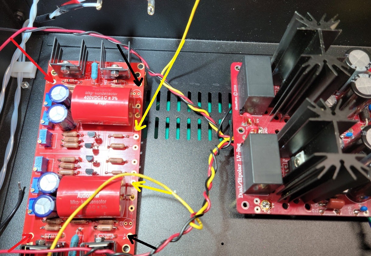

I'm missing something in how I've wired between the PSU and the amp card.

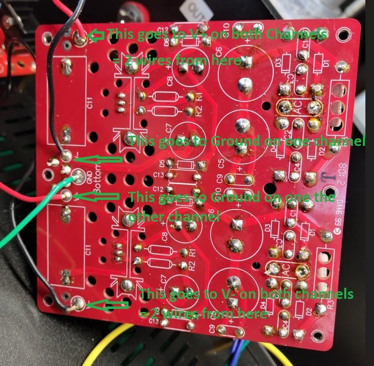

Yes you are still feeding -24 V and 0 V to one Channel and 0V and +24 V to the other Channel as before. See attached pic.

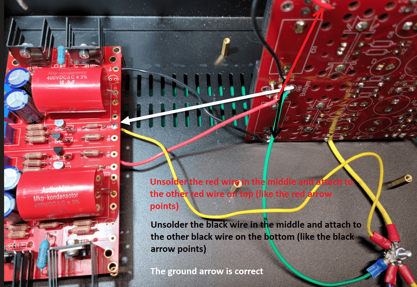

ozorfis has identified your problem. Please do the following:
0) Remove the PS wiring.
1) Adjust P1 and P2 of both channels of BA3 pcb back down, ideally to close to zero. This is so that when you fix the PS problem and power up, you don't have crazy amount of current.
2) Measure on the PS board: With COM probe on GND, verify that you have 0 on GND, +24V on V+ and -24V on V-
3) Wire up from PS to BA3 pcb for both channels: GND (PS) to GND (BA3), V+ (PS) to V+ (BA3), V-(PS) to V-(BA3)
4) Power up again. Hopefully the reset of P1 and P2 was done correctly and you're not getting a large current draw at the mosfets. Check that you have low (ideally zero) voltage across the 22 ohm source resistors R10 and R11.
5) Check power on BA3 PCB: COM probe on GND, verify that you have +24V on V+ and -24V on V-
If all this checks out, try the biasing procedure again.
If you are still using 500R pots for the board with Fairchild mosfets be prepared to have to change the pots to 1K to set the bias level correctly.

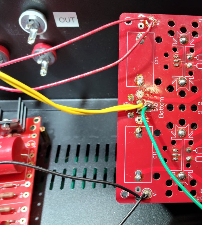

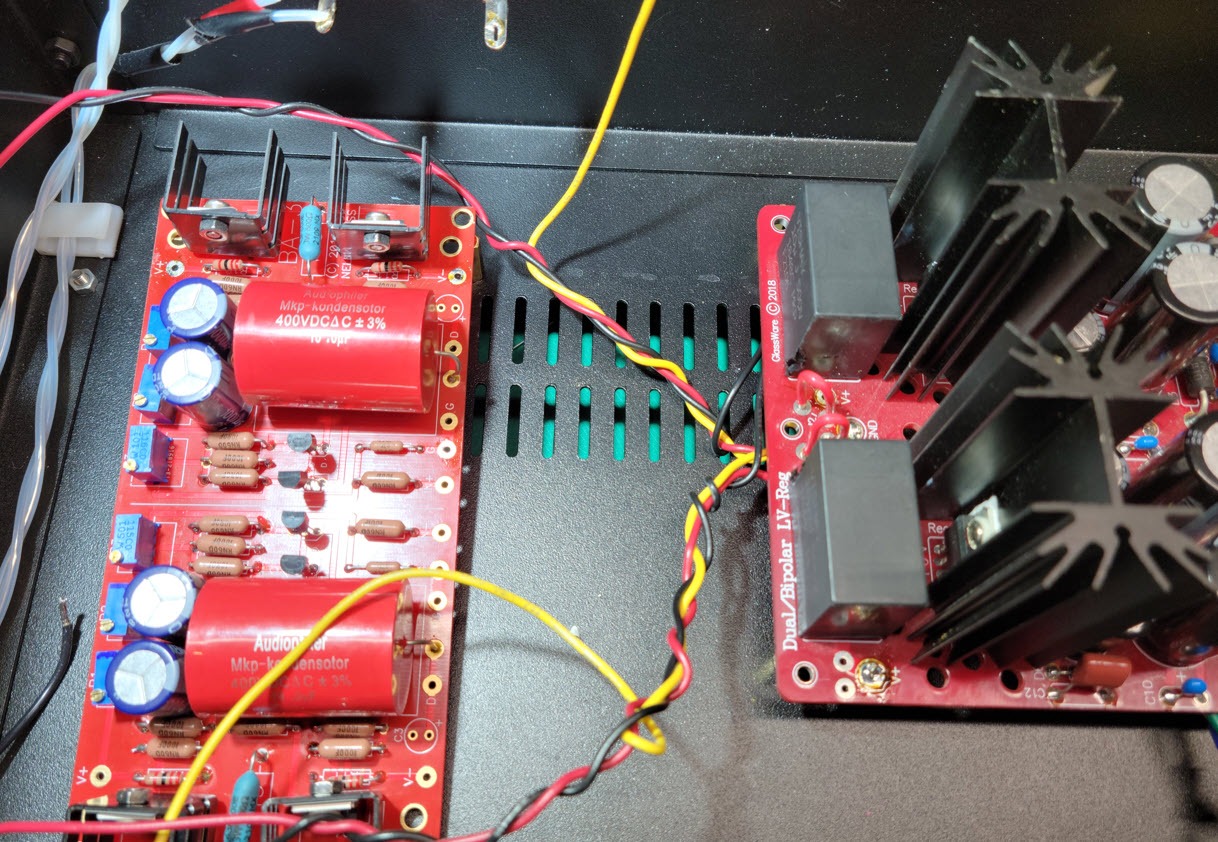

Ben, thanks for the guidance. Steps 0 thru 2 all checked and confirmed.
I realize I did not had a ground from the PSU to the BA3 pcb. I have grounds from both to my star ground point. See photo.
I will connect a ground wire from the PSU to the BA3 as noted by arrow, unless there is a better place?
This board uses the Fairchild mosfets and 1K pots.

Not me. It's Dennis' great advice.
And yes, the Ground wire goes to the G on the board. See cubicincher's post:https://www.diyaudio.com/community/threads/the-ba-3-as-preamp-build-guide.258022/post-6966501
I also suggest that from the PS board you have two groups of the V+ V- G wires. Twist each group of V+ V- G together and route that to the board. Twisting the wires together reduces loop area and allows for a quieter preamp, and it also makes it easier to see what wires are going where.

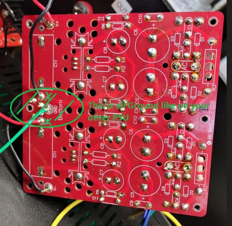

Chip,

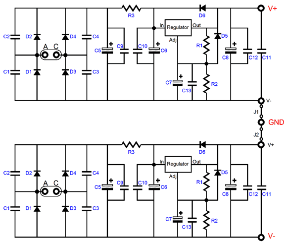

As ozorfis noted in the above post and in this post (https://www.diyaudio.com/community/threads/the-ba-3-as-preamp-build-guide.258022/post-6968588), all of the connection points at the middle of the PS board are Ground.
At one corner of the board is V+, which goes to the V+ at two locations on the BA-3 board and at the opposite corner of the PS board is V-, which goes to two locations on the BA-3 board.
Do not be confused or mislead by the markings on the centre of the PS board which show V+ Gnd V-. Those are all Ground.

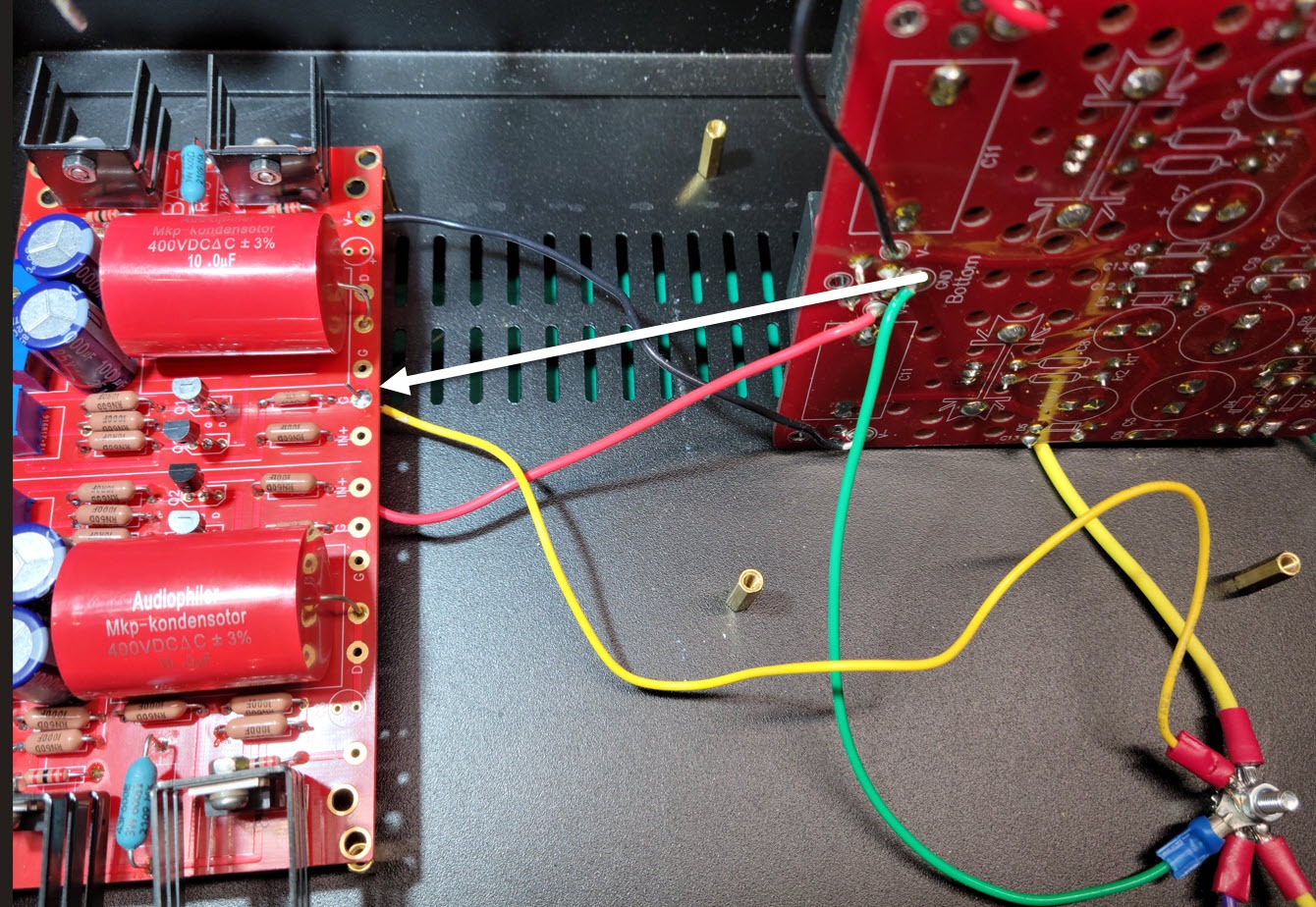

Last attempt: see pic attached
Thi
Chip,
Ozorfis is correct! As I said, I really think its the wiring scheme. Ben gave you the simplest explanation of the GND connections.
V- (bottom edges)is the neg. V supply, V+ (on the top edges) is the +V supply, G is the GND (connect to Ground of the supply), D is the signal ground (Inputs R and L negative).
Chiptech,
One last thing: Can you please confirm where that green wire at 'GND' goes? Does it go directly to a chassis connection, and if so, is that chassis connection then directly connected to IEC EARTH?
If this is the configuration and you find the preamp noisy then you'll probably need to provide some isolation to your audio circuit GND by adding, for example, a CL60 thermistor between the green wire and the chassis connection.
